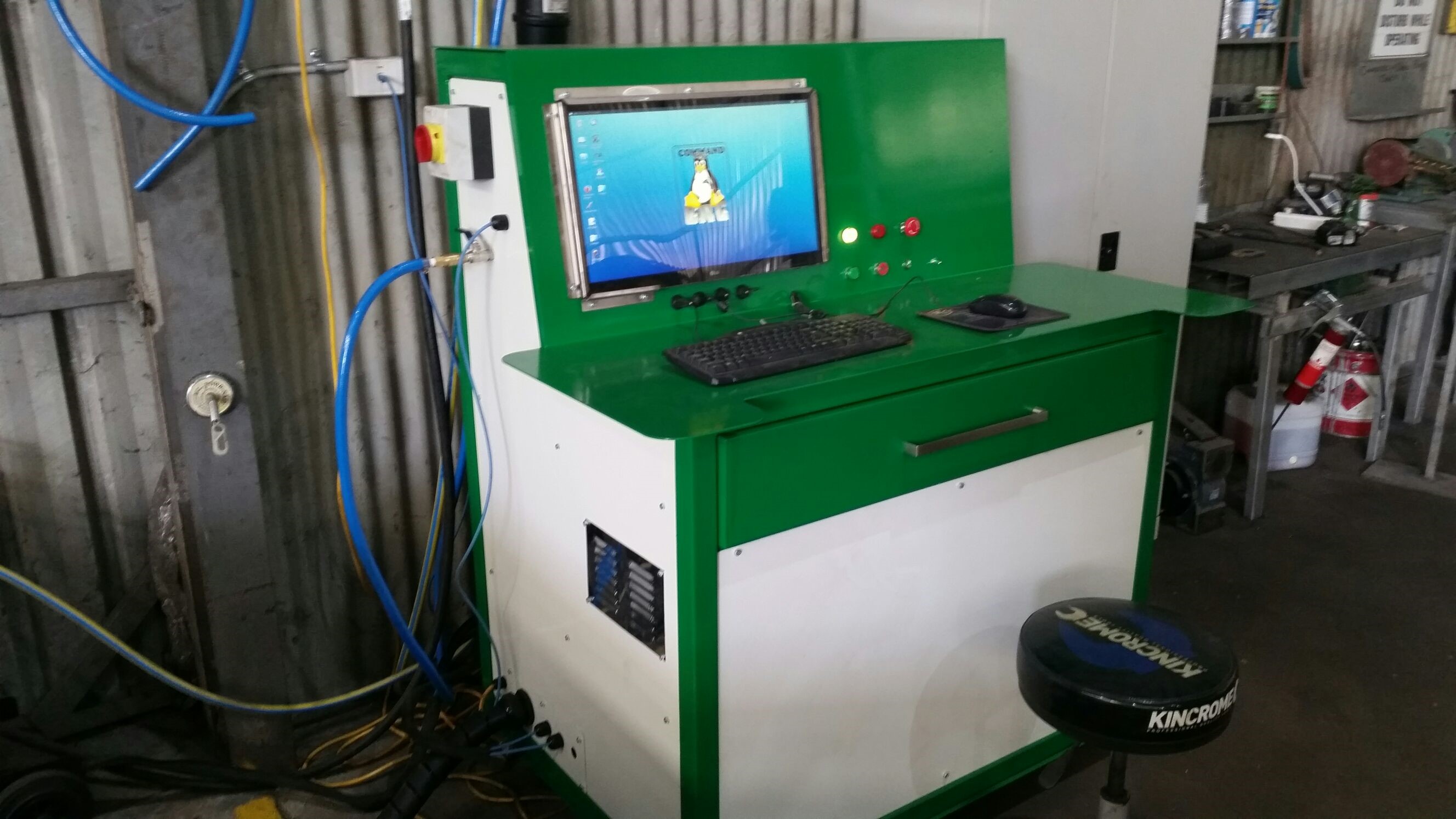

Thanks for the pics and diagram!
Do steps need to be taken to filter the air ventilated through the control box? Does metal dust collect in there? Anyone ever had a problem with the dust?
I have to ask because for the time being I don't intend to use a water or down draft table... Eventually we'll probably do down draft.

Replied by thefabricator03 on topic plasma control panel
I have covers on both of my control box fans, www.jaycar.com.au/120mm-plastic-fan-guard-filter-kit/p/YX2554
Not much dirt gets inside the control box but my control box sits inside a filtered control cabinet.

I wonder, why is there a water/air hose going to the control cabinet ?

Air Scribe input air, the solenoids are mounted inside.

I thought it was water to clean the panel out.

I've got a quick control panel question. Maybe this belongs in a new, separate thread? ... I just splurged and picked up a big ol' metal nema box to mount my electronics in. It just came in and I poked around with the multimeter. I noticed that the galvanized tray, or mounting plate, does not have continuity with the rest of the metal box. From the factory there is a thin rubber washer and coat of paint that separates the plate's hardware from the box. I would have assumed that I need to ground the metal mounting plate along with the rest of the box. Thoughts?
