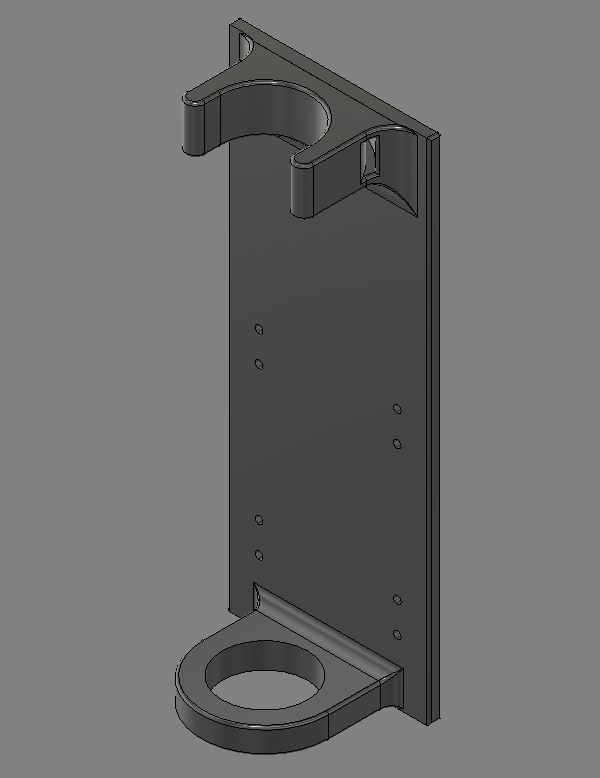

- bbsr_5a
- Posts: 544
- Thank you received: 106

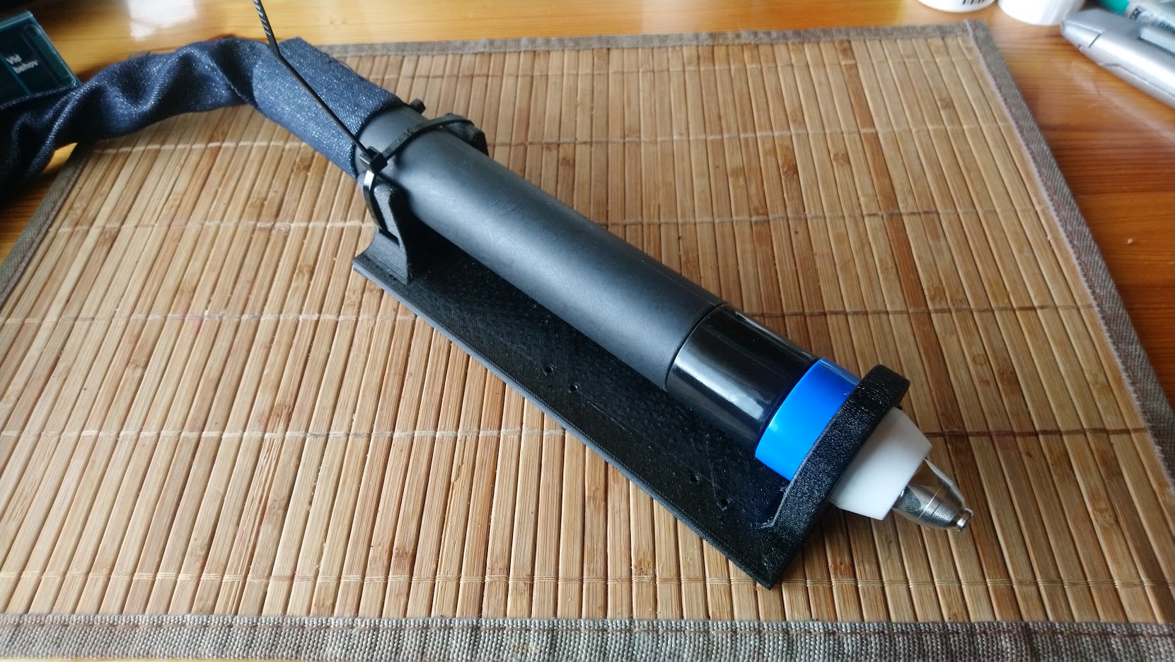

29 May 2020 07:17 #169284
by bbsr_5a
Replied by bbsr_5a on topic Low budget plasma setup, what do I need?
this is quite a very hard build on dusty Plasma
the Clamp(i hope i get it right it is the clamp)to torch inside a fixed is by far not good
it will head up the system
and as we use 5Plasmas in shop i can tell you as more material is around the torch it will produces EMI to the complete system over long distance
keep the torch off by at least 10cm to the machine frame

30 May 2020 08:30 #169393
by Clive S
Replied by Clive S on topic Low budget plasma setup, what do I need?
I think you might find that you will have to move the torch down in the holder as it will get quite warm at the business end
