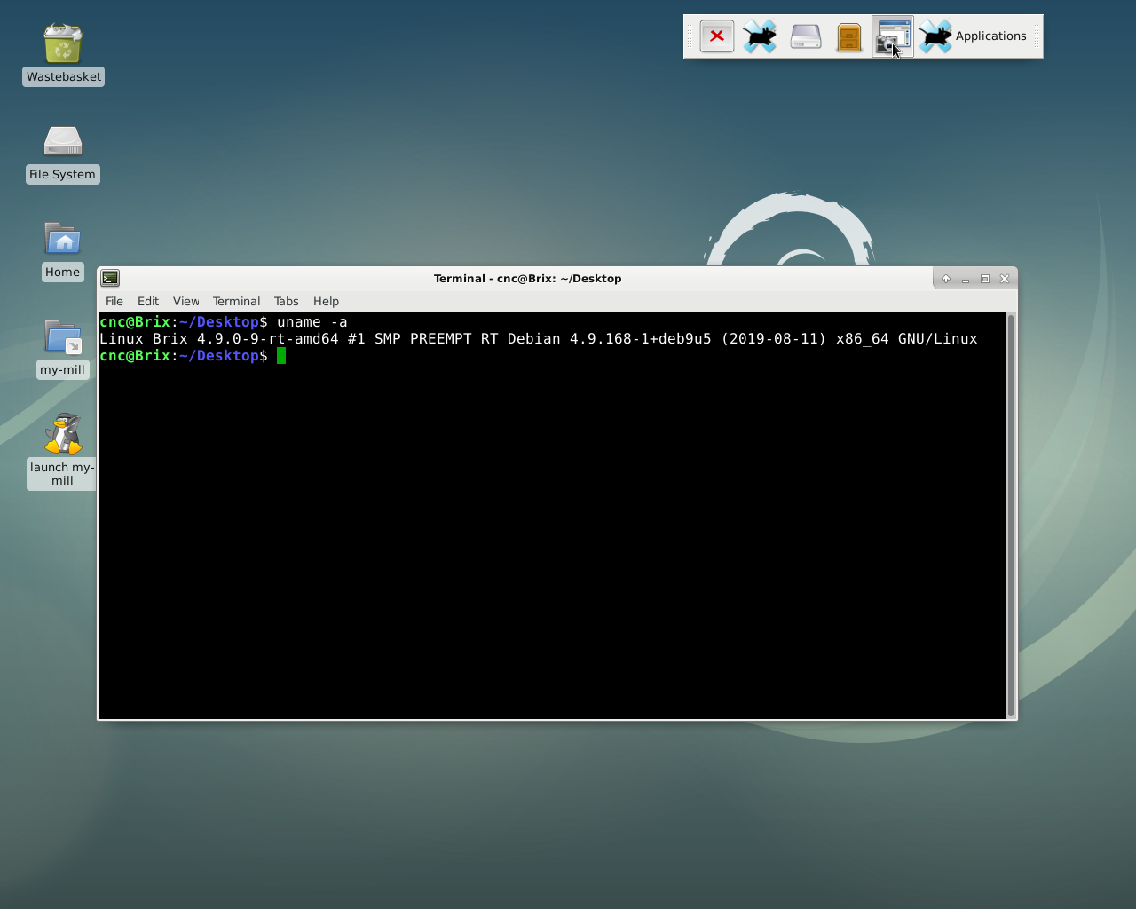

by Clive S
Replied by Clive S on topic New Plasma build question
- Posts: 12161
- Thank you received: 4151
18 Aug 2019 00:24 #142412
Replied by rodw on topic New Plasma build question
That should be fine
