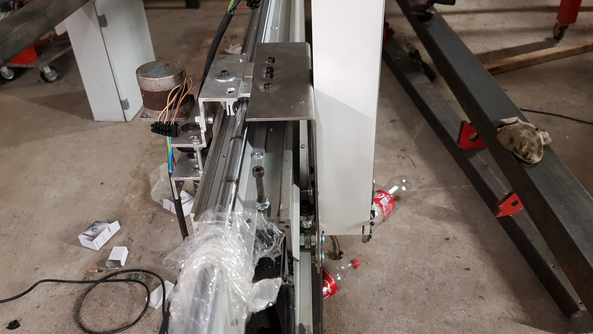

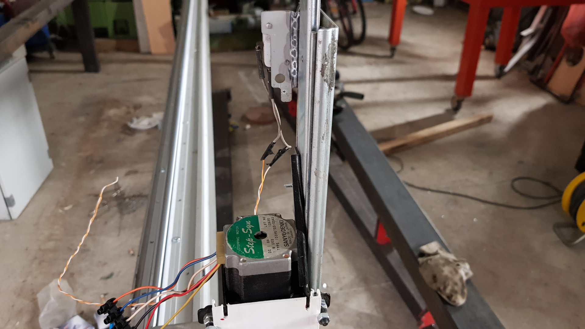

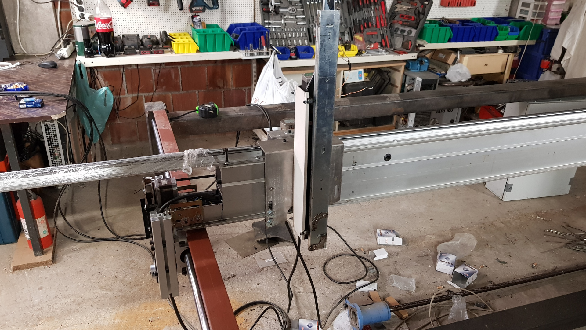

30 Oct 2019 18:13 #149236
Replied by tommylight on topic 3.5X1.5 Meters cnc plasma cutter
Z axis is mounted with floating switch and fully enclosed, Y axis has some more work to be done like cutting the rail, adding another one, etc. Reduction is finished and working with a temporary motor attached, can not find the wide belt i have somewhere hidden.....
Z axis can do 12 m/m easily !
Computer and electronics are done waiting for a box to put them in.
Now to dismantle everything and send it to paint, then mount everything back, add side and front panels to make it look nice. All in all, it's looking much better than i initially thought, mainly due to me thinking a lot before screwing something to it and later regretting it, thinking about how it will look at the end and how the panels will be mounted, avoiding getting in my own way with parts and later finding out it interferes with something else, etc, etc
Here are some more details:
Regards,
Tom.
