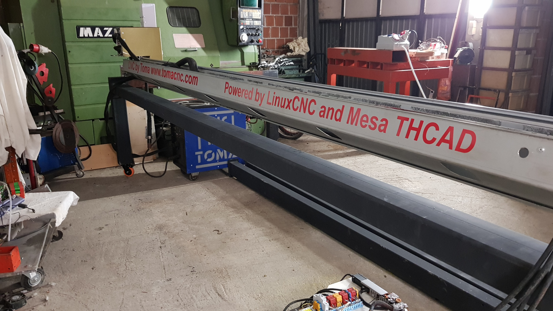

Replied by tommylight on topic 3.5X1.5 Meters cnc plasma cutter

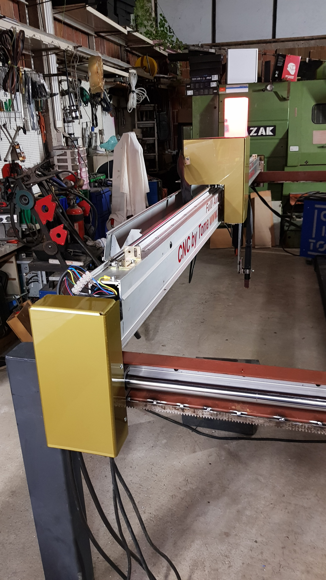

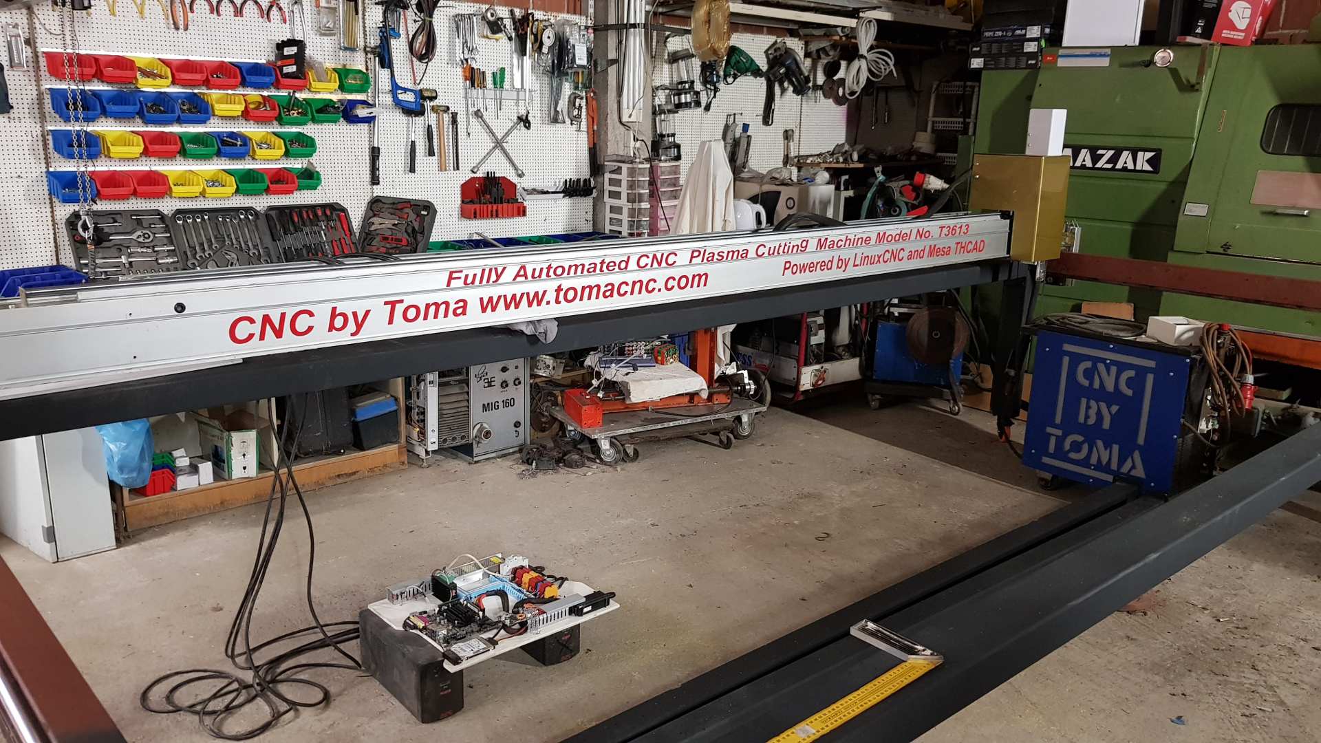

Some progress:
Painted mat dark grey ( not my choice, but better than nothing)
Lettering on the gantry, both sides (despite me sending them an SVG with correct dimensions, they managed to mess up the dimensions! )
Pictures:
Front
Back

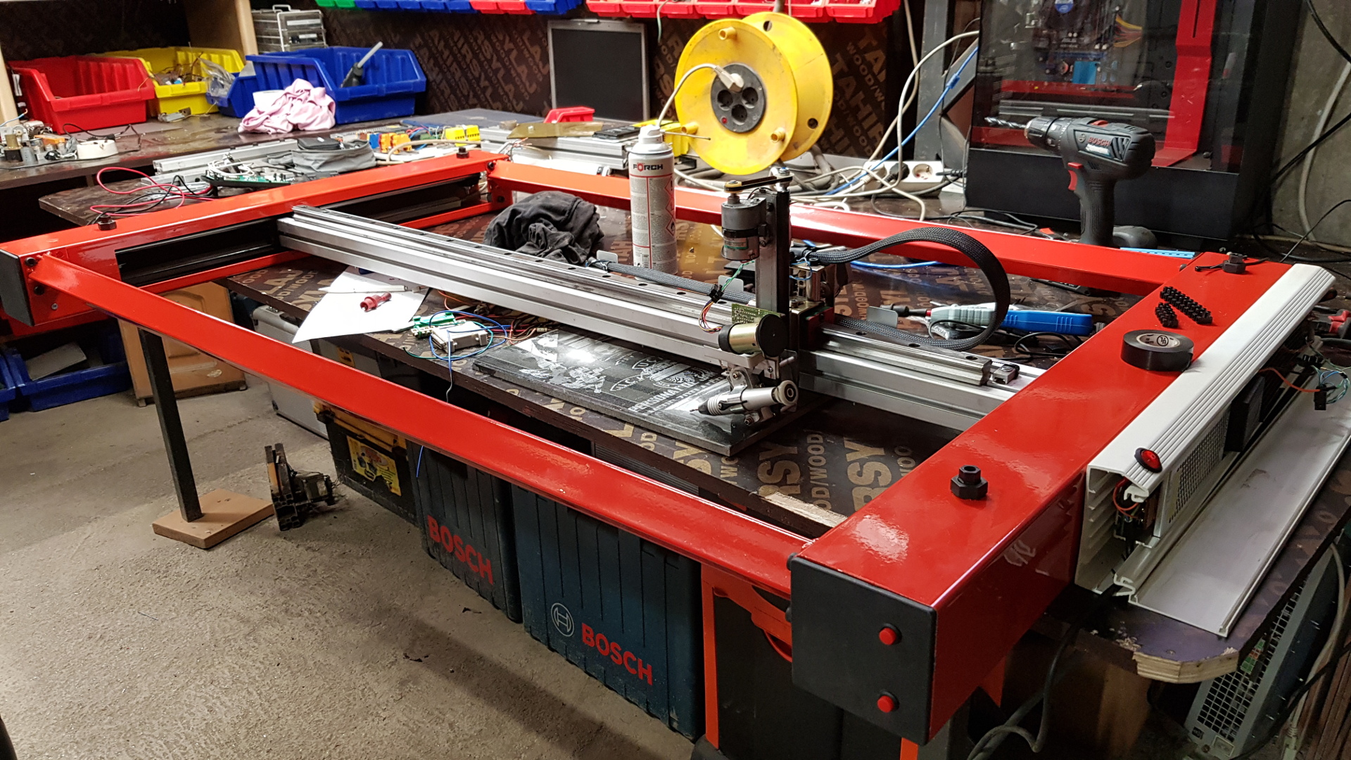

Been busy working on the small machine as i had to change it's designation from a plasma to an engraver, so i though it would be nice to add height adjustment and then also thought of making it motorised, so i keep complicating everything. Will upload pictures of that machine later.

08 Nov 2019 21:36 - 08 Nov 2019 21:39 #149941
by thefabricator03
Replied by thefabricator03 on topic 3.5X1.5 Meters cnc plasma cutter
As always Tom, looking good.
The sign writing has come up well.
Did you use a single pack paint or a two pack? Enamel or acrylic?
Last edit: 08 Nov 2019 21:39 by thefabricator03.

08 Nov 2019 21:56 #149942
Lettering is adhesive foil, machine is some new type used here lately, i have no clue what or how as is stains a lot, like you can see fingerprints from 3 meters far !
Most of it is going to be covered by panels so eager to see how it looks at the end.
Thank you.
P.S.
Busy with this:
Not really, the lower part, right side the lettering is smaller than the left side, they should have been the same, that is why there is a void between them now.The sign writing has come up well.
Lettering or machine?Did you use a single pack paint or a two pack? Enamel or acrylic?
Thank you.
P.S.
Busy with this:

09 Nov 2019 08:28 #149969
by machinedude
Replied by machinedude on topic 3.5X1.5 Meters cnc plasma cutter
looks pretty nice on both machines. paint is typical soft for a while even after it is dry. it takes a while to fully cure.
i can't even paint this time of year because it's to cold without heat. once you hit 65 degrees that's about the bottom limit for painting anything, metal temp is about 15 degrees below what it is outside so that complicates finishes as well.
i'm curious about the industrial enamel i'm going to be using once i get that far.hopefully it is something durable enough? I've never used the industrial grade before so hopefully it's not much different than the automotive type.
what ever type you have it looks good in a picture, hopefully it was used with some type of hardener? if you notice fingerprints getting in it that's soft paint which is normal for a while but if it still is something you notice after about 3 or 4 weeks then the paint could just be that soft in general and that would be something i would expect with no hardener in the paint system.
looks good regardless.

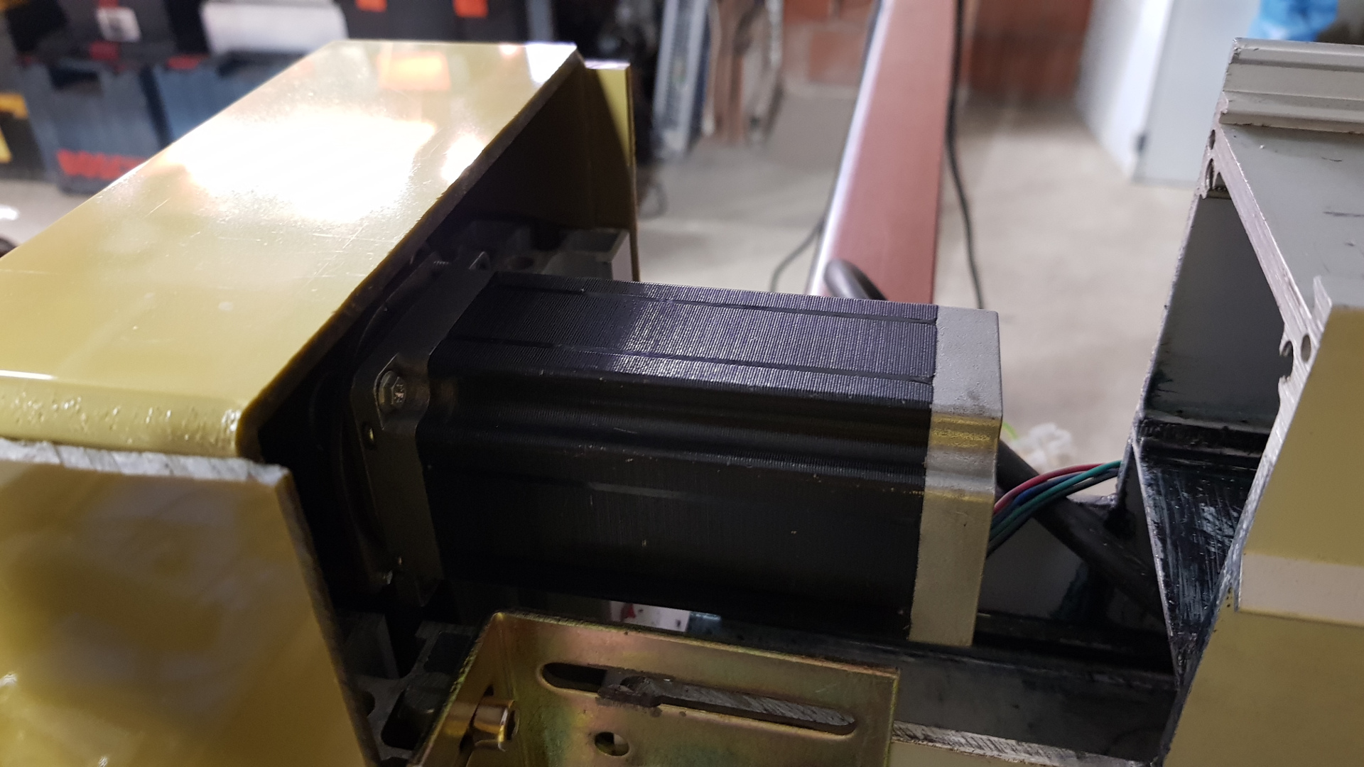

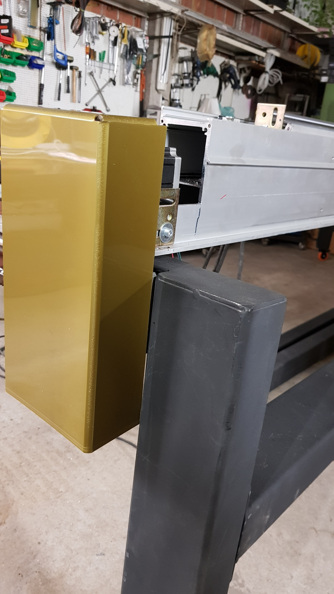

Some more work done while i am waiting for the cable management or energy chain to arrive and the side and front plate to be cut on a cnc. Now, if anyone has an idea what should be written on those sides and front, feel free to chime in. Had a bit of plastic left from the cover of Z axis so i made these covers for the sides:
Also notice the motors are changed, now 3MN Nema 23 at 110mm of length.
Regards,
Tom.

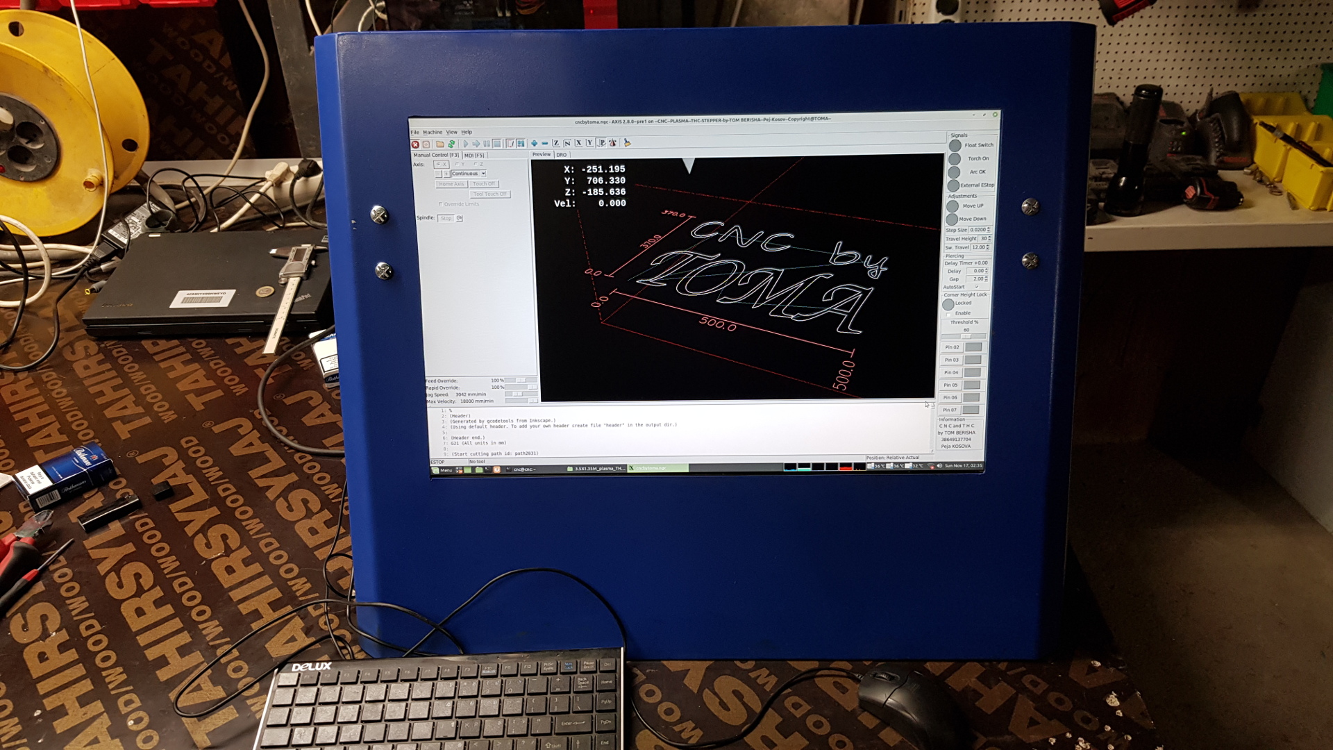

This is the console for the machine, sans the bottom part and a swivelling arm, hopefully tomorrow.
