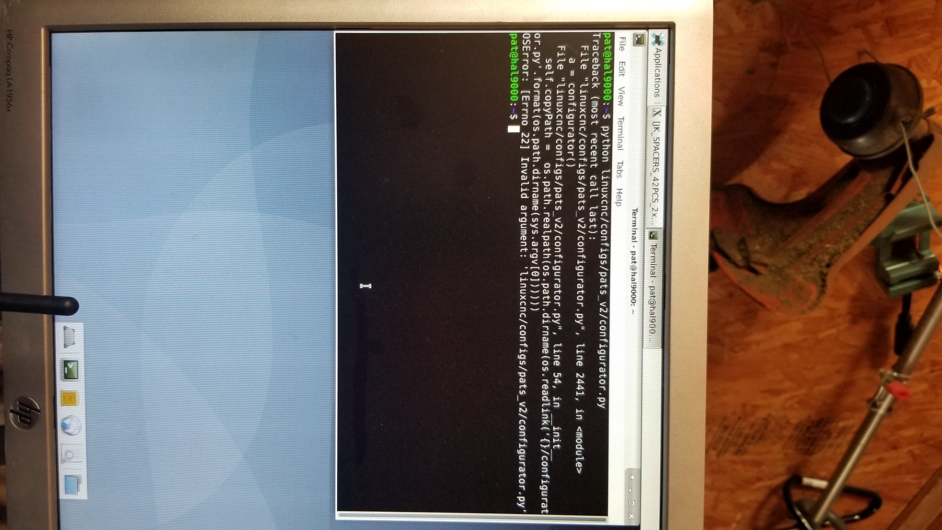

- dvn4life1972
- Posts: 401
- Thank you received: 173
17 Mar 2021 17:28 #202661
by dvn4life1972
I didn't run the configurator. I tried, but I get the error in the attachment (python linuxcnc/configs/pats_v2/configurator.py)
Replied by dvn4life1972 on topic Filter Failed error after changing computer
In the ini file RS274NGC section there should be a line like:
USER_M_PATH = ./:./plasmac:../../mfiles
In the config directory there should be a link to a plasmac directory which should contain a M190 file . It should be executable.
If you used the configurator this should have been done automatically.

17 Mar 2021 17:33 #202665
by dvn4life1972
Attaching the configurator file now that I'm on the internet again on that pc.
