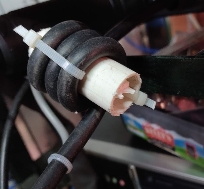

BURISCH Air Compressor BT350V 50L 3HP V-Twin 14.1CFM £210 and I coupled it to another 50Ltr tank I had I also run the air through a condenser made out of copper tube which works quite well. You can see the pic in the album. I also run the air through a dryer with descant crystals those that change from blue to pink. photos.app.goo.gl/TK4FBCUkVmRGX46Q7
I only do this as a hobby and on a small table it provides plenty of air.
Ah the spanner that is in PlasmaC so every body seems to cut one :) as a first test.
The Plasma came from here www.thewelderswarehouse.com/Welding-Supp...lasma-40.html#SID=12 I asked them for a machine torch instead of the hand one they suggested an 80A torch which they wired to fit the machine in total I paid around £700 with the torch. The company was good to talk to with no pressure.
The THC is fitted on the side of the machine in a metal box with two 1meg resistors one each leg. (you can see them in the pics)
The reed switch was a suggestion by Tom as I was having trouble with the arc OK signal and that cured it. In hindsight I might see if I can cure it now I know a bit more. I have a feeling the the torch-on-delay was much too long.
