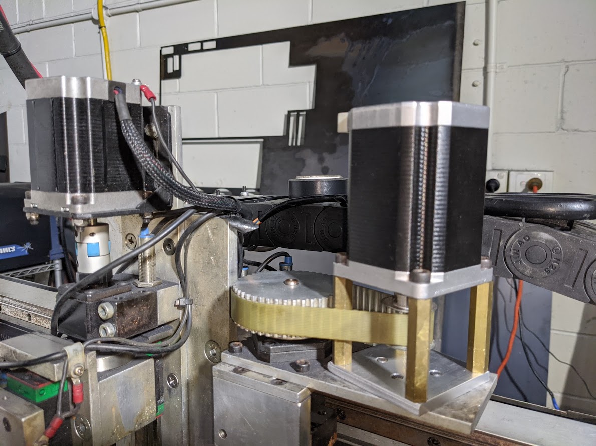

Chris, I think I'd go with B. I don't think it would be too hard to mount the stepper on legs like I like to use. If the mounting plate went right round the motor, you should be able to mount the legs on the motor side instead of the pulley side. How easy would that be to service?

For simplicity, bolting the motor direct to the carriage plate and running the belt below the linear rail (image A below) would be easier, but can't help but think having the belt directly below the table tube seems a better bet (image B below). B would need an extra plate and mount though obvisously to move the motor inboard...
Thoughts? Or am I just being pedantic...?

Steppers on legs is popular and effective. And I hate it
If I was building a plasma it would almost certainly be a Core-XY setup.

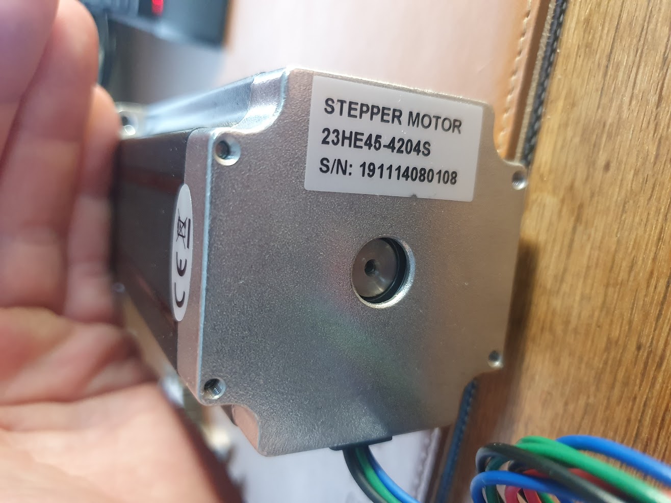

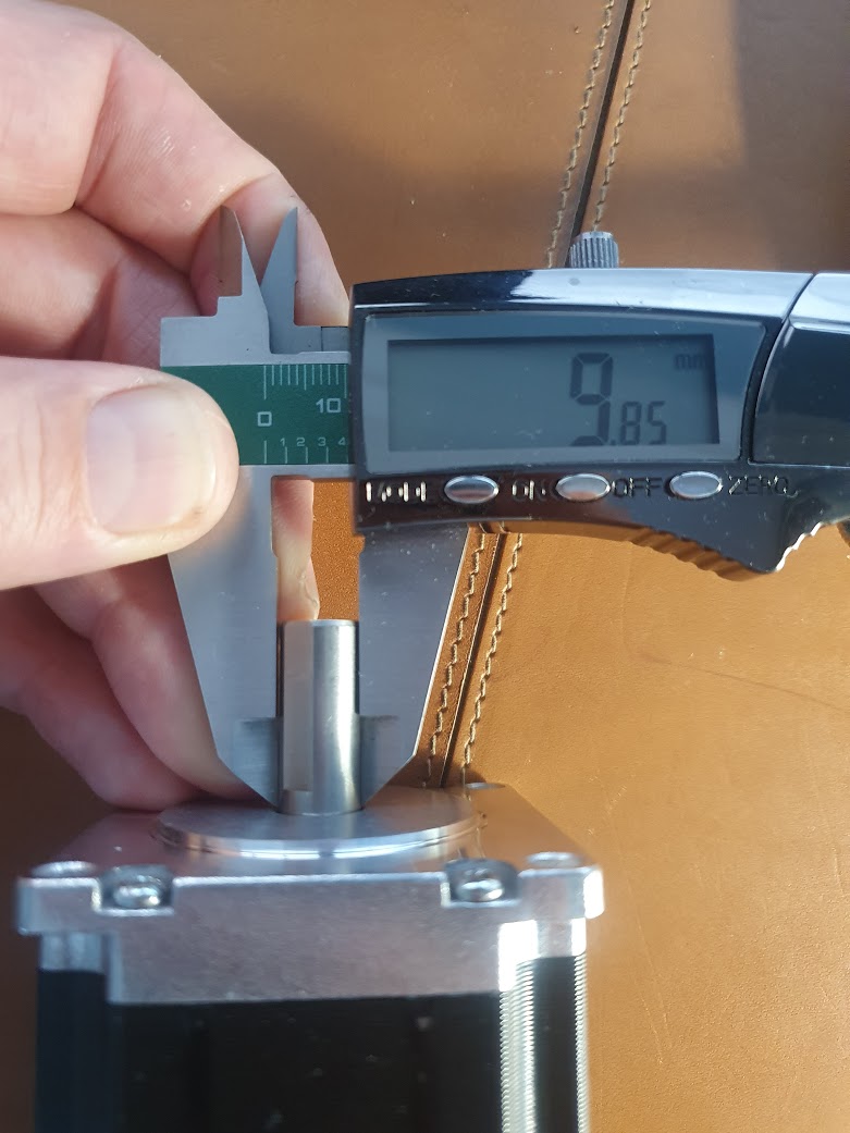

I've got four 425 ozin NEMA 23 with 10mm output shaft.

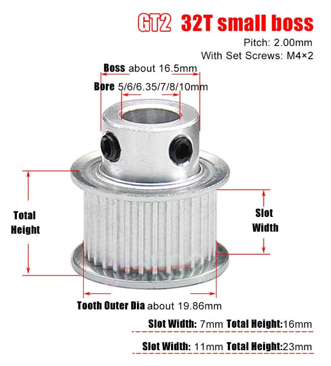

How do people calculate what gearing is best suited to a small plasma table? Tommy's plasma primer suggests 16 to 20T on the drive pulley, but I can't seem to find any 10mm bore pulleys with such few teeth.

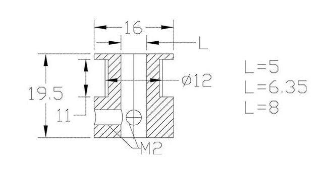

Well, if you want GT2 and 16T then that's a diameter of 16 x 2 / pi = 10.18 mm, so there would be nothing left of the pulley if you bored a 10mm hole.
I have a feeling that GT2 is a US (but metric) belt standard. It doesn't seem to be stocked by the usual suspects (RS, HPC Gears, Bearing Boys) . It is 3D printer-scale belt, I would be expecting to see at least T5 x 15 used on a plasma cutter.

That brings us to the question: where did you find Nema23 motors with 10mm shaft ? I have 6, 6.35, 8, some 5mm and even some 7mm shaft ones, but never 10 !

Stepper motors are from StepperOnline...
www.omc-stepperonline.com/nema-23-steppe...epper-motor-cnc.html
Didn't think enough about drive pulleys with 10mm bore and low tooth count when I bought them. They do seem nicely made though.

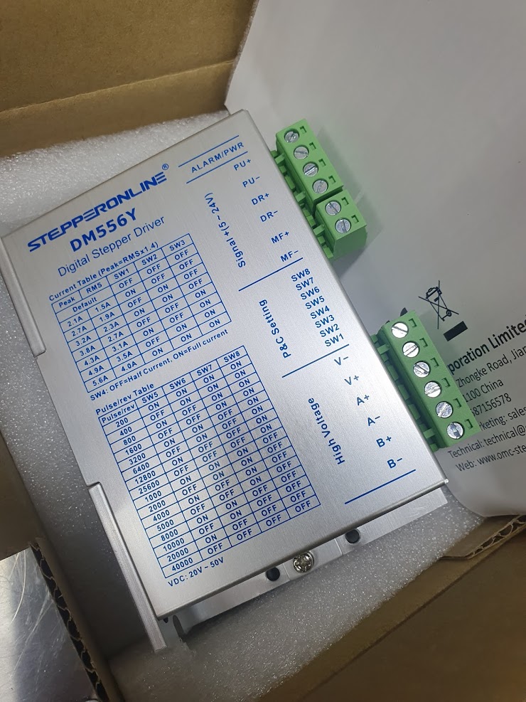

A 20T GT2 OD is 12mm, so one revolution would be 37.7mm per single revolution. Far from your 10 to 20mm suggestion Tommy.
What is a maximum distance per rotation that is still usable? Driver is a DM556Y shown below.
C.
