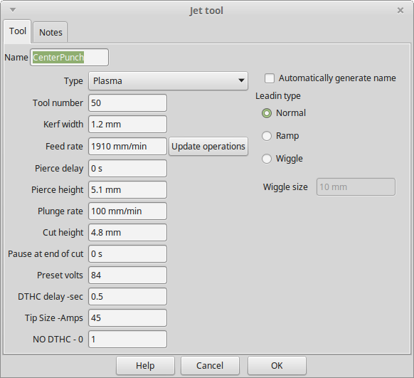

11 Jul 2019 10:22 #139098 by fupeama
Replied by fupeama on topic Post Processor for LinuxCNC and PlasmaC
Also, create a tool called "CENTERPUNCH". Then if you have holes you just want to mark hole centres for subsequent drilling, you can create a new layer in sheetcam and move your holes to that layer. Then do a drill operation with the centerpunch tool on that layer and it will spot them for you. It is pretty cool watching plasmac swap the tools and updating the GUI on auto pilot!
Hi Rod,
what does it mean mark hole in this case?
Hole through all material or only mark on surface?
I need only little mark on surface for next drill operation.

11 Jul 2019 11:02 #139099 by rodw
Replied by rodw on topic Post Processor for LinuxCNC and PlasmaC
This is where my current post processor is. I've included screen dumps of all of my main Sheetcam code Snippets and my setup for the centrepunch. Keep the name exactly as shown. To tell you the truth, I can't quite remember how the centerpunch works. I think becasue I have a pierce delay of 0.0 seconds, it will stop as soon as it sees an ArcOK. (That assumes you import the sheetcam tools to plasmac)
File Attachment:
File Name: SpaceShipP...7-11.txt
File Size:23 KB
