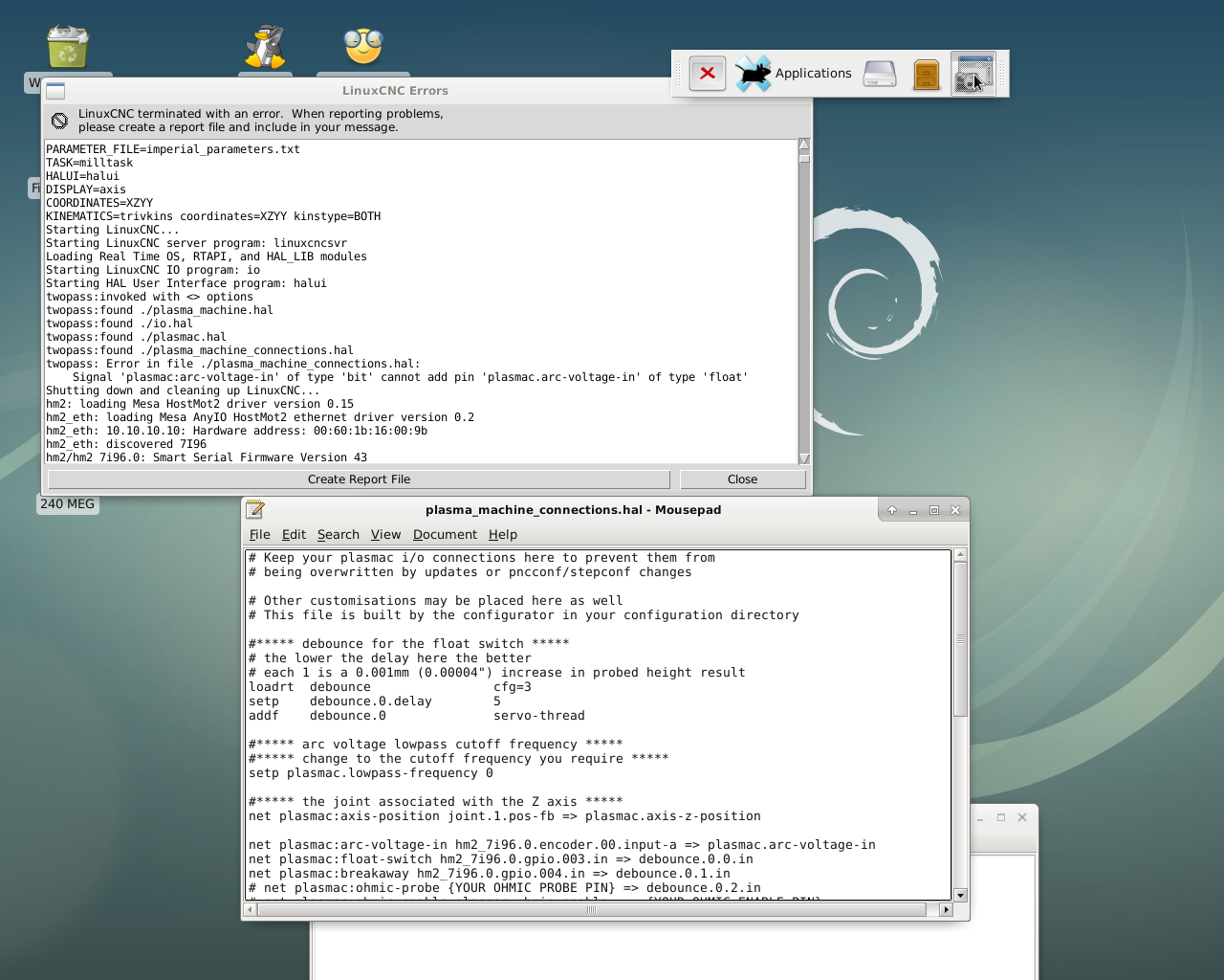

I am have a bit of trouble loading linuxcnc.
If I comment the line out in connections.hal net plasmac:arc-voltage-in hm2_7i96.encoder.00.input-a => plasmac.arc-voltage-in
It will load and I can home the machine.
Am I using the correct pin ? I will try this in the morning hm2_7i96.0.encoder.00.velocity
Last edit: 04 Oct 2019 21:39 by Clive S. Reason: added text
04 Oct 2019 22:49 #147146 by phillc54
Replied by phillc54 on topic Problem loading PlasmaC for the first time
yes, velocity is the one you need.

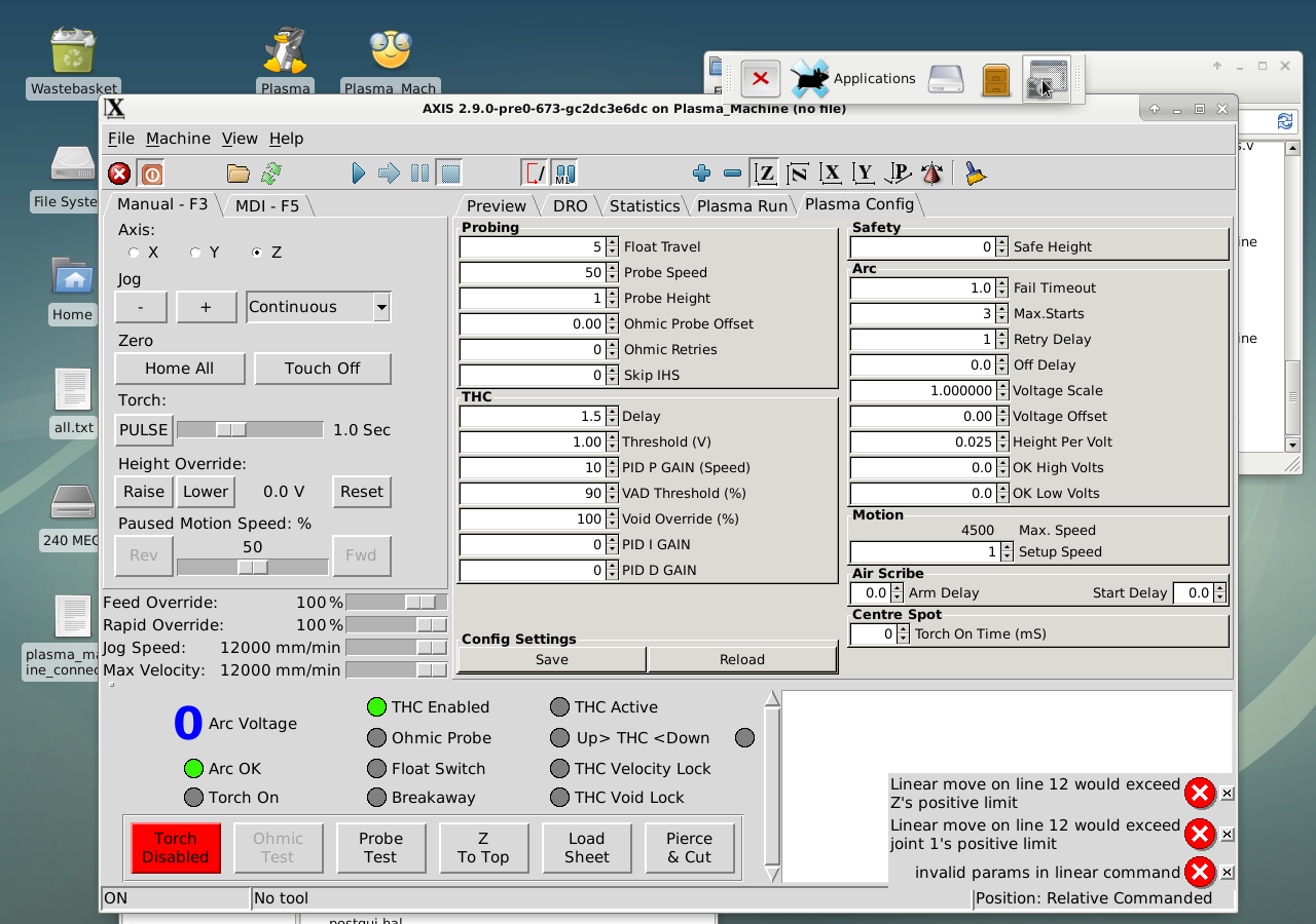

Thanks Phill . That did the trick, now with the machine idle I see a very small fluctuation in the arc voltage close to zero (not calibrated yet so would expect this)
Q1. re the breakaway switch: With the torch in position the monitor shows RED (should the switch be NC or NO with the torch in position?)
Q2. Should the probe test button start the probing. I have not been able to get it to start the probe.
Thanks.
You need the machine homed for a probe test.

Yes I had the machine homed but did not get any response from the "probe test"

Check in the .ini file that the button code for the appropriate button is something like:
probe-test 10
Or post your .ini file.

Breakaway switch sorted by inverting the pin by adding "_not" to it.
Probe test problem. I change the speed from 1 to 50 in the plasma config panel abd checked ini file for probe-test 10
Also on pressing "Z to top" button it errors "see screen shot"
I notice that the "Ohmic test button" randomly flashes in time with the arc voltage notification.

Try changing the -0.0401 in the BUTTON_3_CODE line to -1.0 for the Z limit problem.
I see you are not using ohmic probing so you could reprogram that button to something else.
I am not sure what the random flashes would be.
Edit: Probing at 1mm per minute is very slow.
Yes I only have a scratch start
Probe test problem. I changed the speed from 1 to 50 in the plasma config panel and checked ini file for probe-test 10
To be clear probe is not working yet
The Z limit problem is only there when pressing Z to top button
Thanks for the help.
05 Oct 2019 11:51 #147188 by phillc54
So, when you press Probe Test nothing happens?
