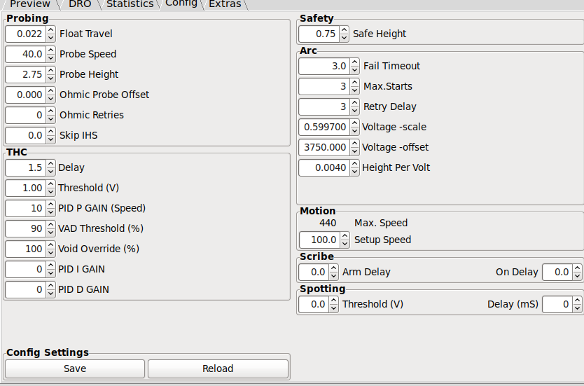

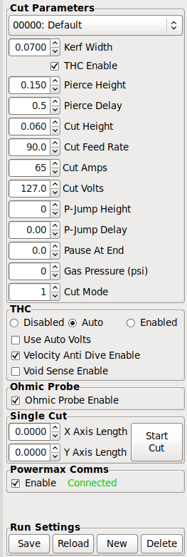

29 Apr 2020 23:25 #166167
by snowgoer540
Replied by snowgoer540 on topic Error after Update
I lied ha! Figured I'd just grab them quick. attached are settings and the line gcode file from the conversational extras.
- snowgoer540
- Posts: 2582
- Thank you received: 907
29 Apr 2020 23:25 #166168
by snowgoer540
conversational from a few minutes ago.
Is that current conversational code or saved from a short time back?

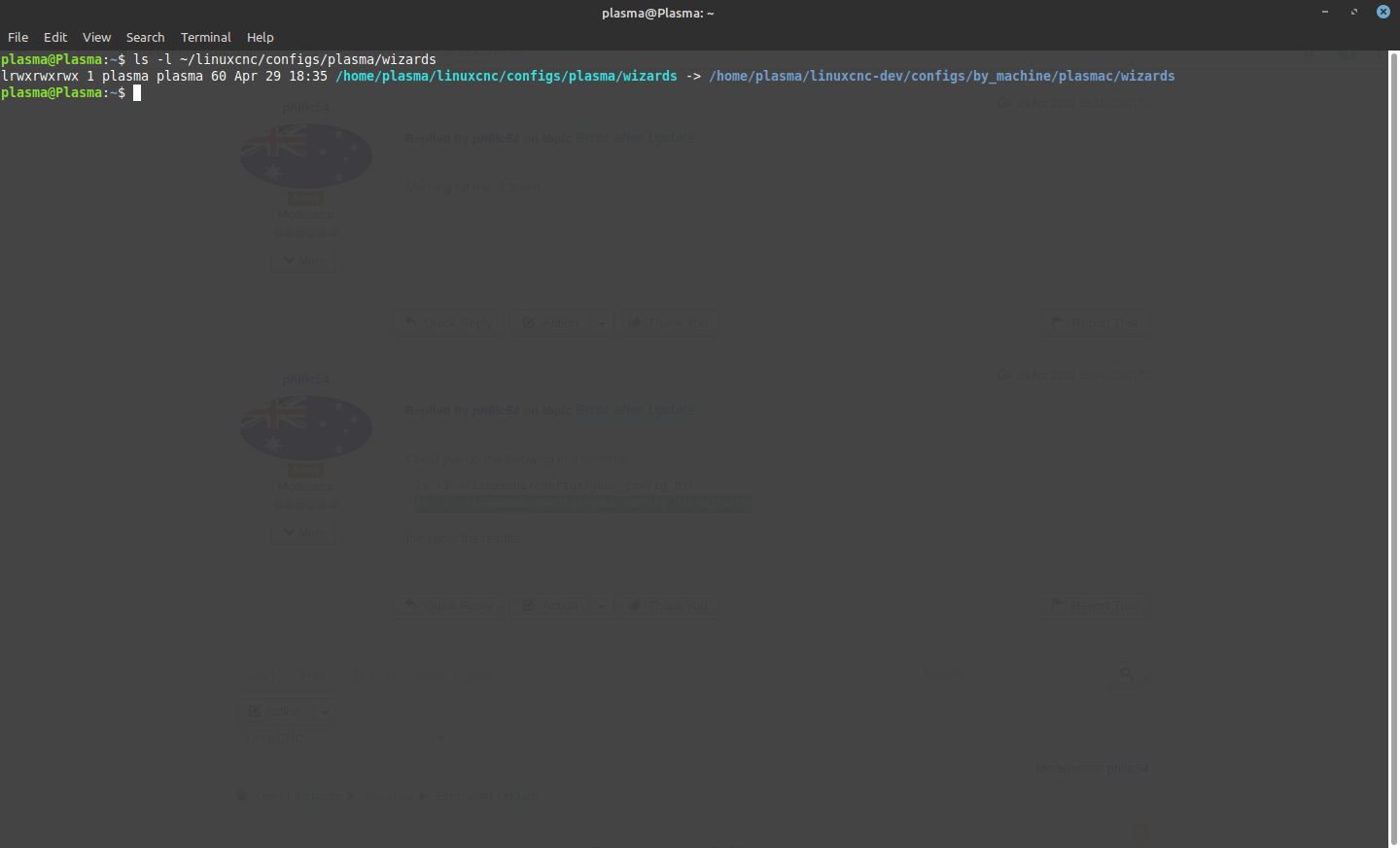

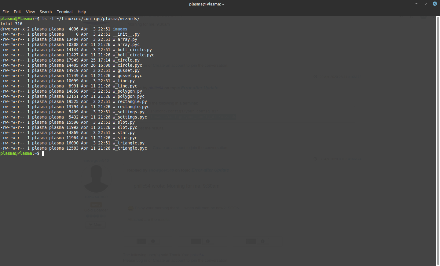

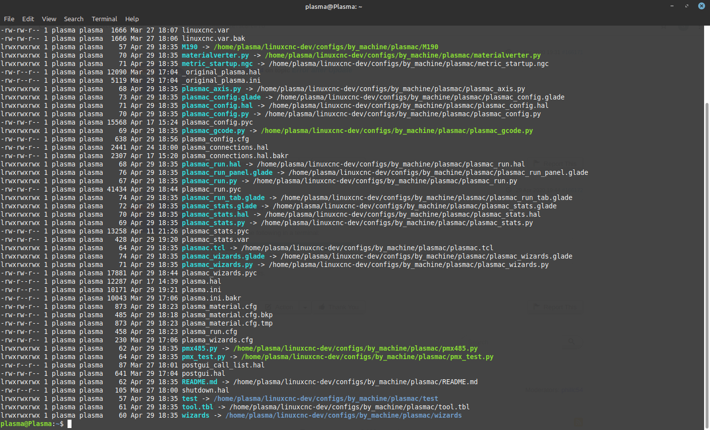

Could you do the following in a terminal:then post the results.
ls -l ~/linuxcnc/configs/your_config_dir
ls -l ~/linuxcnc/configs/your_config_dir/wizardsPlease Log in or Create an account to join the conversation.

- phillc54
- Posts: 5711
- Thank you received: 2100
30 Apr 2020 00:06 #166175
by phillc54
Replied by phillc54 on topic Error after Update
Oops, the wizards should have had a / at he end
- snowgoer540
- Posts: 2582
30 Apr 2020 00:18 #166177
by snowgoer540
at least no one can say i dont follow directions well...
attached
