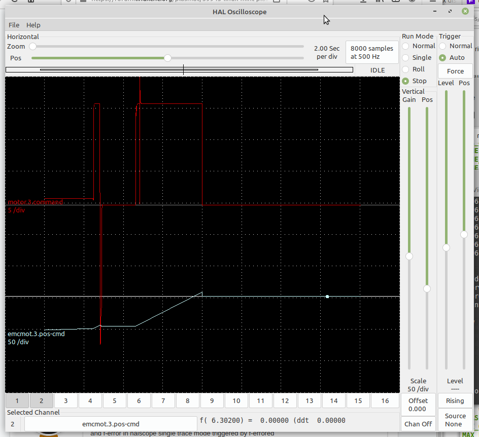

OK that suggests a glitch in the commanded position, maybe when changing
modes from THC to direct Z or vice versa.
This should be pretty easy to plot by plotting commanded position, feedback position
and f-error in halscope single trace mode triggered by f-errored

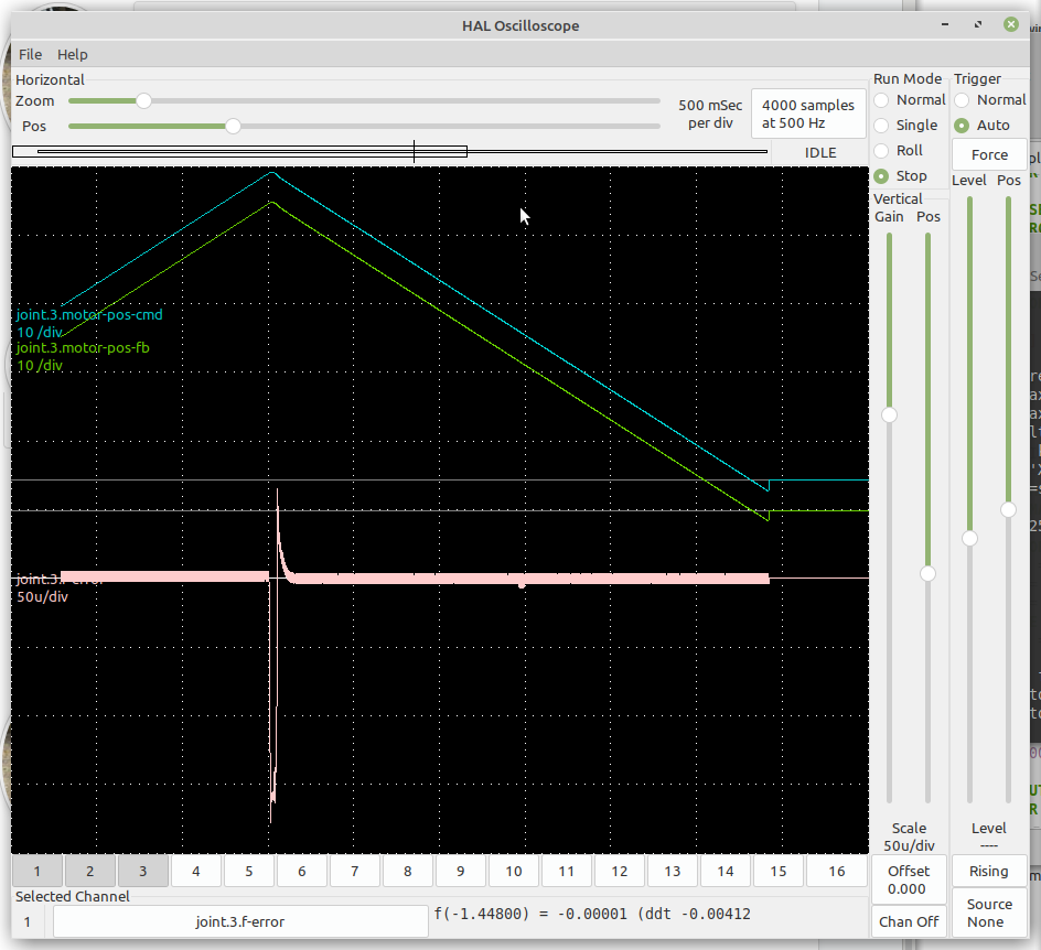

I'm not very good with hal scope - are the large spikes in commanded a smoking gun?
I couldn't find the error signal.

These are what I would look at:
joint.3.f-error
joint.3.motor-pos-cmd
joint.3.motor-pos-fb
joint.3.f-error
The following user(s) said Thank You: Mud

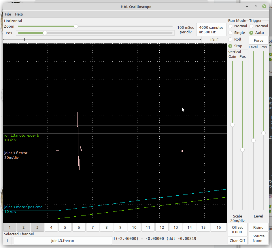

I was trying to catch the bit where it was tripping - I might need to read the halscope documentation, but the buffer seems quite small. Any use?

Replied by PCW on topic Linux Mint - PlasmaC upgrade confusion
You can capture it with normal trigger mode perhaps trigger on "joint.3.f-errored"
(assuming you set the following error limits small enough that you trigger a following error)
You could also set the to trigger on "joint.3.f-error" though I'm not sure whether the
large error is positive or negative. Make sure the scale for joint.3.f-error is at least
.1mm/ division, your first plot has the scale too small so tiny glitches are magnified
The second plot shows a 60 u error (.06 mm) which would have triggered a FE
with the 0.05 ferror limit

That 60 micron spike does seem to be the culprit for both the conversational circle and my scribe test code.
