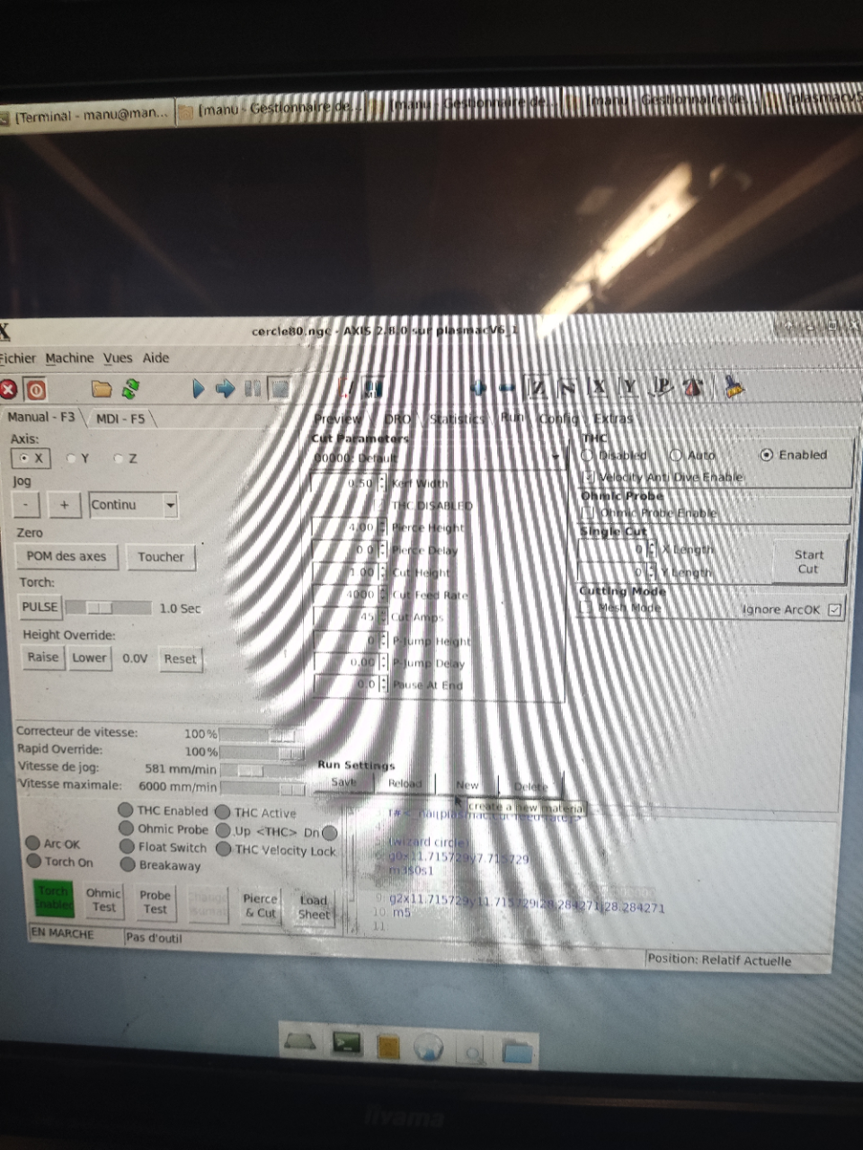

hello
my plasmac no longer works the inputs on my DB25 card when I short circuit between the gnd and pins 11,12,10 nothing happens.
I think it doesn't work. Is there a way to test them?
I can no longer find the user manual?

Did you try to cut something without the clamp attached to material?
First check the cables and connectors, make sure they are plugged in properly.
Use "show hal configuration" from the machine menu, on the right side choose the "watch" tab, on the left expand "pins", paraport, then click on pins 10,11,12,13,15.
Short the inputs to GND, do the LED's on screen change color?

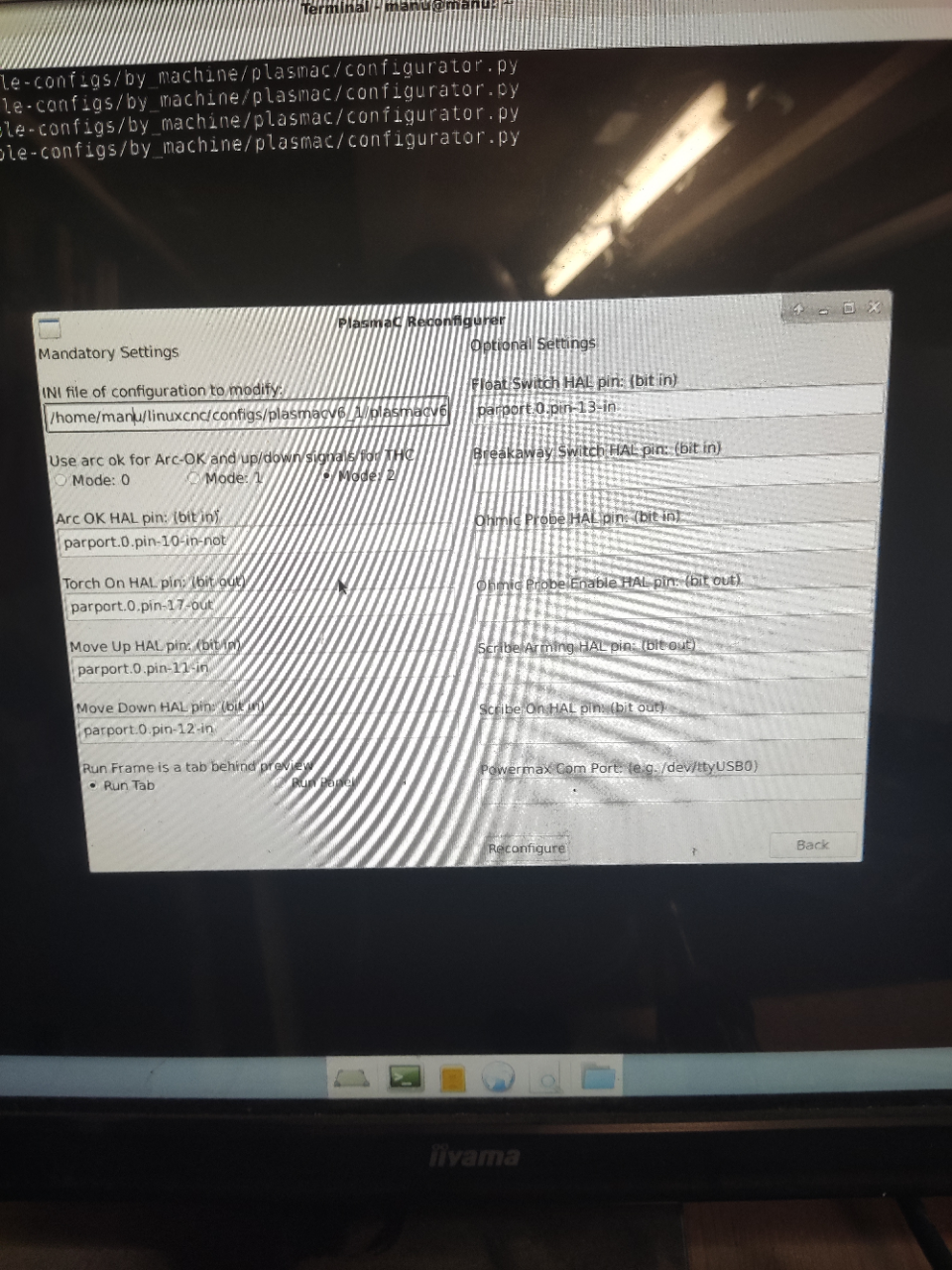

on your advice I installed debian12 linuxcnc 2.9.1 qtplasmac works ,same problem
I installed debian12 linuxcnc 2.9.1 qtplasmac works same problem
if I put pin 10 connect to the gnd I have ok arc which lights up
if I put pin 13 connect to the gnd I have float swith which lights up
if I put pin 11,12 connect to the gnd, no light comes on on the qtplasmac interface
if I swap all the inputs between them, float switch and arc ok works but not up and down

The up and down leds will only light if activated by the THC, they are connected directly to the component, not to the HAL pins.
