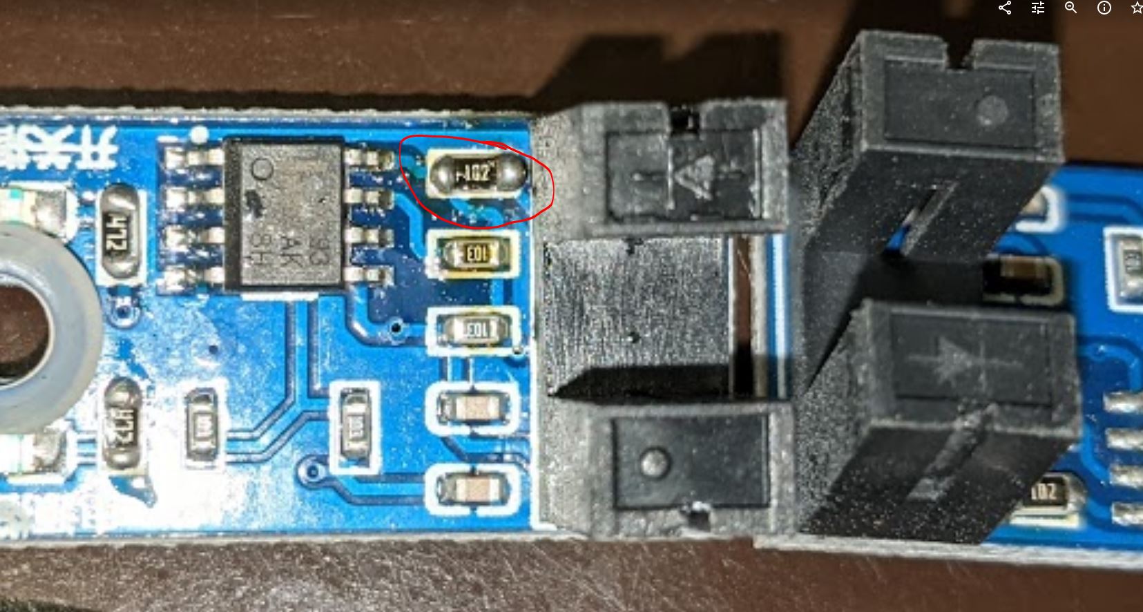

Looking more carefully, I would hazard a guess that the sensor boards are 5V eBay parts with a resistor or two swapped by hand. The end resistor adjacent to the Opto emitter looks to have been hand-soldered.
Are you referring to the resistors I have circled in red?
12 Jan 2021 16:01 #195076 by andypugh
Yes, but also the 2 x 4k7 (472) on each board.
The 102 (1k) is to limit the current through the LED in the sensor. (12v / 1000 = 12mA). The eBay version I linked to had 180R (181) resistors there for a 30mA current (which seems high). This seems to suggest that you can leave that resistor as-is.
Taking a random example from the RS catalogue (uk.rs-online.com/web/p/slotted-optical-switches/1690523/) shows that it is happy up to 50mA LED current. At 24V you would be driving it at half that.
The 4k7 resistors are (probably) the current limiters for the two indicator LEDs. 24V / 4k7 = 5mA. I doubt that many LEDs would be troubled by 5mA. (And, can you even see them when the unit is assembled anyway?)
Given that replacements are easy to source, I would test at 12V from a lab PSU and slowly increase to 24V whilst watching the current draw.

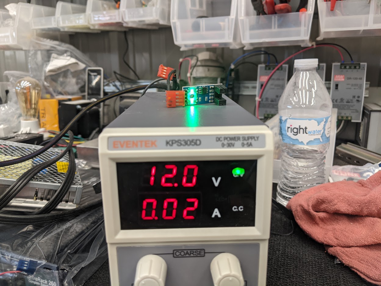

12 Jan 2021 16:07 #195078 by txtrone
Will do! I ordered these from Amazon, should be here tomorrow. www.amazon.com/gp/product/B0776RHKB1/ref...00_s00?ie=UTF8&psc=1

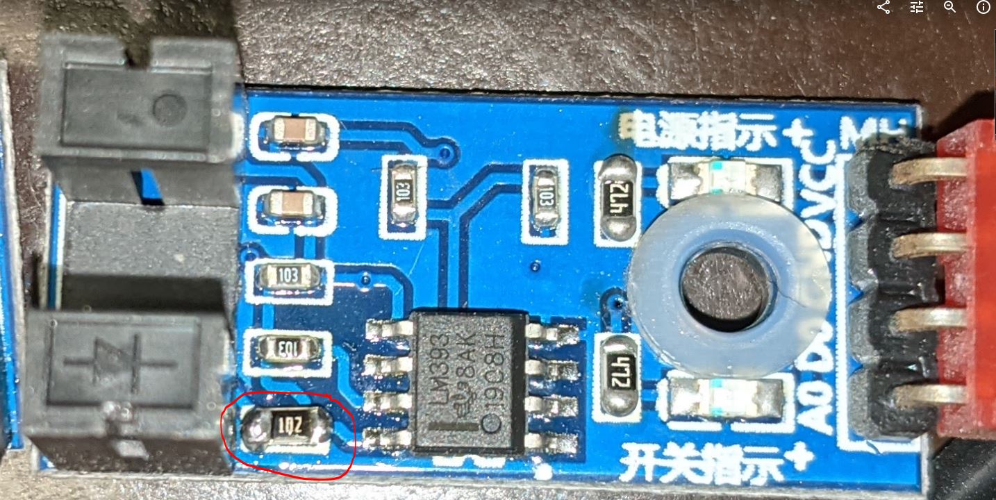

Which resistors would I want to replace, and with what value, to make these work with 24 volt for sure? I have a local electronics store right down the way.
The led lights are sort of visible, more of a 'cool' factor I suppose. If they are not necessary then I do not care.
Thanks! This has been very helpful!
A couple of other questions, very noobish.
1) Is this goop that was used to semi seal these boards and wire into the z car most likely everyday run-of-the-mill silicone? Or something more specialized?
2) Are these sensors digital or analog outputs?
12 Jan 2021 16:20 #195080 by andypugh
I would expect there to be a potential divider to provide a reference voltage for the comparator. That should stay the same.
Then a pull-up for the opto output, again that can probably stay the same.
The LED current limiters look to me like they might already be for 24V operation. You can see 181 for the sensor and 102 for the indicators. Your board has each of them approximately 5x bigger. If they were originally 5V boards, now they are 25V boards.
Obviously I can't feel it from here, but it looks like hot-melt glue to me.
I would guess both, there are pins marked DO (Digital Out?) and AO (Analogue Out?). There would be no need for the LM293 if there wasn't a digital output.

12 Jan 2021 16:34 #195084 by txtrone
You are awesome! I was just wondering what AO and DO stood for, was going to google it when I got back to PC to send you this picture? :)
I will give it a go at 24V now.

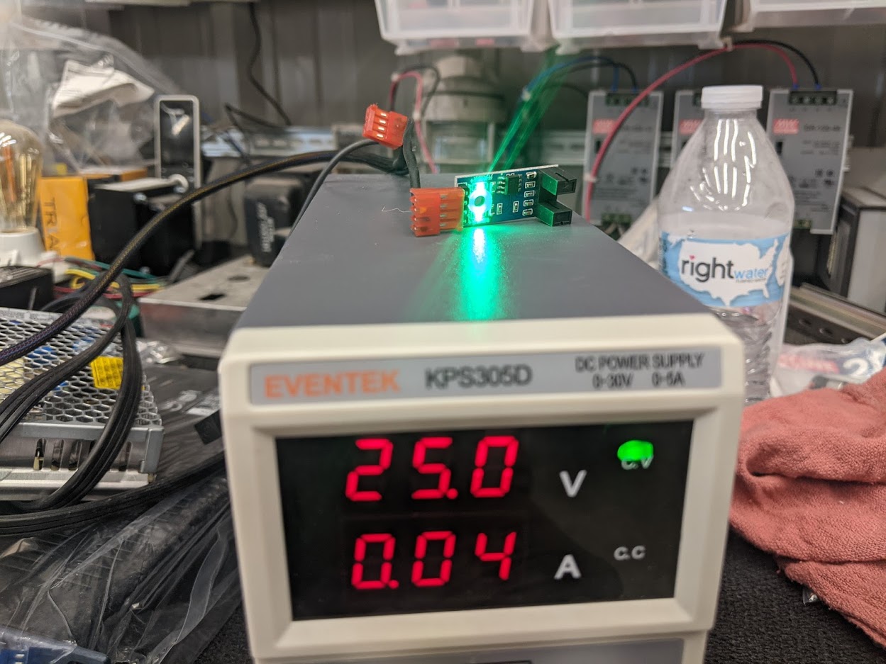

I forgot to add this last photo, it works (as Andy said it would) at 25vdc. At this point could I incorporate THCAD into this? Should I use the electronic 'box' or 'hub' that is on my Z or should I do away with that?

12 Jan 2021 23:40 #195146 by andypugh
Have you tested by putting something opaque in the gap then looking at AO and DO voltages relative to Gnd?
