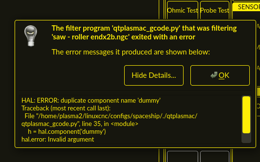

Yes, Actually on further testing, this is unearthing some bugs in the Qtplasmac input filter.
1. If a variable like #<h_velocity> is set and there is a gcode comment on the same line, an error occurs parsing the number
2. if holes and magic comments are in the file, there is a python error. Commenting out the magic comment, removes the error
I think the filter needs to use a different name when creating the instance.

So the displayed error I think I am going to put down to being a result of the comment on hole processing numbers leaving QTplasmac in an inconsistent state and causing the second error. Its gone after a restart.
But the bug on on comments is confirmed. Try loading the attached
I found a copy of Phill's post so don't worry about that. Some features are implemented but I think the move of the spotting code to the drilling method broke some stuff. It looks like there was only one line missing so I'll test more

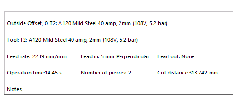

Is this what you wanted to see?
;begin statistics
;Pierces = 4
; Cuts = 4, Length = 627.48mm
;end statistics
Should show in inches for you.

- Posts: 12159
- Thank you received: 4151
09 Nov 2021 05:15 #225775
Replied by rodw on topic Sheetcam revised post - please test
It's not the magic comment. Its the comment after setting some of the hole cutting variables.
It looks like there is a string to float conversion happening but the number AND the rest of the line is being parsed causing an error
Its 100% valid gcode the filter is erroring on. It should therefore parse it correctly.
The reason I wanted to add comments to the hole cutting variables was so the generated gcode was more meaningful to the user.
I think I will leave the post processor as it is now as Les has copied it for inclusion in his next release. In any case, the sheetcam report provides the data you are looking for at the part level.
