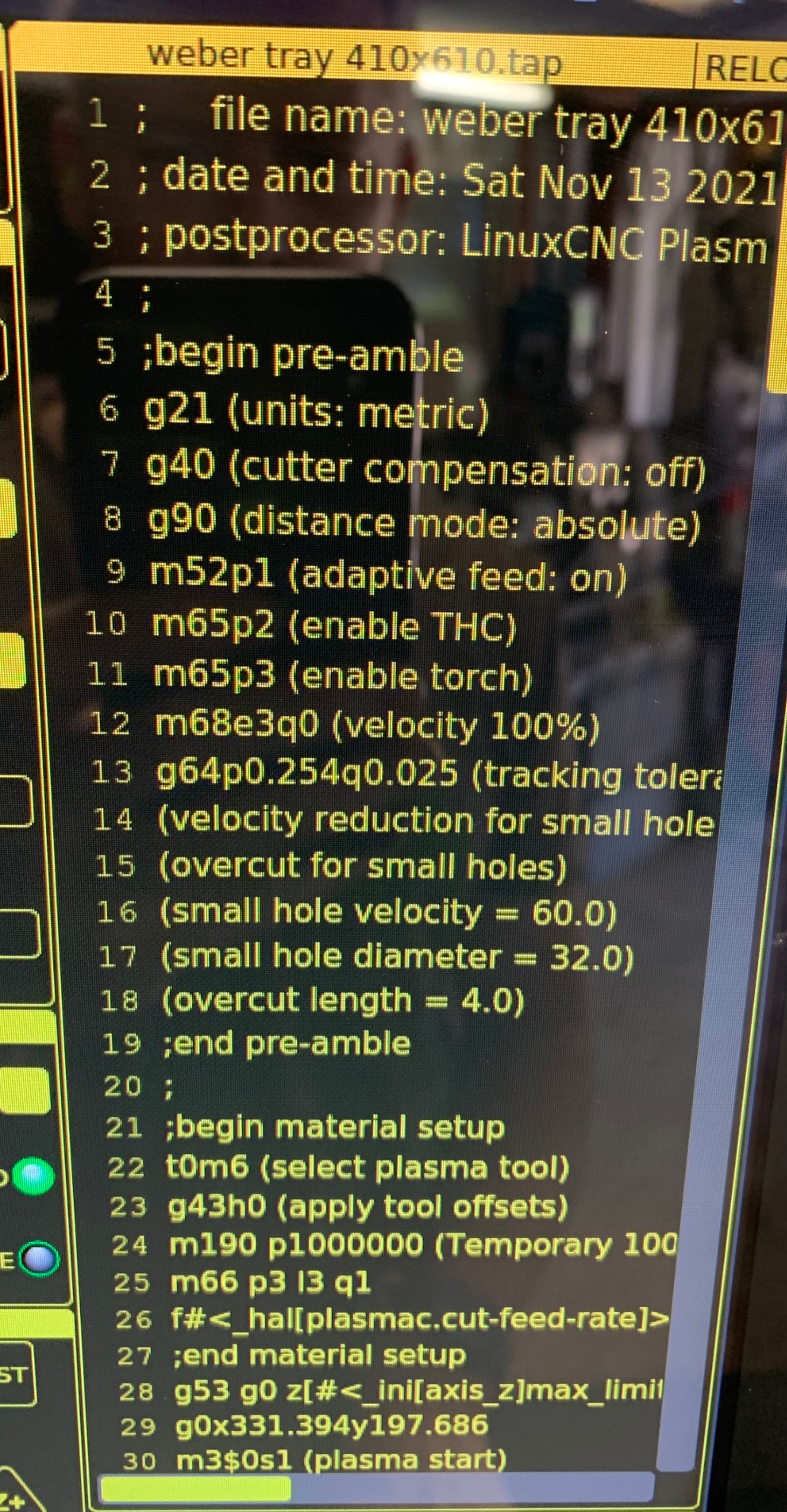

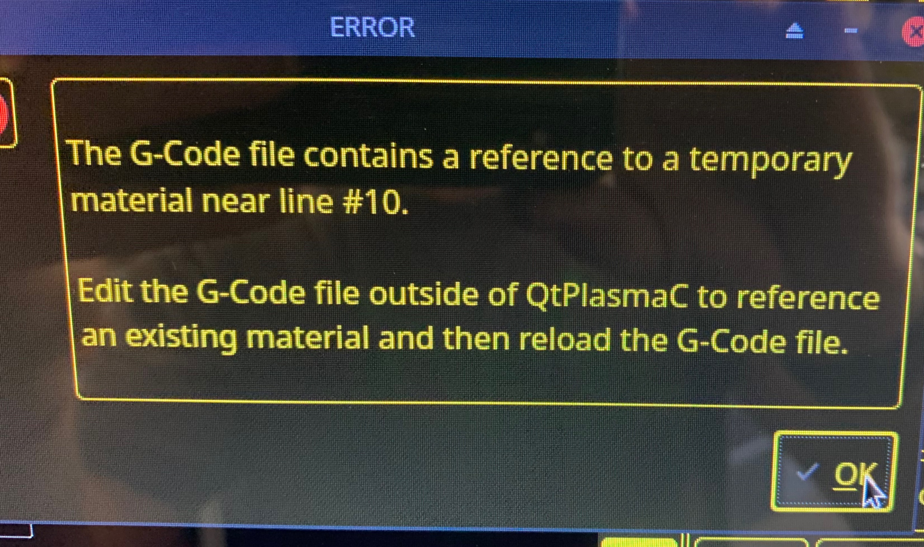

13 Nov 2021 01:39 - 13 Nov 2021 01:41 #226262 by RNJFAB
Replied by RNJFAB on topic Sheetcam revised post - please test
Hey Rod,
I updated to this post on the new machine running QTPlasmaC.
The only problem (re:user errors) I'm encountering is that since the rain I keep getting power outages in the shed (not asscoiated with this) and when I restart and get everything aligned again, I can only start from the beginning of the job. Previously I would be able to enter a job at the beginning of any cut.
The error I get is attached, along with the first 30 lines of gcode.
I think I may just need to get the toolset loaded into QTPlasmaC, however I am still adjusting these in sheet cam as I learn the machine anyhow it runs.
Last edit: 13 Nov 2021 01:41 by RNJFAB.
13 Nov 2021 02:03 #226263 by phillc54
Replied by phillc54 on topic Sheetcam revised post - please test
With the current G-Code filter you won't be able to run from line if you use temporary materials. We could probably rework the filter so that this is possible.
The following user(s) said Thank You: RNJFAB
13 Nov 2021 02:10 #226264 by RNJFAB
Thanks Phillc54.
So only workaround is to go to an old pp and choose the material in QTPlasmac?
