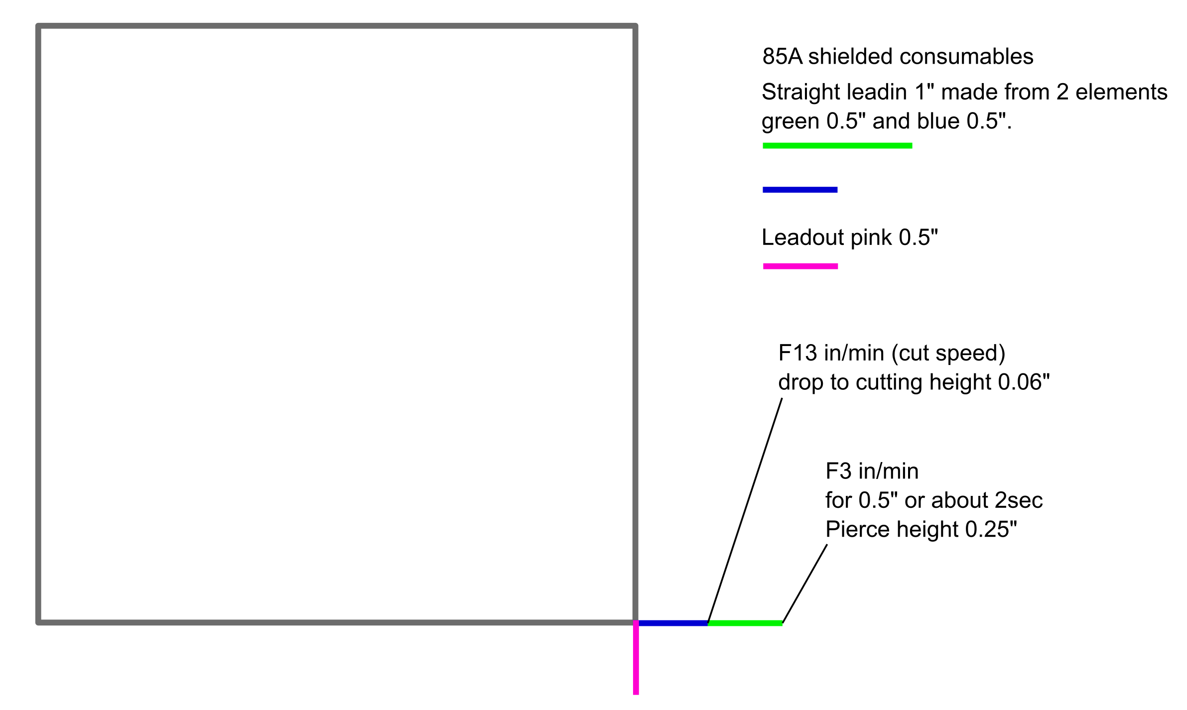

I'm following this piercing conversation with interest. When I built my table I figured most of what I'd cut would be 1/2" or less but I'm surprised how often I've been asked to cut 1" plate. My Powermax 85 sometimes pierces 1" without problem and sometimes it struggles quite a bit. Once it is through, it cuts 1" beautifully. For now I can't afford to upgrade my plasma unit so if any improvements are made that will allow small machines to pierce thicker material, I'm all for it.

You can read about Monokrom here. forum.linuxcnc.org/qtpyvcp/40082-monokro...mac-and-mill?start=0
Ok so the next time you cut 1" or if you have some scrap lying around try something like in the attachment, maybe not spot on but pretty close. When you figure out the correct speed to move while piercing you can set the lengths of everything else.
