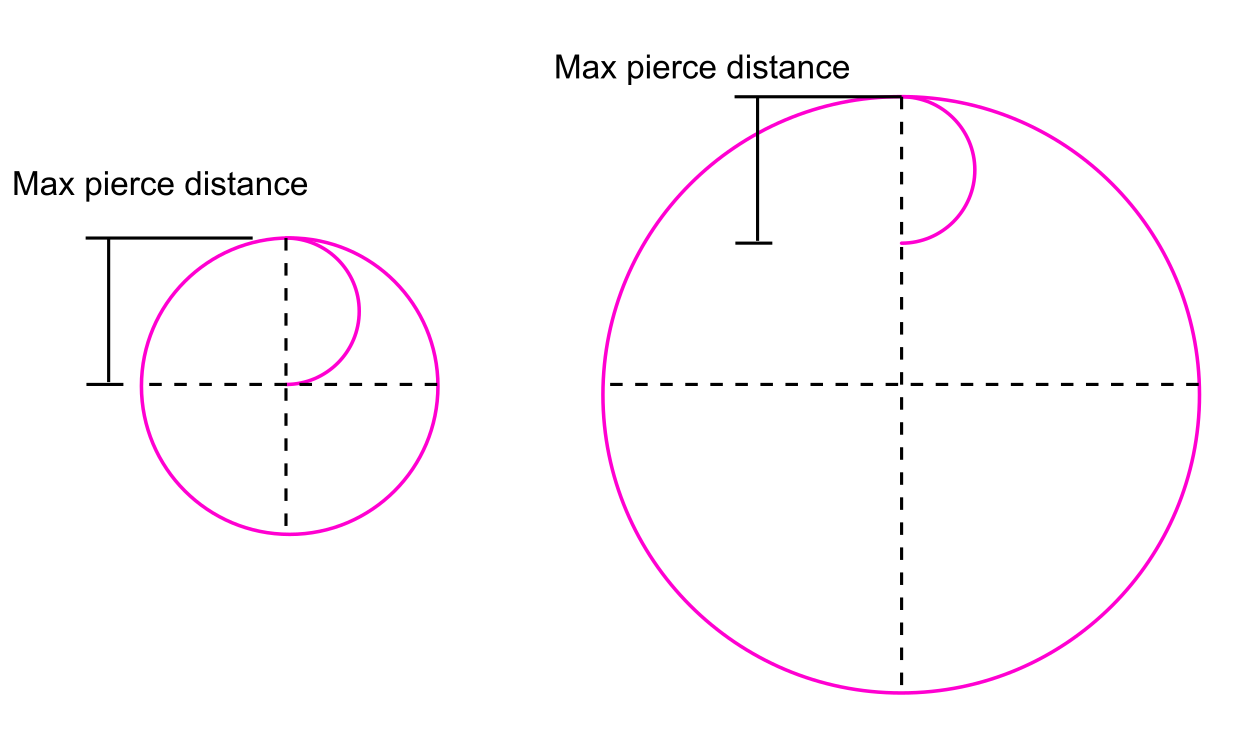

It becomes quite clear that a large part of high def plasma is that the machine is tightly integrated with the CAM environment.
Here at Linuxcnc we dont have any control over the CAM process. But we can filter the input files and modify the code sent to the machine
As we start to explore higher end cutting features, we are also constrained by the design of plasmac which "locks" the piercing algorithm away from developers like Joco.
I've gone through my emails and have gathered up the discussion we had with around plasma hole cutting and attached it as a PDF here. Its intersting to note that different manufacturers have different methods to connect the arc to the hole centre. In terms of the gcode generated, there is not any difference between an arc or a straight line regarding code generation complexity. I went with arcs as it looked cooler but straight lines might be quicker to cut.
If you wanted to shorten the leadin as you suggest for 20mm holes, you simply would not generate the arc/line to the centre hole. You have to generate the cut path from the end of the cut, working back to the centre, but the gcode flows in the other direction so that is easy. Of course it is also possile to inject additional code at each of the control points.
So to accommodate what you suggest for all holes, say the largest entry in your hole database was 5 x thickness and you were cutting 10mm plate,
That defines the biggest high def hole at 50mm. But my recollection was that if the hole exceeded the maximum database diameter 50mm in the eample here) the leadins would be unchanged from the original. Following your suggestion, for holes above that max size (50mm in the example), you just need to generate the arc leadin but skip the segment from the centre.
Enjoy the attachment. That is the algorithim Joco baked into Monokrom and I tested with a few cuts.

I cant comment on plasmac as I don't have the expertise on how its locked or open.
Sorry if my explanation of the pierce distance was poor, you would not remove the first 2 arcs and only have the tangential one, in your case you would just copy the 50mm leadin geometry (along whit all the other hole parameters) and use that as is for all holes bigger than 50mm. The maxed out center pierce remains the same but the start just stays on one of the center axis. Center pierce would place the leadin start on both X/Y axis but in case the hole is bigger than the max, it would "lock" only on example the hole Y axis.
Actually the 2 arcs + tangential arc is faster that the straight + arc, so I would say its better.
But again most if all of these can be done at least 2 different ways. Everything integrated in a CAM system that generates g-code that the CNC blindly follows. Or you integrate these functionalities to the CNC and use a filter like in monokrom. These are done in both ways all over the world, I typically like the CNC approach better as then you are not locked into and rely in a CAM system.
I hope this this gives a more clear idea whats inside my head, most of this stuff is 100x times more easy to explain in person.

08 Jan 2024 05:56 #290184
by Joco
Replied by Joco on topic Feature Request: ramp piercing (aka moving piercing)
Shifting back to the original topic, is there an interest in me crafting a pull request against the linuxcnc repo for my ramp pierce work? Or shall I maintain it off to the side as part of an extension for monokrom plasma?

Moving Pierce capability is now available in linuxcnc Master (aka 2.10). PR reviewed and polished with advice/suggestions from PhillC. Thanks to all who provided input and ideas into this and to Rod for sending me the hypertherm white paper that got me thinking about how this capability could be made to happen within the constructs we have today.
While its not a "use every day" festure for those who find themselves in a position where they periodically need to be able tp push the limits of their plasma source but can not justfiy more $$ down for more AMPs this facility will support you getting a little our of your gear without having to drill holes to allow edge starts.
And the good news is that there is no need for an updated sheetcam PP. You crate a gcode tool with the needed mwords in the mix and have that insterted at the start of your programme.
Also note that the QTPlasmac documentation has been updated with a moving pierce section that sets out the M159 usage and what the parameters do.
