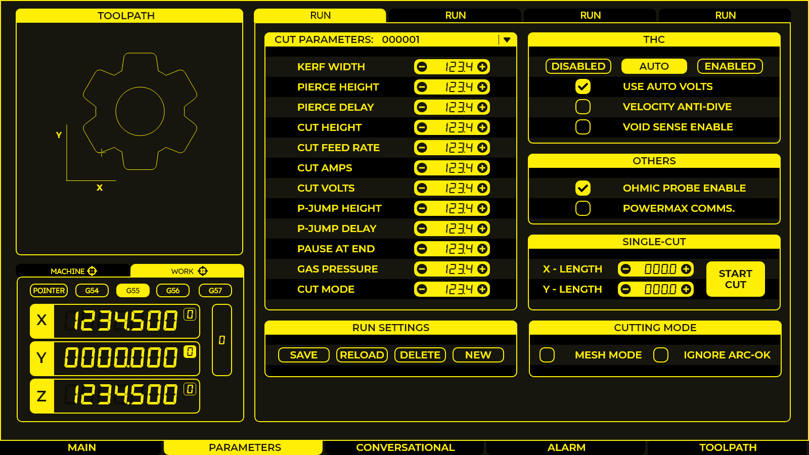

1. The first thing I noticed is the Breakaway status is missing from the Main page.
It can be added.
2. The THC panel has things in it that have really nothing to do with the THC.
can you mention those?
3. Consider having all of the "File" options on their own tab, this will free up a lot of room.
if more people ask so.
4. I agree, there is a need for custom buttons on the main tab. A lot of us use that a lot.
again if more people ask it
5. I saw you left the Hypertherm Comms off of the config tab. Do you have a plan for those? As a hypertherm user, I need them :)
it was a space problem, I'll see if can manage
6. The rapid, feed, and jog sliders are a bit large, any thing we could do to shrink them?
they are work under progress, you must have seen large screen screencapture
see the first page for reference size
7. Any chance we could work the time on to the main page? If we are going to load this full screen on touch monitors, seeing what time it is is really useful :laugh
time can me placed. I'll update in next screen
8. Can the "Alarm" tab, or really any of them blink when there is something that requires your attention there?
Sure
9. For cut recovery, there are a few directional arrows missing (diagonal).
i have not used cut-recover before.
those can be added in needed.
10. I really like the colored G-Code.
Sorry, red is only for errors.
For example, the OHMIC and THC wouldnt have to take up so much room.
read carefully.
thats only a config panel.
thankyou for your suggestions. you've got a pretty GUI yourself
Probe, Float, Arc-Ok, Float, Torch really have nothing to do with the THC.
You might consider cross posting this in the PlasmaC section to get more feedback. I'm pretty active over there, and it took someone pointing me here for me to see it...
read carefully.
Sorry I was not clear, that was in reference to the GUI I mocked up. I had really large THC and OHMIC buttons that didnt need to be that big :)
Thank you for adding the other suggestions to the "list". I know there is a lot of hard work going into this!
They are indicators not buttons and are pretty important to me. All buttons have touchable size.
Things on the main screen will have to be stick like that, because that it the idea from where it all started. IMHO Changing too much will ruin everything, and we will forget from where we started.
Should I post on PlasmaC forum too?
thankyou too for your suggestions.
here's your powermax option

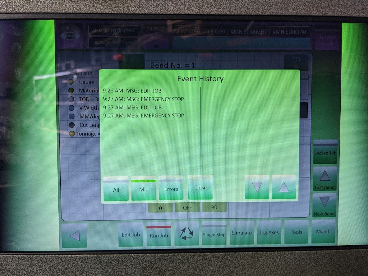

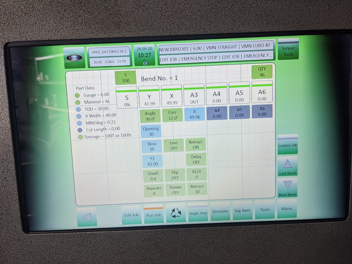

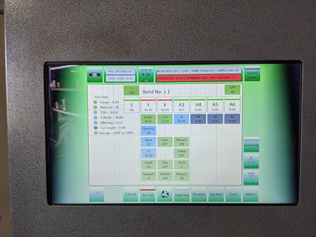

28 Sep 2020 00:41 #184084 by rodw
Replied by rodw on topic MonoKrom - QtPyVCP GUI for PlasmaC
Based on what KJC has said about error messaging, I thought I'd share these screens for some inspiration....
Pressbrake with no errors (note status lines at the top - first line summarises job settings, Job ID, Material thickness, top tool, bottom die; Second line prints latest event log entries)
The status line concatenates the last few errors on one line
Note the buttons are all colour coded. Green is operator entry, light blue is system calculated and will change colour if you override it.
Nothing will run until all axes have a green bar in them
Pressing Run, its bar will go green unless there is an error somewhere. Foot pedal is activated. Pressing foot pedal runs the cycle.
Pressbrake with estop set. Status turns red.
Clicking on the status line at any time displays the error log
The following user(s) said Thank You: KCJ, pinder
