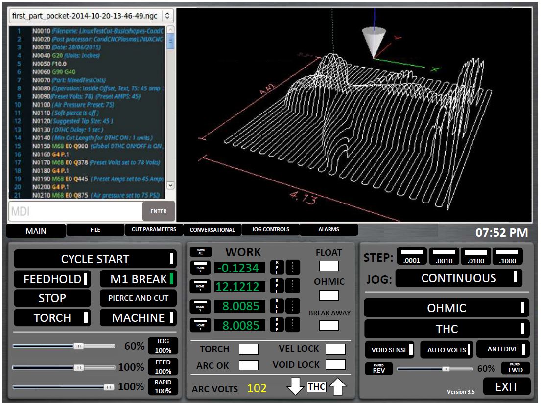

27 Sep 2020 21:42 #184063
by snowgoer540
Replied by snowgoer540 on topic MONOKROM - QtPyVCP GUI for PlasmaC
I'm a little late to the party here. I like the feel of the GUI and where it is headed! I had made a crude mockup of one myself back in March, but I don't have the skill to bring it to life without years of study (as you said
). Keep up the good work.
I have some unsolicited feedback and suggestions if you'd like them:
1. The first thing I noticed is the Breakaway status is missing from the Main page.
2. The THC panel has things in it that have really nothing to do with the THC.
3. Consider having all of the "File" options on their own tab, this will free up a lot of room.
4. I agree, there is a need for custom buttons on the main tab. A lot of us use that a lot.
5. I saw you left the Hypertherm Comms off of the config tab. Do you have a plan for those? As a hypertherm user, I need them
6. The rapid, feed, and jog sliders are a bit large, any thing we could do to shrink them?
7. Any chance we could work the time on to the main page? If we are going to load this full screen on touch monitors, seeing what time it is is really useful
8. Can the "Alarm" tab, or really any of them blink when there is something that requires your attention there?
9. For cut recovery, there are a few directional arrows missing (diagonal).
10. I really like the colored G-Code.
I attached a screenshot of the mockup I made from March, so that if for no other reason, you could maybe derive something useful, inspiration maybe (if necessary lol) out of it. If not, that's ok too! Some of the layout I would do different, as there are now features that there were not back then. For example, the OHMIC and THC wouldnt have to take up so much room.

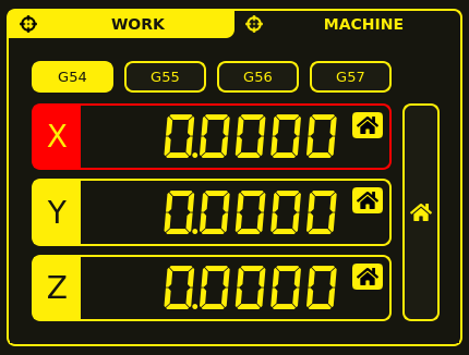

27 Sep 2020 21:45 #184065
by KCJ
Replied by KCJ on topic MONOKROM - QtPyVCP GUI for PlasmaC
I have this implemented for axis faults. I think it looks ok, and is clearly indicates which axis has faulted.I Know you want to keep true to a monokrom screen but when I looked at best practice for HMI controls, it said that colour and other features should be used to draw the eye to a problem. So if it were possible, I would like to suggest that a section of the screen be allowed one different colour combination to highlight problems and errors. My press brake has one single status line that turns red when in an error state (estop, on limit etc) is present. I would suggest something similar but for this GUI, I think red background with white text would draw the eye very effectively.
Yes, QtPyVCP already catches and makes the error messages as channels. There is an error messages widgets that records each error with a time stamp, and you can sort and filter error messages based on type. Maybe we can use this, or make something similar that might fit in with the design better.It would be great if all the annoying popups that Linuxcnc raises on errors could be captured and constrained to a single fixed area of the screen. I'm not sure if linuxcnc can be tamed in this way.
