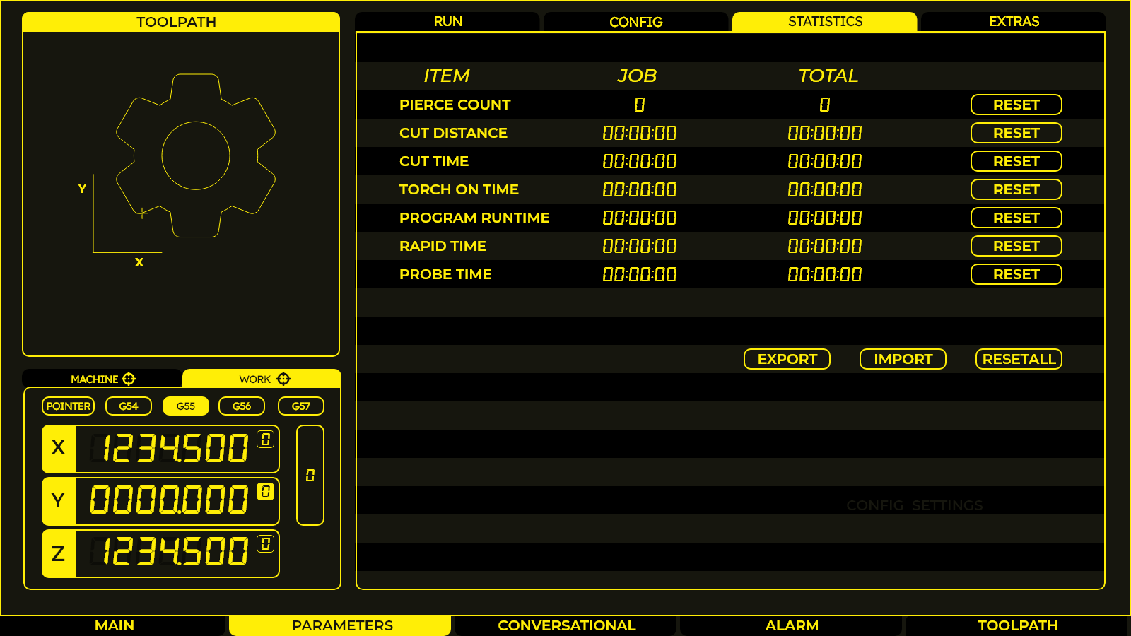

30 Sep 2020 04:24 - 30 Sep 2020 04:25 #184348
by pinder
Replied by pinder on topic MonoKrom - QtPyVCP GUI for PlasmaC
Statistics panel done;
I'll get some hands-on with qt designer.
I think option of exporting stat data to csv or other suitable format would be excellent for some people, even importing it will help in some cases.
if it is stored in csv, then i thin it will be pretty simple.
svg is in the zip
svg is in the zip

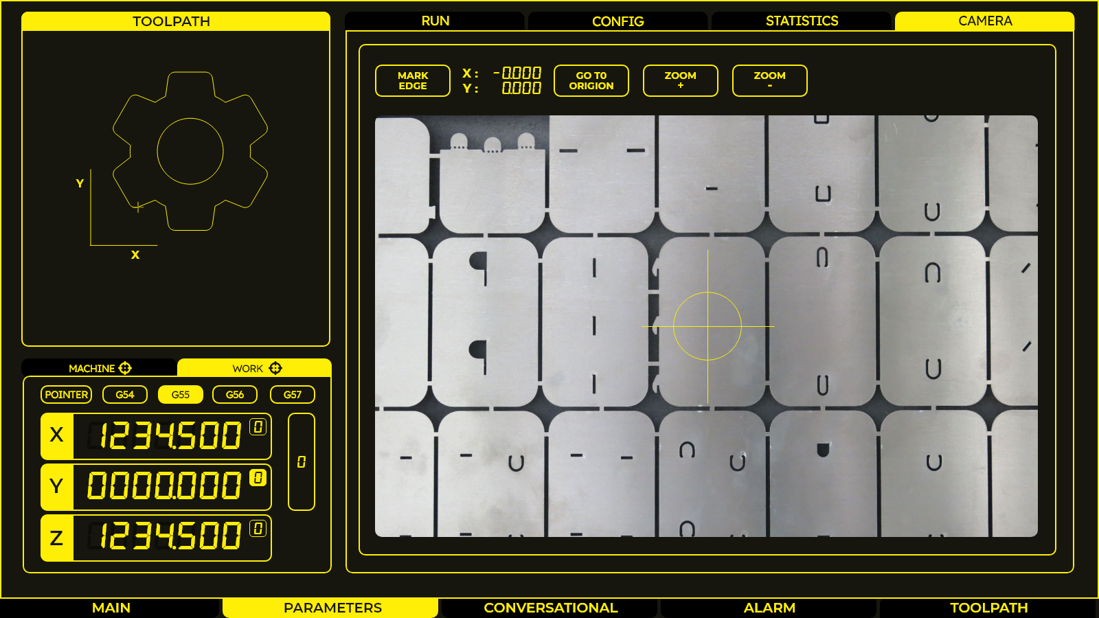

30 Sep 2020 06:18 - 30 Sep 2020 06:21 #184355
by pinder
Last edit: 30 Sep 2020 06:21 by pinder.
- KCJ
- Posts: 328
- Thank you received: 267
30 Sep 2020 11:15 - 30 Sep 2020 11:15 #184371
by KCJ
Replied by KCJ on topic MonoKrom - QtPyVCP GUI for PlasmaC
Looks good!
A camera panel is a requirement I think. And is easy to add from a programing point of view, so there is no reason not to.
I made great ptoy on reading and writing the run setting last night. I'll post when I get home from work this evening.
Pinder, can you wip up a simple design for a splash screen witth loading progress indicator? I'm no good at design...
