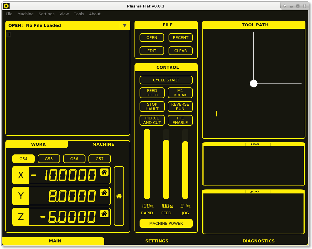

I have published the VCP to GitHub:
github.com/KurtJacobson/plasma-flat
Install instructions are in the readme. Once installed set the display in the INI to Plasma Flat (for lack of a better name)
To update the VCP as it progresses simply rerun the pip install command for plasma-flat.
I ran my RF45 clone mill with the VCP today, and it worked great on my 1024x768 touch screen!
