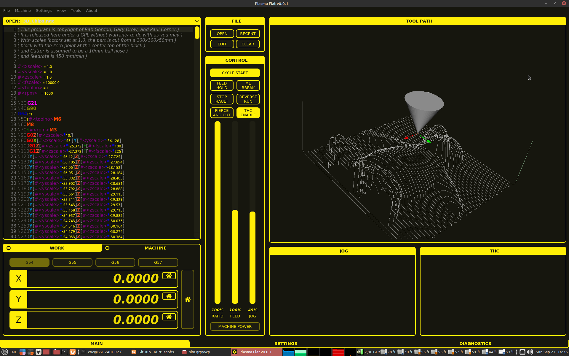

For QtPyVCP to work on Linux Mint 20 or Ubuntu 20.04 before any attempts at installing it, you have to follow this short snippet on creating a dummy package here, from "detailed solution"
askubuntu.com/questions/1254347/how-to-g...hon2-on-ubuntu-20-04
Then install as per KCJ tutorial on github.
Took me bloody 2 hours to get it to work on Mint 20.
Edit:
Use this if you have "package not found" issues on Mint20
community.linuxmint.com/software/search
Replied by tommylight on topic MONOKROM - qypyvcp GUI for plasmac
Edit:
Last edit: 27 Sep 2020 14:45 by tommylight. Reason: more info

27 Sep 2020 15:04 #183986
by KCJ
Replied by KCJ on topic MONOKROM - qypyvcp GUI for plasmac
Thanks tommylight, I'll add that info to the readme. Definitely save some people some time.
I did a fresh install on the latest official LinuxCNC 2.8 ISO, and it worked without any hiccups. Hopefully that's what most people will be using.
I see there are a few style inconsistencies in your screenshot, I'll get those fixed.
- KCJ
- Posts: 328
- Thank you received: 267
27 Sep 2020 15:14 #183988
by KCJ
The command line and INI options provide a way to control the initial window state (maximized, fullscreen etc.) and options to hide the status and menu bars. I find the menu bar very handy since provides a place to access less commonly needed actions that don't warrant space in the VCP, but its easy to enable/disable depending on preference.
F11 can always be used to toggle the full screen state of the VCP.
All the Display command line options can be set in the INI instead if desired.
We can change what the defaults are if you like, its very easy.
Cheers,
Kurt
