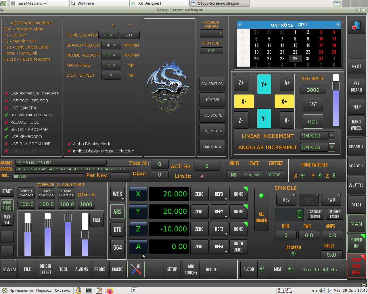

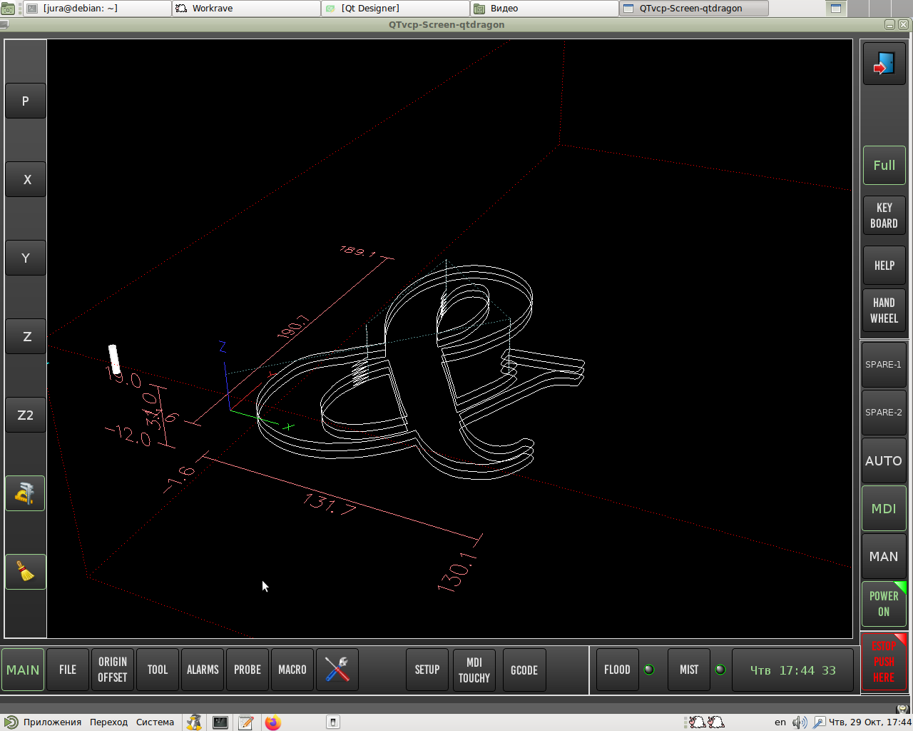

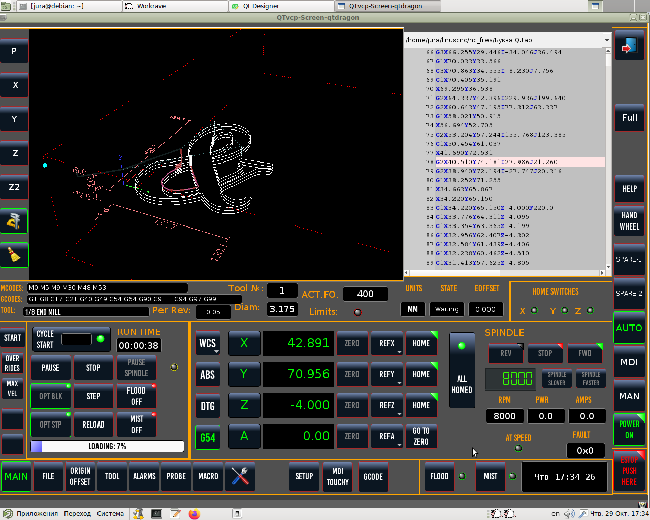

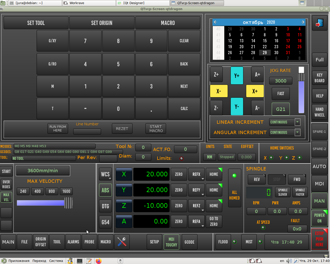

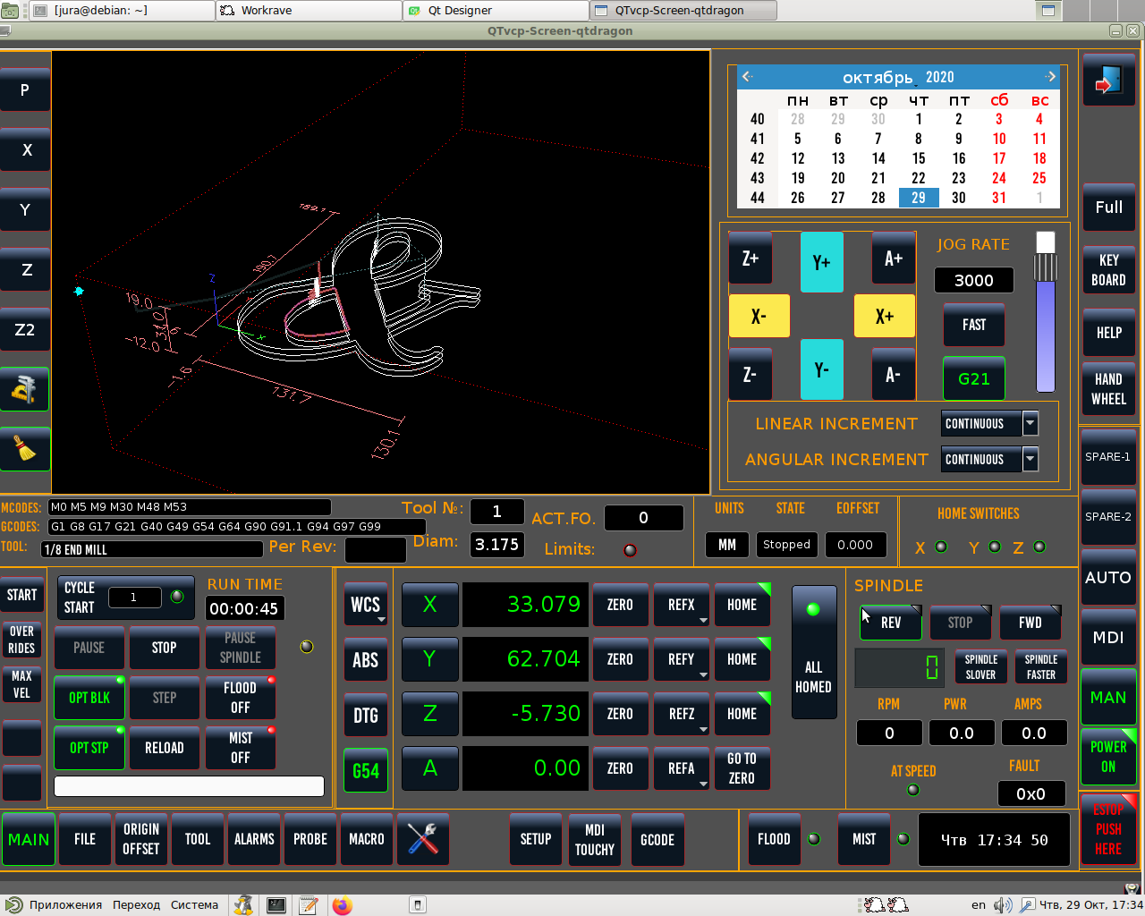

29 Oct 2020 15:51 #187693
by hottabich
Replied by hottabich on topic Sample Qtvcp Screens

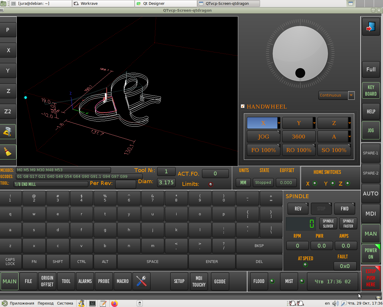

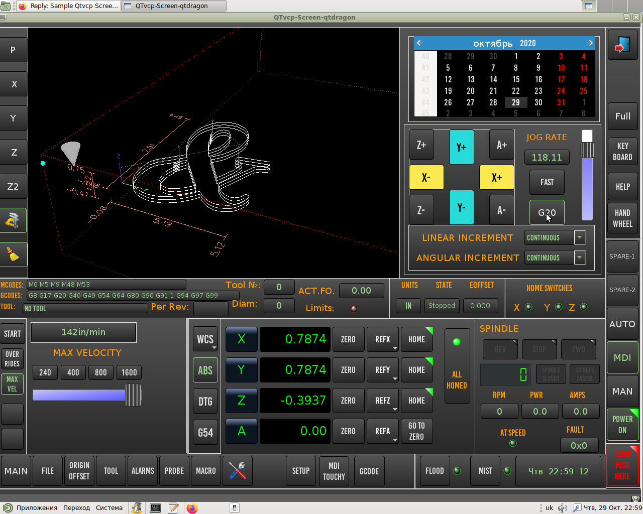

Here is a hybrid at 1280x1024. Please tell me how to add a grid without a menu bar?

29 Oct 2020 20:28 #187720
by lllars
Replied by lllars on topic Sample Qtvcp Screens
Looks good! Thanks for the link last week also. I did test it out back then, but ran into some errors with the rate sliders being stuck in mm mode. I also started stretching it out to 1280, but it was a lot of work since most everything had broken layouts. Then, I got busy and moved on.
This would definitely be a better interface for me if it ever gets to be as polished as qtdragon. I also think a resizeable version could be made to cover a variety of resolutions (maybe 1024x768 up to 1920x1200).
I would be willing to take a stab at making it resizeable. It seems like you've been adding a lot of new features, so maybe it makes since to wait until after the feature set has stabilized a bit.

29 Oct 2020 21:02 - 29 Oct 2020 21:03 #187723
by hottabich
Thanks for attention. From the functionality, only copying files is missing, which, if desired, is possible add. Added widget for macros, camera and MPG. Everything works with both mm and inches. Of course, it is necessary to modify it for a specific machine.

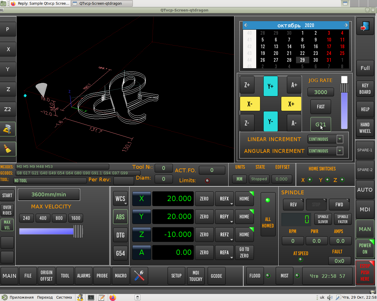

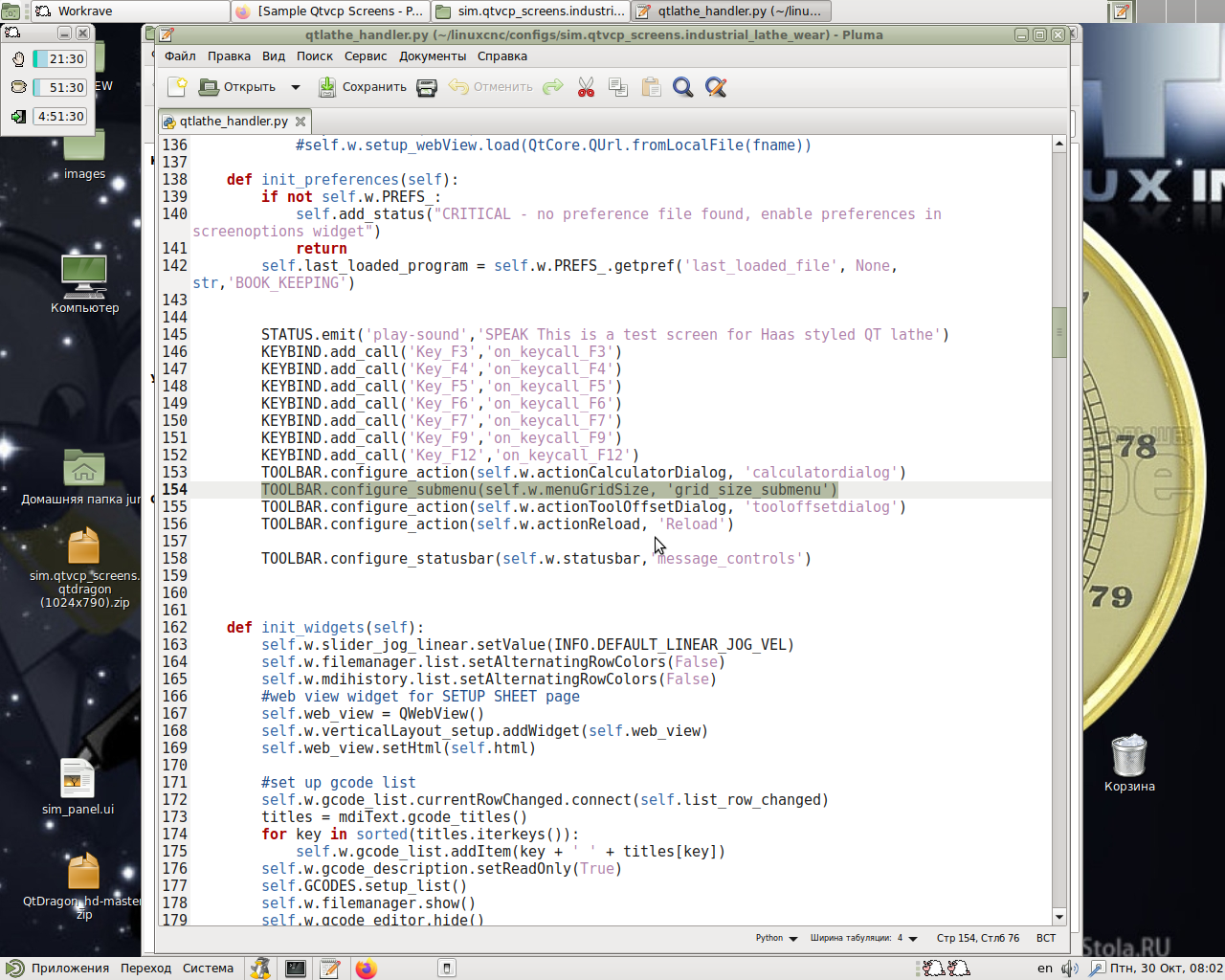

30 Oct 2020 06:21 #187752
by hottabich

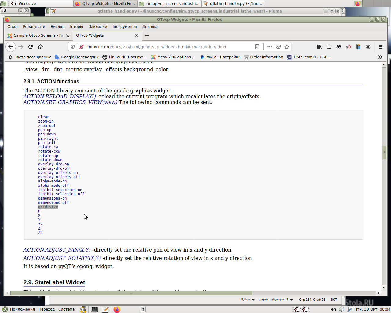

Difficulties in translation. How to make grid display without, and with the help ACTION functions. Thanks for attention!
TOOLBAR.configure_submenu(self.w.menuGridSize, 'grid_size_submenu')
The following user(s) said Thank You: porshe
- Posts: 7368
- Thank you received: 2181
30 Oct 2020 12:01 #187788
Replied by cmorley on topic Sample Qtvcp Screens
Ahh now I understand!
there is the code for setting the toolbar:
it reads the raw grid increments found in the INI fle.
It then parses them, converting the text 'in' and 'mm' etc to machine units.
if the action is triggered:
ACTION.SET_GRAPHICS_GRID_SIZE(data)
sets the grid of the graphics display
Hope that helps.
Chris
def addGridSize(self,widget):
def setSize(data):
print INFO.GRID_INCREMENTS
for temp in (INFO.GRID_INCREMENTS):
if temp == '0':
sizeAct = QtWidgets.QAction('Off', widget)
sizeAct.triggered.connect(lambda: setSize(0))
widget.addAction(sizeAct)
continue
i = self.parse_increment(temp)
sizeAct = QtWidgets.QAction('%s'%temp, widget)
# weird lambda i=i to work around 'function closure'
sizeAct.triggered.connect(lambda state, i=i: setSize(i))
# We convert INI parced increments to machine units
def parse_increment(self, gridIncr):
if gridIncr.endswith("mm"):
scale = self.conversion(1)
elif gridIncr.endswith("cm"):
scale = self.conversion(10)
elif gridIncr.endswith("um"):
scale = self.conversion(.001)
elif gridIncr.endswith("in") or gridIncr.endswith("inch"):
scale = self.conversion(1., metric = False)
elif gridIncr.endswith("mil"):
scale = self.conversion(.001, metric = False)
else:
scale = 1
incr = gridIncr.rstrip(" inchmuil")
if "/" in incr:
p, q = incr.split("/")
incr = float(p) / float(q)
else:
incr = float(incr)
LOG.debug("parceed: text: {} Increment: {} scaled: {}".format(gridIncr, incr, (incr * scale)))
return incr * scale
# This does the conversion
# calling function must tell us if the data is metric or not.
def conversion(self, data, metric = True):
if INFO.MACHINE_IS_METRIC:
if metric:
return INFO.convert_metric_to_machine(data)
else:
return INFO.convert_imperial_to_machine(data)
else:
if metric:
else:
return INFO.convert_imperial_to_machine(data)it reads the raw grid increments found in the INI fle.
Hope that helps.
Chris

30 Oct 2020 16:45 #187803
by hottabich
Thank you so much! I will definitely try a little later. I think it will work.

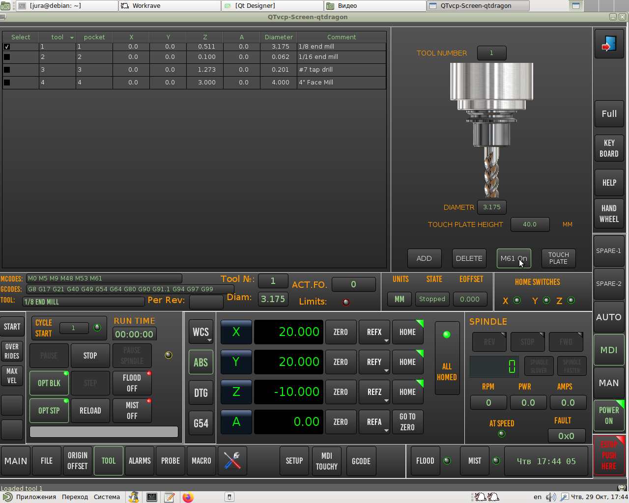

19 Nov 2020 13:06 #189776
by hottabich

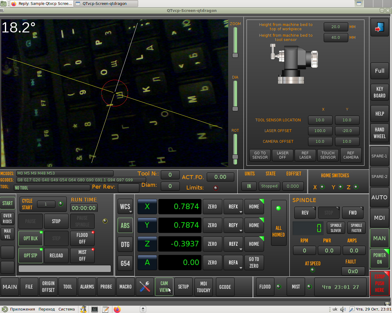

This is what QtDragon looks like at 1920x1020. If anyone can add an auto-change instrument will
alternative to probe basic.

Hello, where i can download the UI?This is what QtDragon looks like at 1920x1020. If anyone can add an auto-change instrument will
regards
Karlram
