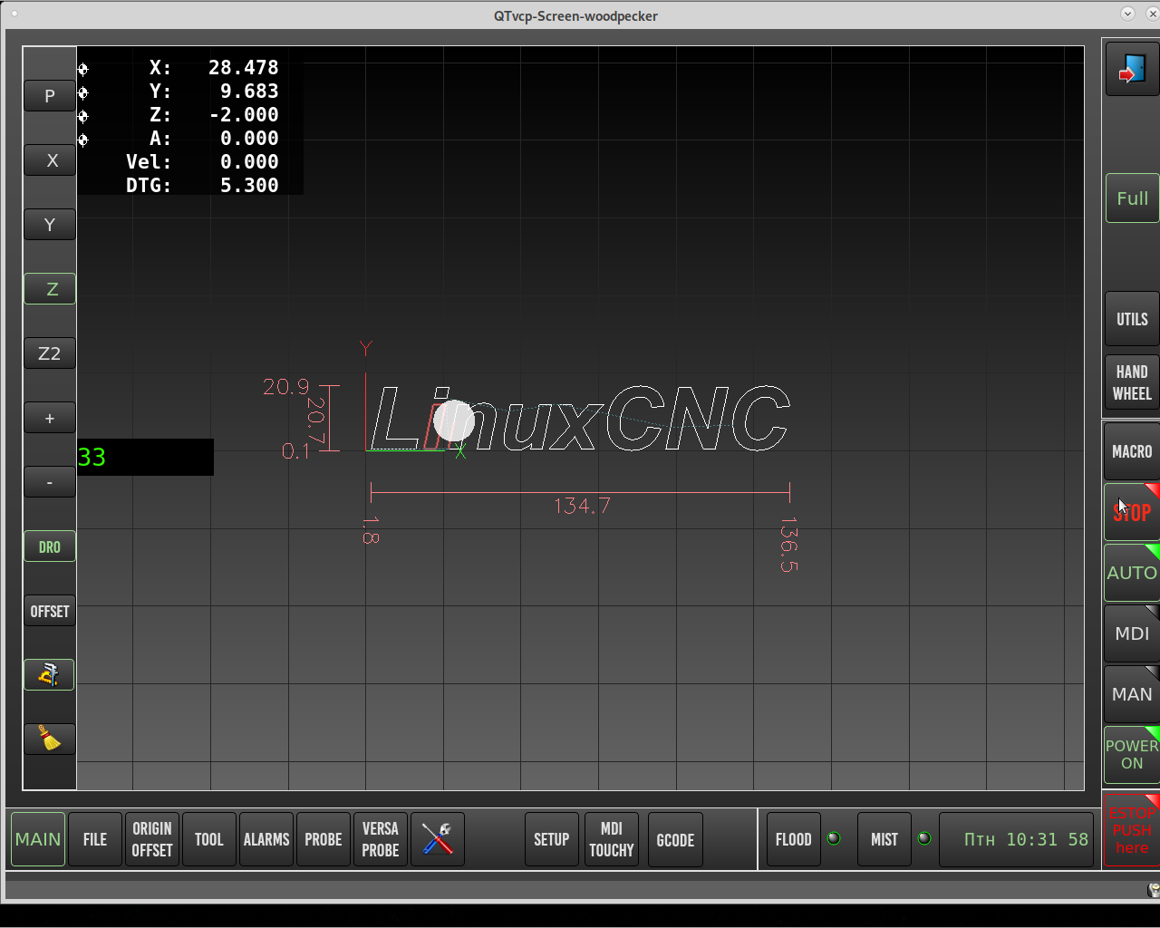

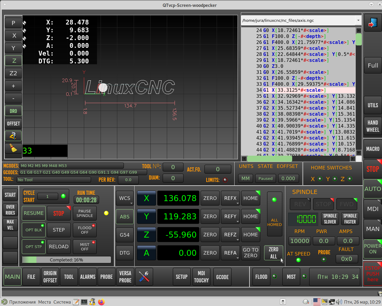

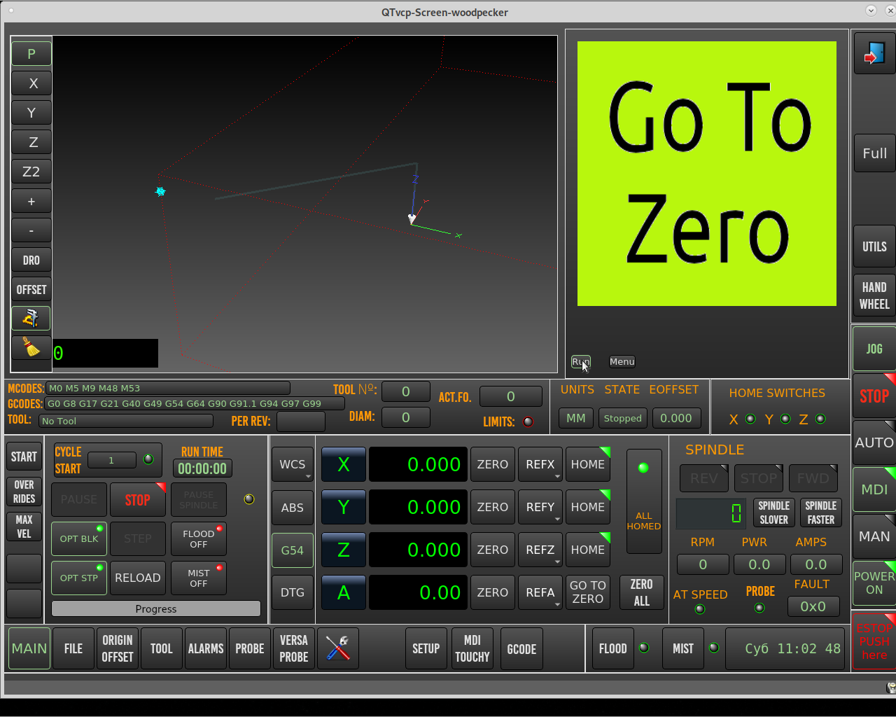

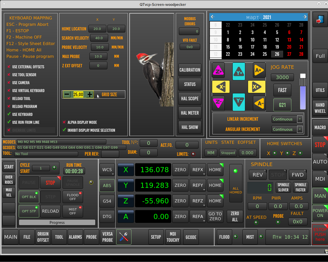

For creative people using woodpecker in linuxcnc 2.9. You can contribute some changes for more convenience and functionality.

Replied by cmorley on topic Sample Qtvcp Screens
I think I would show the inbed DRO only when the graphics is in full screen mode.
The current line number could be added to that inbed display too - is it that important to know?

01 Apr 2021 16:23 - 01 Apr 2021 16:26 #204401
by hottabich
There is no better interface for working with a large file. If you add energy independent memory to the MESA board then it will be a bomb. Thank you for attention!!!
Replied by hottabich on topic Sample Qtvcp Screens
That's right, this is true for full screen mode. There is control over the process of the machine and, if necessary, there is a stop button. I also moved the Macro Tab widget for easy command execution Go To Zero, Go To Home, Go Home, Ato Tool Zero. Nostalgia for MACH3. It is convenient for me and can anyone wants for himself. On Linuxcnc, I am sorely missing Close File. And so everything is fine, especially QtVcp.I think I would show the inbed DRO only when the graphics is in full screen mode.
