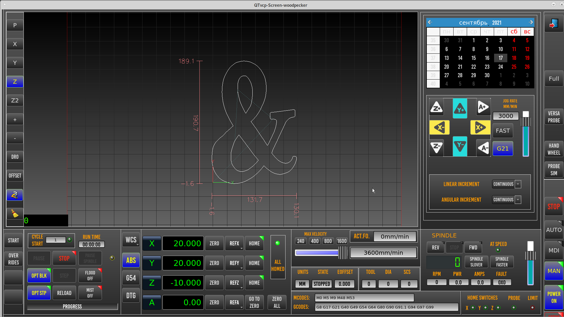

Linuxcnc2.8.2. Woodpecker (1920x1150). File updated 18.09.21.

Just out of curiosity, why did you decide to put a calendar on that gui?

Free place.Just out of curiosity, why did you decide to put a calendar on that gui?

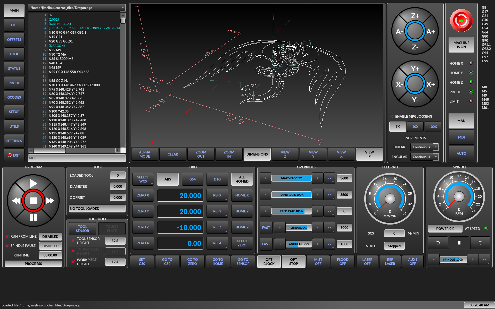

The latest version of QtDragon_hd. Main differences are:
- added joypad widgets for jogging and program control
- support for an MPG
- replaced override sliders with adjustment bars
- new stylesheet
- several operational improvements
If you want to check it out, all the files are at github.com/persei802/QtDragon_hd
Ignore the blank space at the bottom of the screenshot. That's because my laptop has a UHD screen.

I just tried but it gives me the error attached in the file .. the system is buster 2.9 master and works with the basic qtdragon_hd version except the probe part. Thanks in advance

AttributeError: HandlerClass instance has no attribute 'pgm_control'
Do you have joypad.py in the qtdragon folder?
You must also have the __init__.py because that makes python think it's a library.
Jim
Jim

yes the files are there .. I downloaded the folder from github (the link you put)
_init_.py is empty

I think I know the problem. I pushed a fixed handler to the repo. Thanks for finding this bug.
