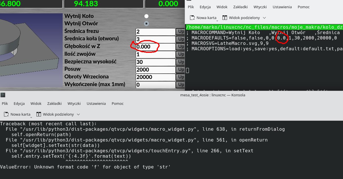

Hi Cmorley
I like the MacroTab Widget, you can easily make your own simple macros, but I think it needs some fixes.
I can save the current parameters to a file, but there is a problem with restoring the settings from the file.
The "set_style" function also does not work. I tried to fix it, but so far without success.
Could you look at this problem?

16 May 2025 17:47 #328586
by MarkoPolo
Replied by MarkoPolo on topic Error in tool_offsetview.py
It's almost good.
Setting the style in the qtdragon file is quite sufficient.
Restoring settings from the file works well, but only if they are integers.
If it's a floating-point number, then an error appears as in the screenshot.
Another problem (request, proposal) is the "RadioButton" element. It works like a switch and in some macros this is the desired behavior, but in others it is not.
If I want more items to check a logical condition, then there is a problem. That's why a new "CheckBox" element would be useful.

16 May 2025 21:12 #328593
Replied by cmorley on topic Error in tool_offsetview.py
Ok fixed floating point problem.
added new default commands:
for a radio button (with exclusive behavior)
radiotrue
radiofalse
for a checkbox (independent):
checktrue
checkfalse
true and false now will show a checkable pushbutton
Chris

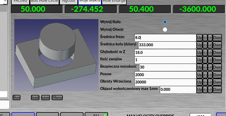

- MarkoPolo
- Posts: 319
- Thank you received: 90
17 May 2025 00:58 #328604
by MarkoPolo
Great.
Everything works fine, that's what I wanted. Thanks a lot.
It would be good to update the documentation, because old ngc files with "MACRODEFAULTS=true,false" settings will stop working for some users after updating "MacroTab".
Marek
Marek
