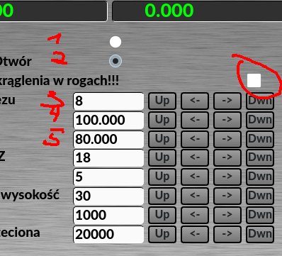

I noticed that after starting it doesn't load the 'true' state
in radiobuttons .
I modified this logic a bit and now it works:
rabiobutton with "radiotrue/true/radiofalse/false'
checkbox with 'checktrue/checkfalse'
What do you think about this?
in radiobuttons .

That would work.. I pushed something similar before your post.

I didn't fully understand it, but I've already tested your update, everything works fine.
