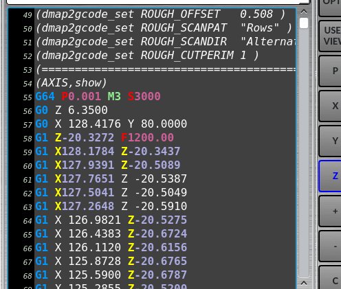

Hi Cmorley

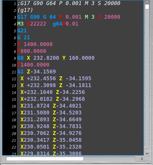

I made some adjustments to the brushed_metal_color file. Mainly to improve gcode readability (the white font was difficult to see).
If there's a space between the axis letter and the value in the gcode, the letter and value colors aren't applied. Is it possible to fix this?

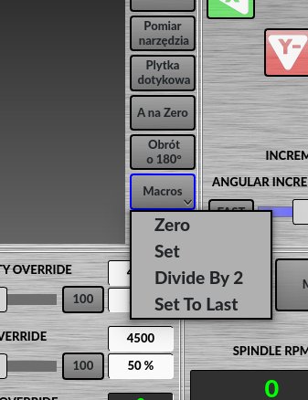

Another idea and suggestion. I'd like the macro button (the last, first, or maybe all buttons) to have a drop-down menu so I can easily add more macros within easy reach. Something similar to the screenshot.

Replied by cmorley on topic Error in tool_offsetview.py
I updated the brushed metal - thanks.
Fixed gcode with space - there is still room for improvement but I find the 'regular expression' code difficult.
Working on the macro buttons - close:

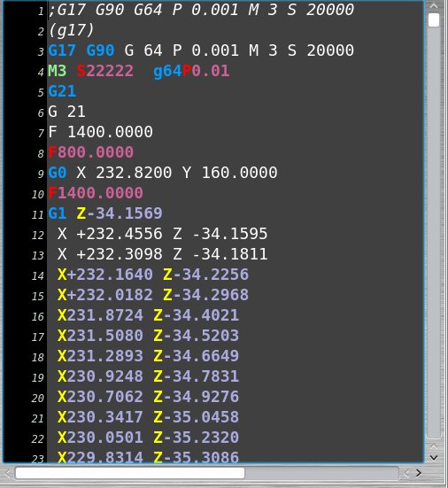

02 Oct 2025 16:36 #335731
by MarkoPolo
Replied by MarkoPolo on topic Error in tool_offsetview.py
I made some adjustments to the regular expressions, and it seems to be displaying colors correctly now.
Check if everything is OK.

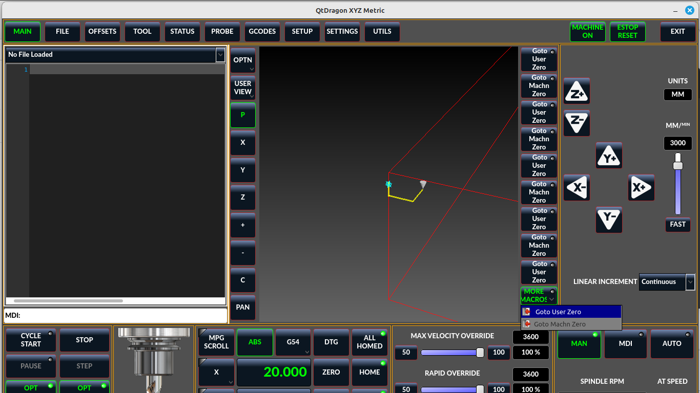

03 Oct 2025 05:26 #335759
Ok I pushed the more then 10 macros work. Let me know what you think.

03 Oct 2025 14:39 #335785
by MarkoPolo
Great, that's exactly what I was looking for.
It works well, but two things could be improved:
1. If I press a macro button a second time that doesn't do anything because it's already executed, e.g., "Goto Machin Zero," the LED doesn't go out; it keeps blinking. It blinks until another macro does something.
2. Button 10 has a hardcoded name of "MORE MACROS." It would be nice if it also took its name from the ini file like the other buttons.

06 Oct 2025 05:33 #335895
I think I pushed a fix for the leds staying on problem - at least in the tests I did it worked.
The label is a bit harder to fix satisfactorily. It's now at least translatable.
