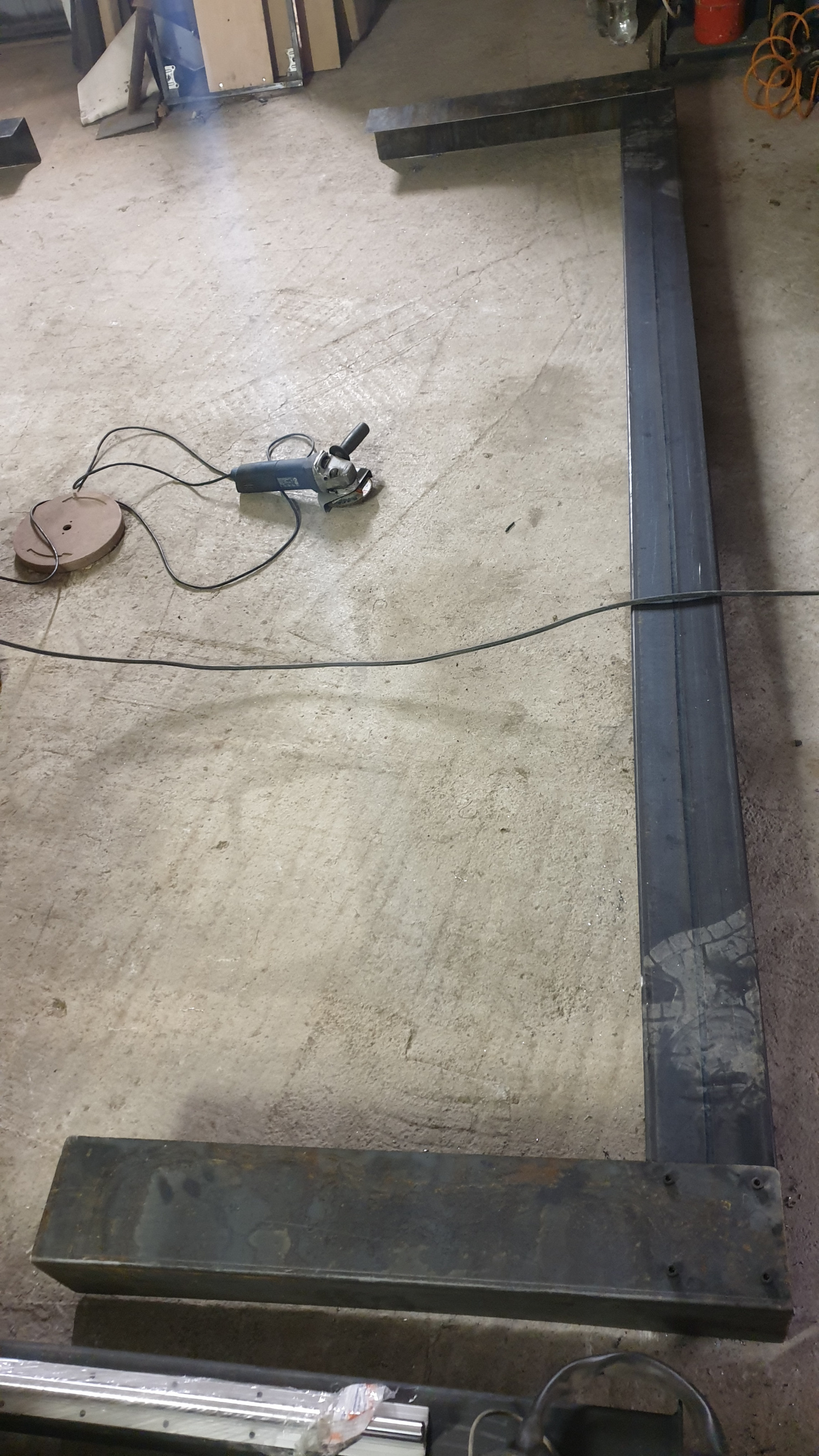

Had to make a tough decision in this case decide to endure a lot of pain and suffering trying to build a single 6X2m machine in my cramped workshop, or cut the rails and do one 3X2m and one 2.5X1.5m.
There was no space to mount the 6x2m frame, no matter how i looked at it as that ends up in the 7X2.5m outside dimensions. It was a hard decision for sure, and it will hurt even more when cutting the rails that took so long to get here. Never mind, enough mopping, move on to the build, or lack of in this case....

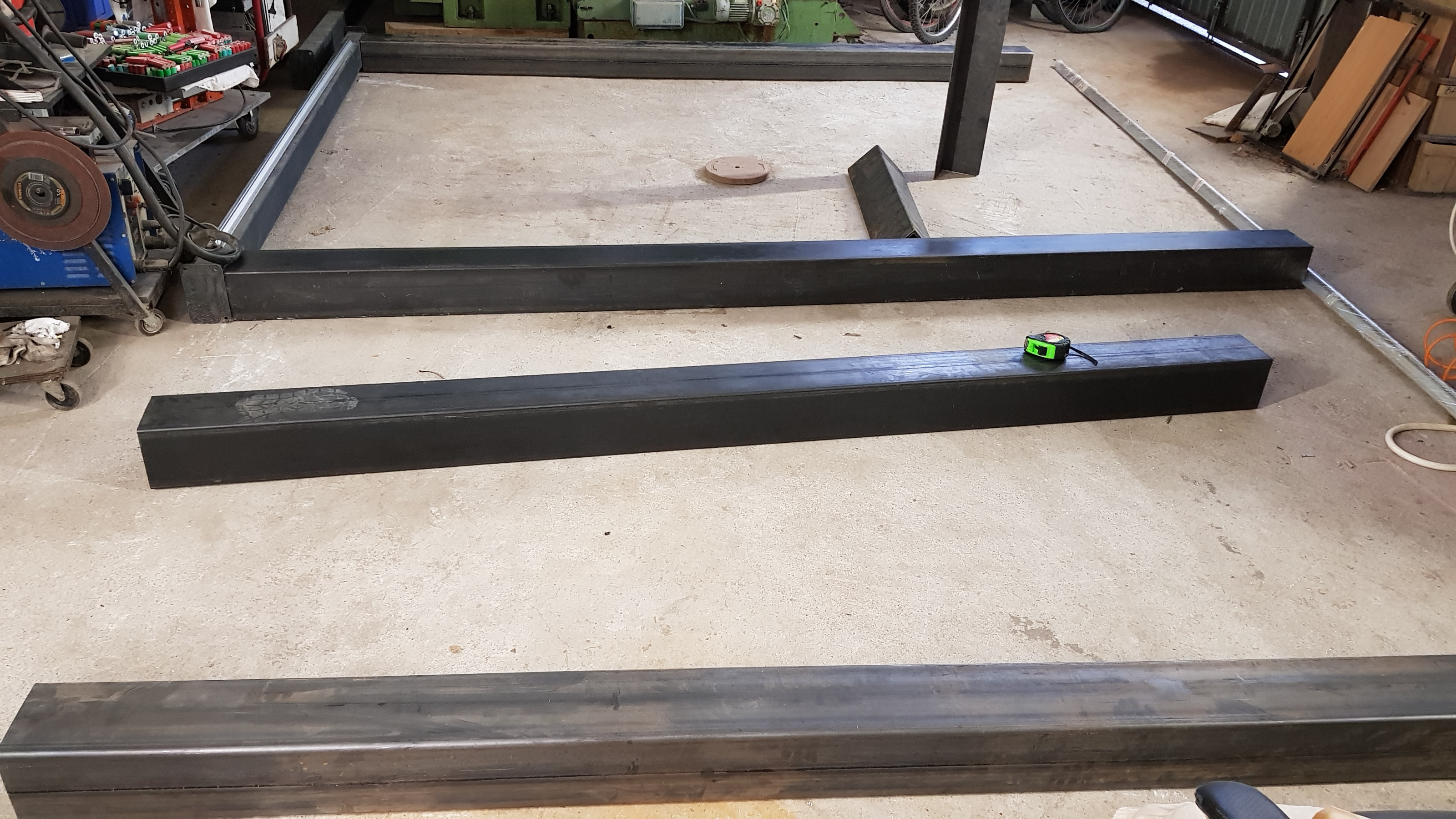

So far i have the outer beams from 150X150X4mm profile and 300X900X4mm sheets bent at 90 degrees to use as legs, here is a pitiful picture of all that on the workshop floor:

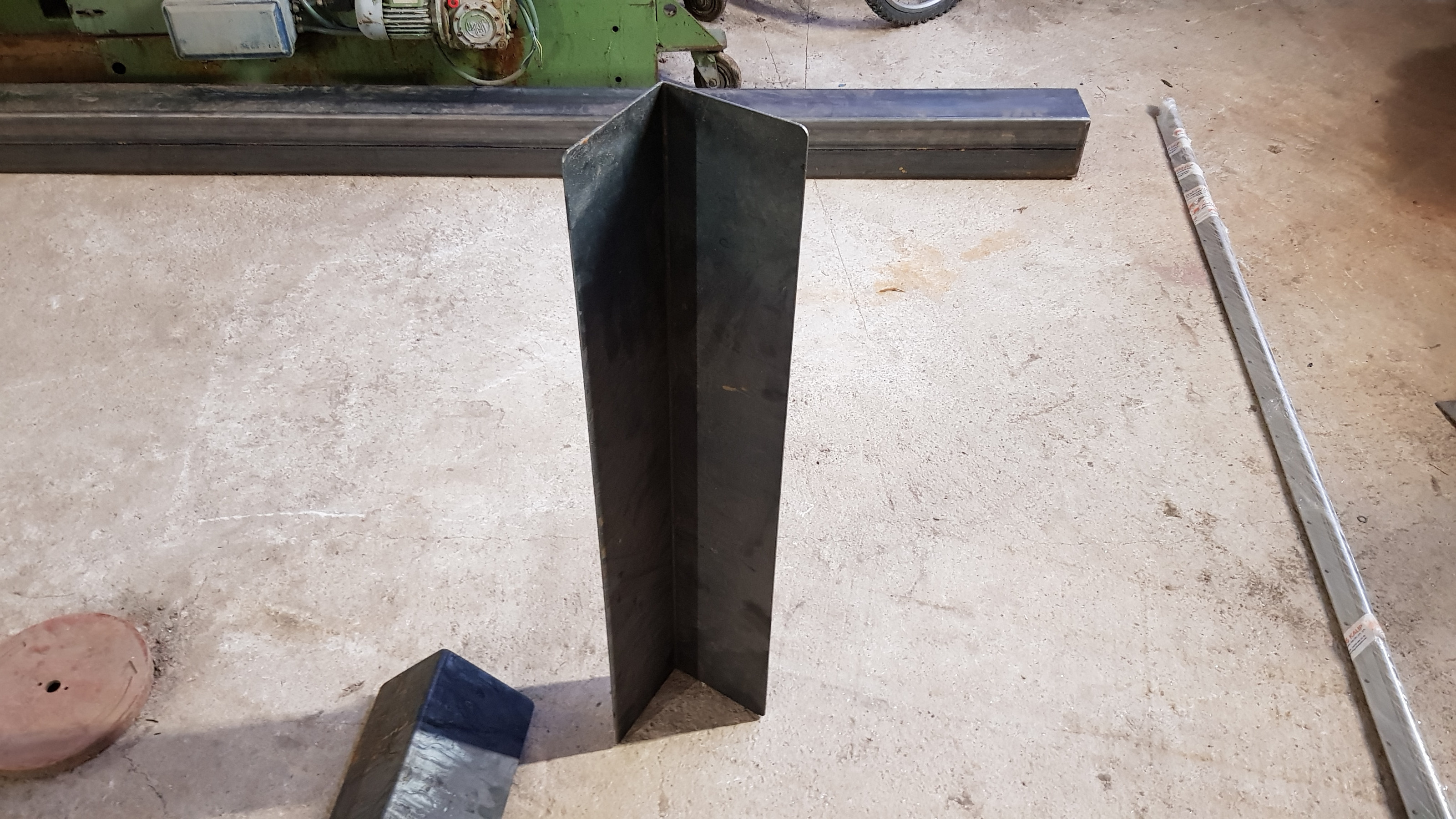

And here are the legs made out of sheets:
Those will be bolted to the sides of the beams so they will also cover the openings.

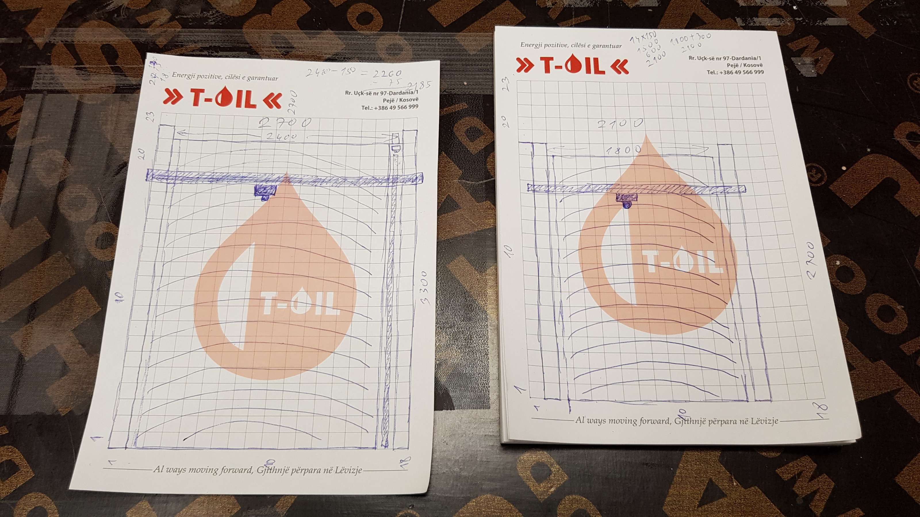

As a bonus, here are some scribbles i made yesterday while sipping "double choka mocca" in the shop, leaving the explanation of them to future generations of archeologists !

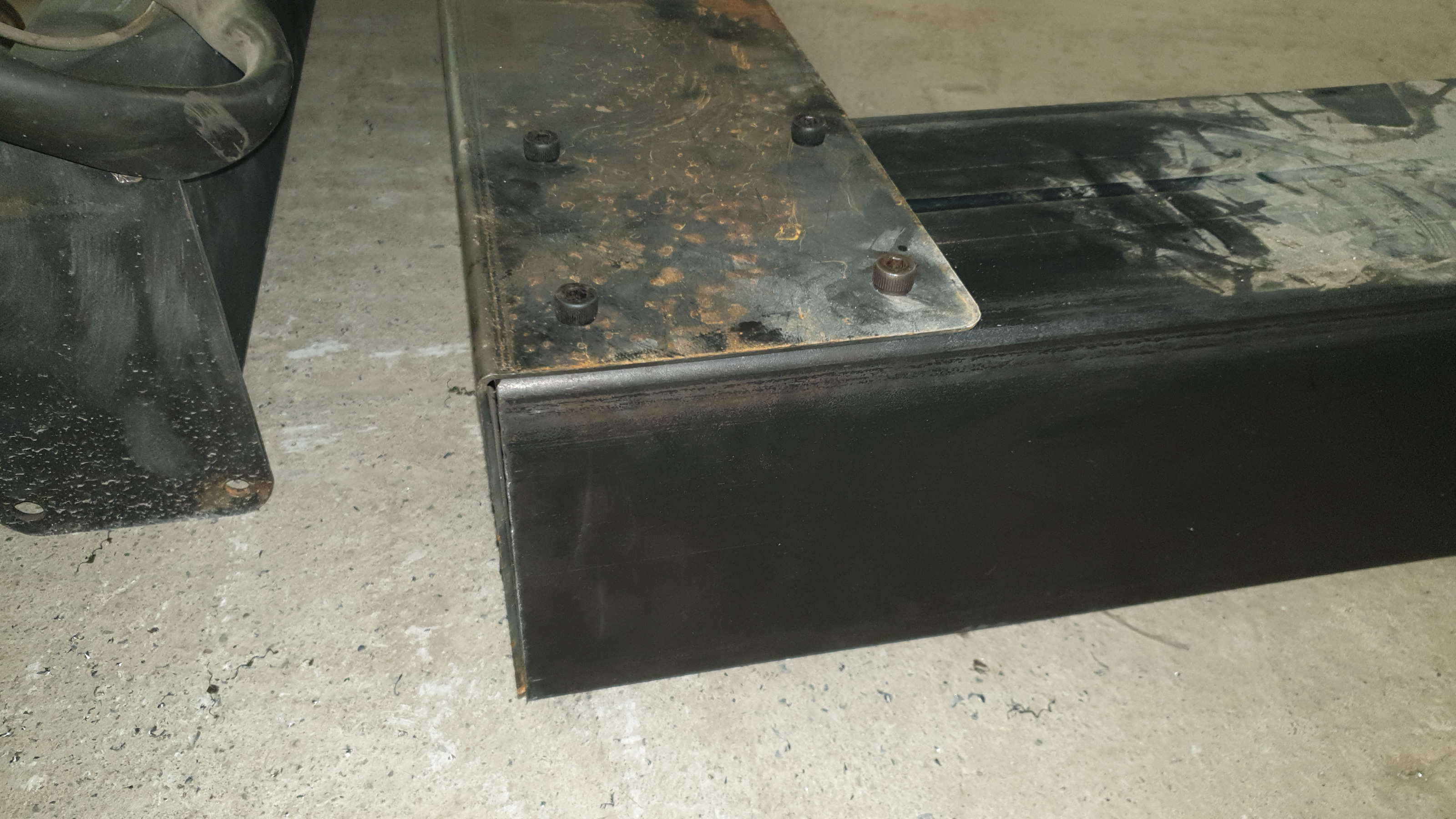

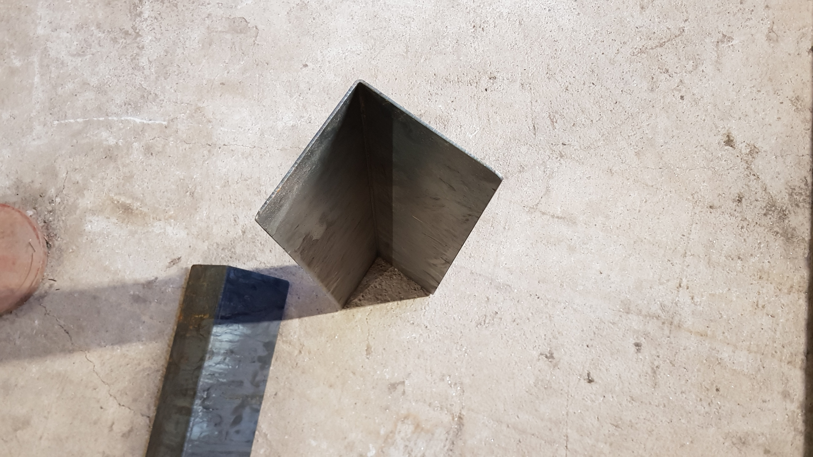

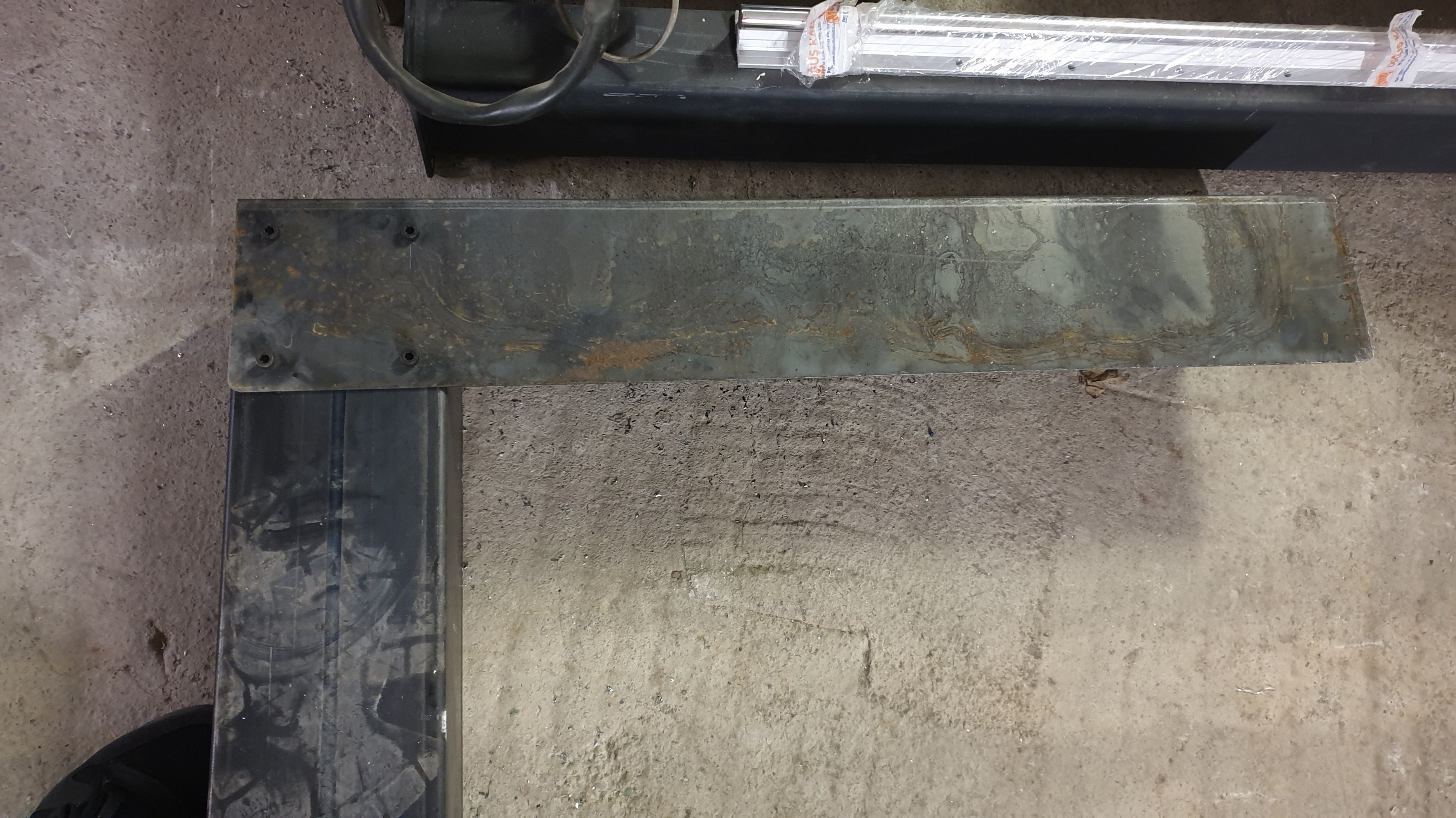

Here is a snippet of a brain fart i had some days ago while i was staring at those 150x150 profiles and wondering how to make the legs and cover the openings on both sides, that is when the L shaped plate was inception-ed and here is the result of that:
Here is one side :
And here are both sides mounted:
Notice the small gap on the part that is covering the opening of the 150x150mm profile, the L was shaped over 90 degrees so i had trouble getting it that close. Beating it with a hammer was not an option, no matter how much i would have enjoyed it !
Since this has proven usable, looks good, saved a lot of work in welding/cleaning the openings, is easy to dismantle and assemble, i am going to order 4 more of those L shapes fro the second machine.
The SBR30 rails are going to be mounted on the underside of the 150x150mm, the outer side of the machine, that way they will be covered from dust and water. It would have been much easier to mount them above, but i fear some less coordinated person working with it might drop a 500Kg plate on the rails, rendering the machine useless and warranting a 400 euro replacement.

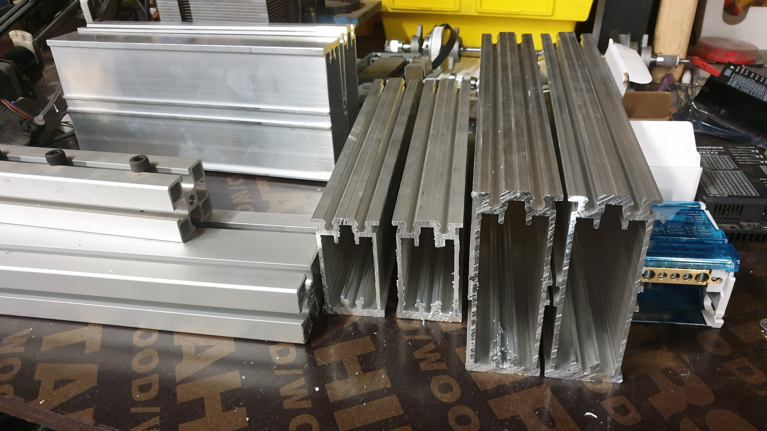

Also got some pieces of Alu profiles that i am hoping to use for the gantry, two dimensions, 84x44 and 124x44 outer dimensions, 4mm walls on the sides, 6mm above and below or the narrow sides. Looking into mounting the reduction and belt tension inside them completely so only the motor can be seen from the outside.
Complicating things to the MAX !
Here is one side :

since beating with a hammer was no option you jumped on it! proof of footprints

LOL, not a good criminal, leaving footprints all over the place !since beating with a hammer was no option you jumped on it! proof of footprints

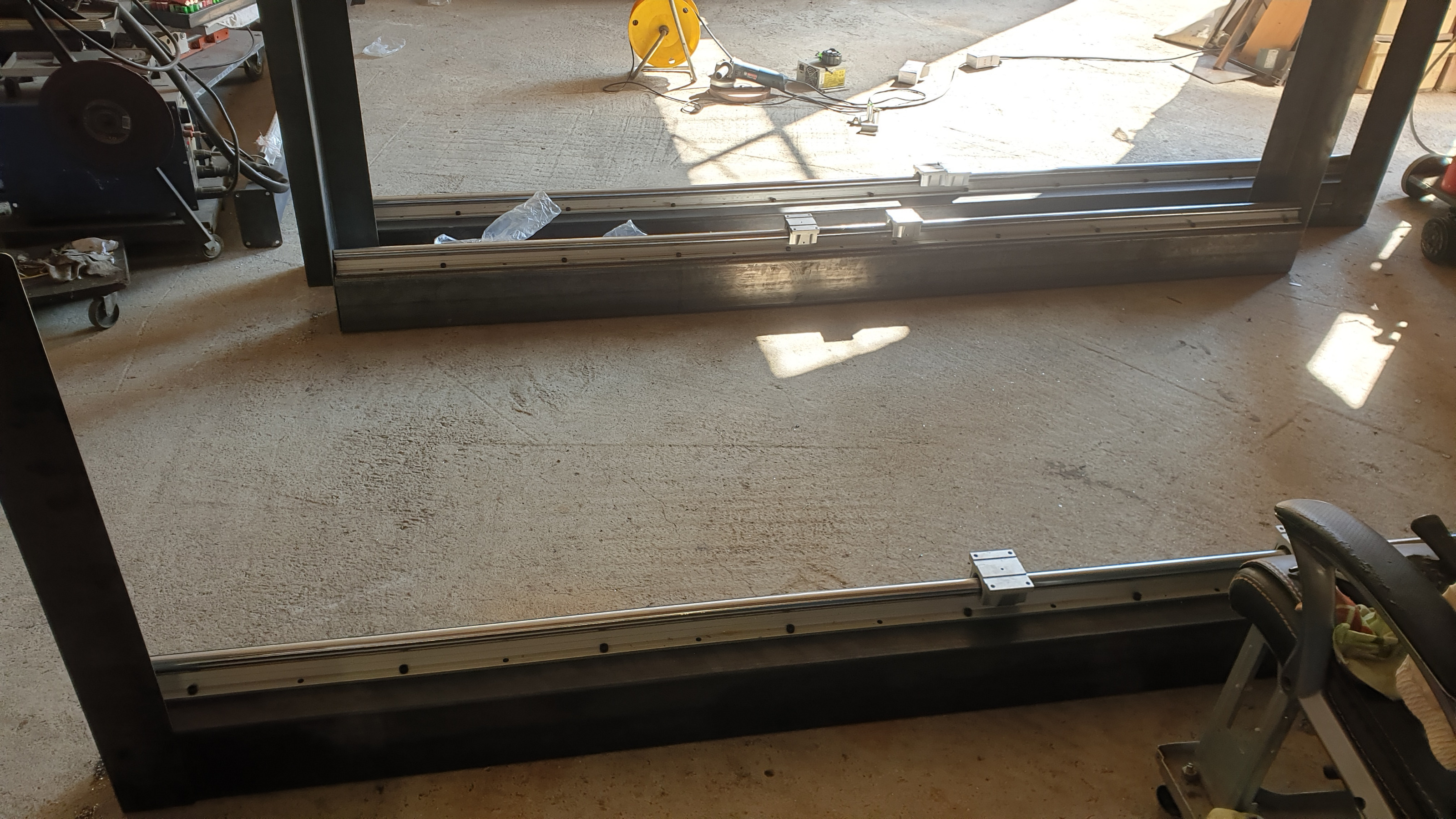

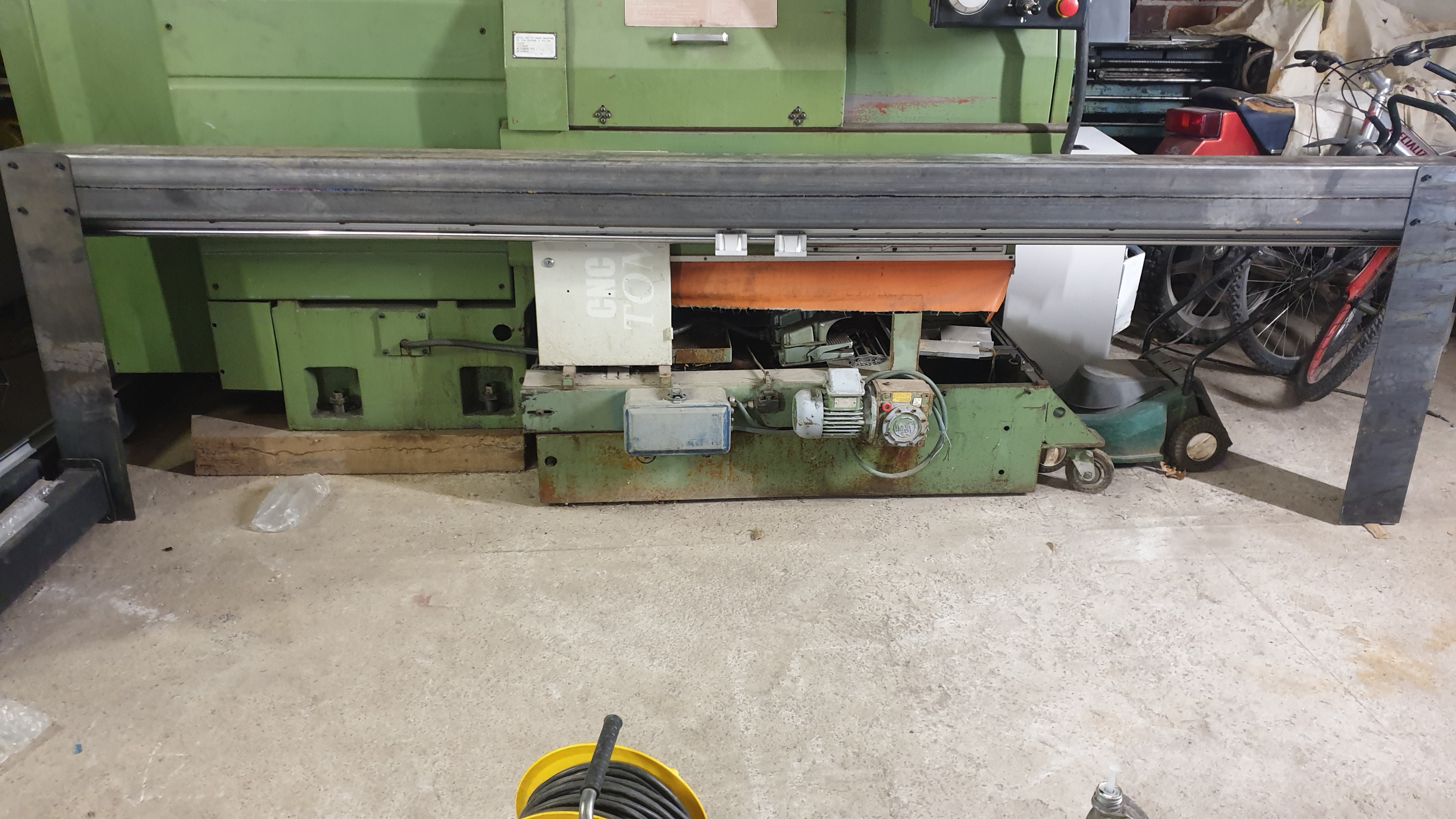

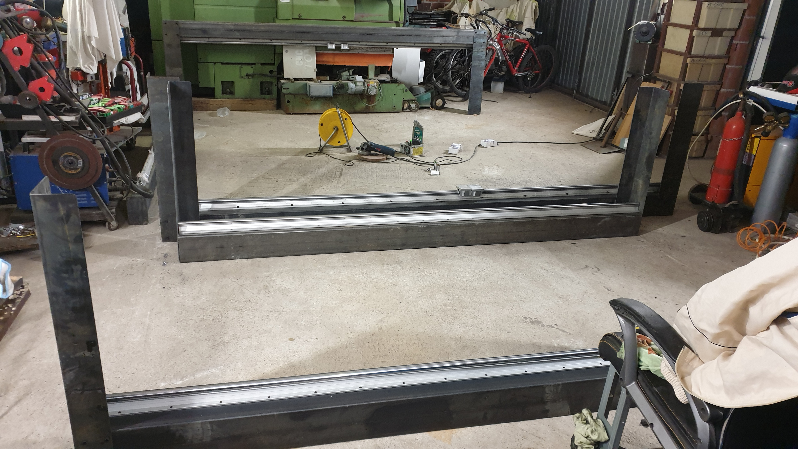

Some progress made and some pictures:
All side "L" mounted, rails cut to size for the small one (model T1525, 1.5X2.5M) and test fitted, the rails on the big one are already bolted in.
All rails will be bolted in a zig-zag pattern, just in case i might need to move them to a different mounting place, there will be a lot of things "hidden" under there, that will take a lot of "measure once, cut twice" building technique implementation. Also notice the SAE90 oil dripping all over from the carriages, i am sure that they will never get oiled again after they go out of this shop.
This is one of the sides with rails attached and in "normal" orientation, all the others are still upside down.
All the rails and carriages in place, for now,
Some aluminum parts that will become "uprights" , but having some issue with hiding the motors and reduction and belt drive in there, not much space anywhere when all the stuff gets added and i am trying to hide everything so it looks "neat" from the outside.

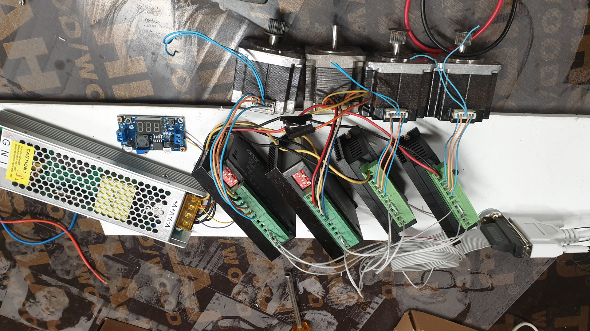

Already assembled the test electronics and motors, not using the expensive stuff until this gets back from powder coating and gets assembled again. I used to use the new stuff while building, by the end it was not new anymore, so now i use old stuff for fitting and testing. China drives, Japan motors and a 24V/16.5A power supply, needs 2 more relays to be added.
