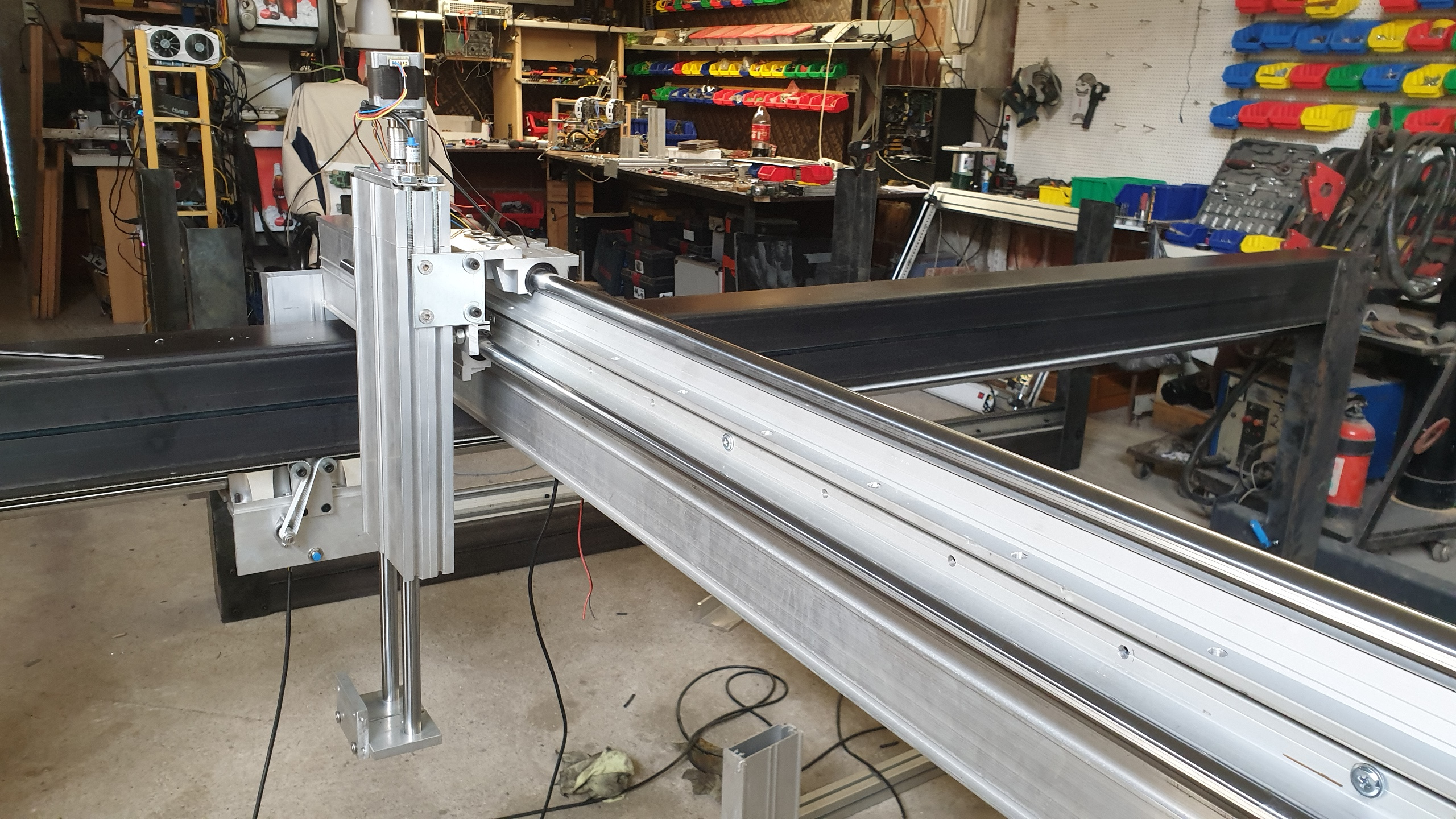

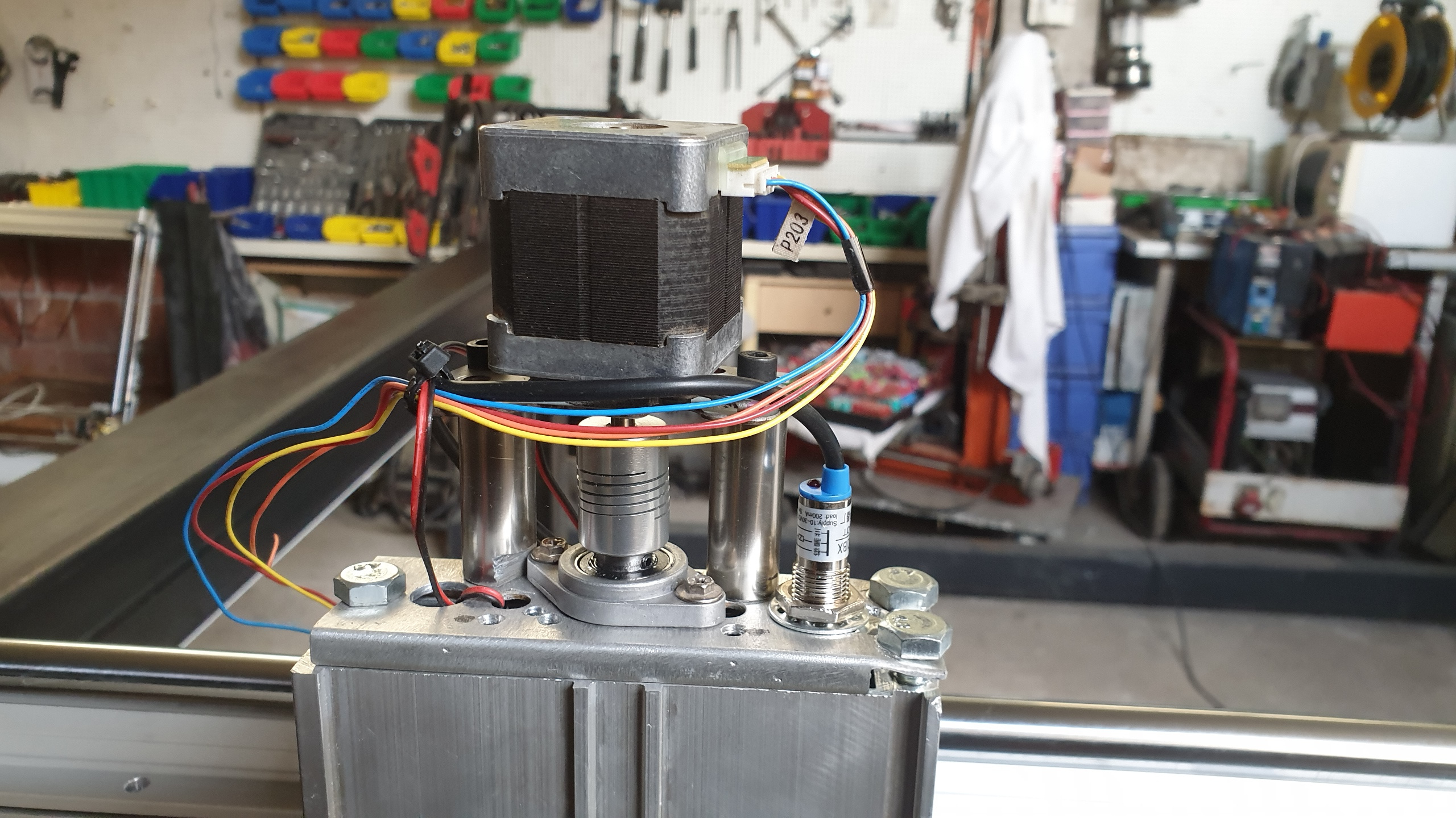

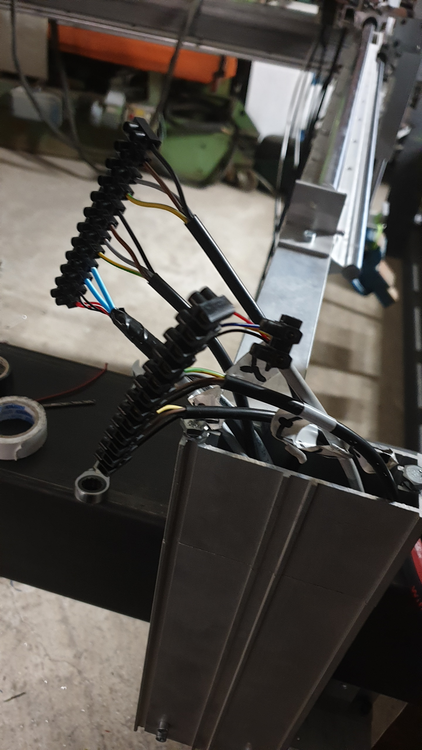

07 May 2020 11:01 #166956
Replied by tommylight on topic 2+2+3 More Plasma builds, double the joy ! 3X2M and 2.5X1.5M cnc plasma build.
Z axis mounted in place, now to add motion to X axis and ...... wait for the cable management ! Will have to do something temporarily, and i know there is not solution more permanent that a temporary solution, but hell i hate waiting.
Here are some more pics:
That is the Z axis home sensor and there is another switch inside for probing or floating switch.
The following user(s) said Thank You: phillc54, CNCFred

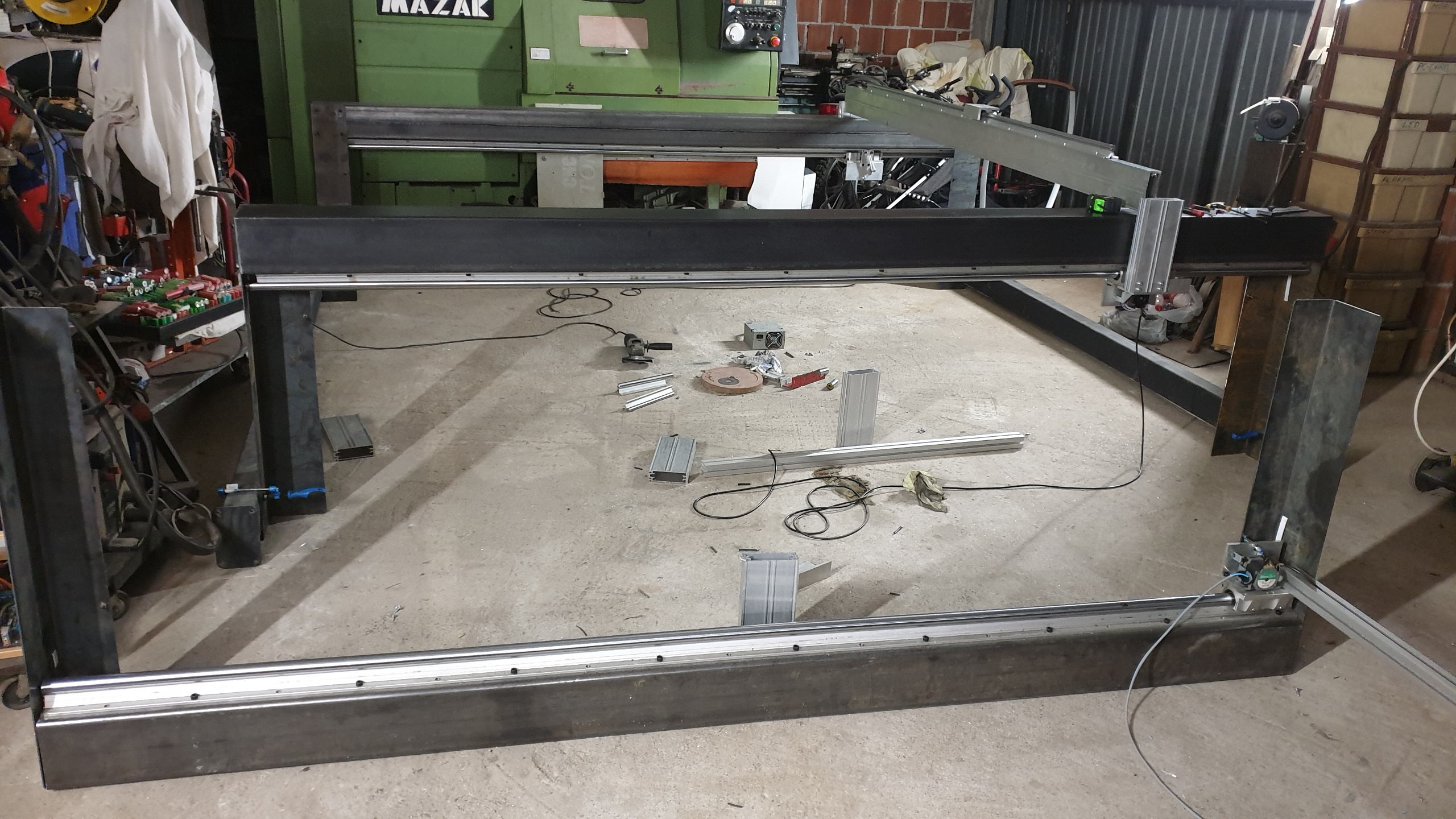

08 May 2020 18:43 #167070

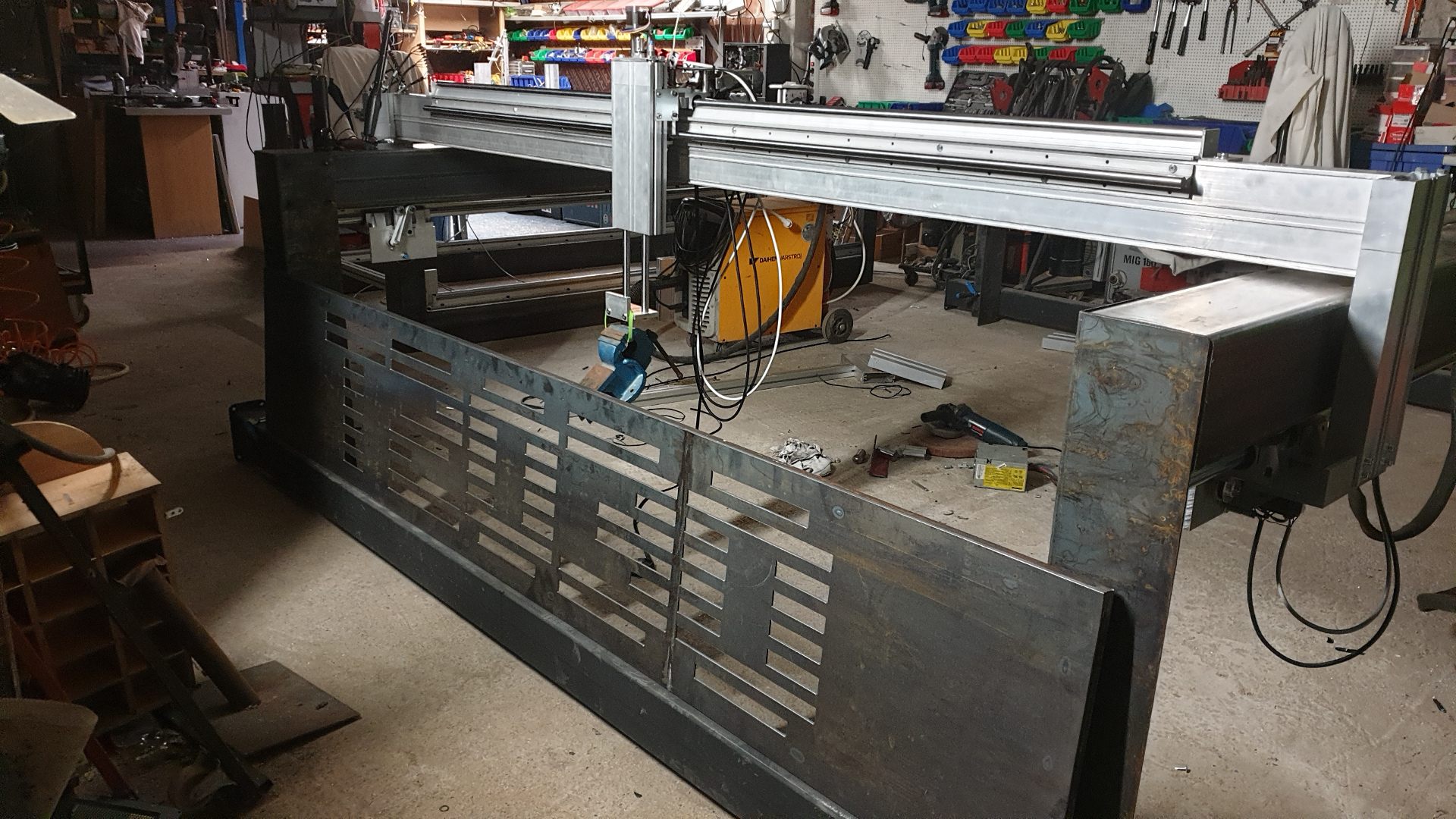

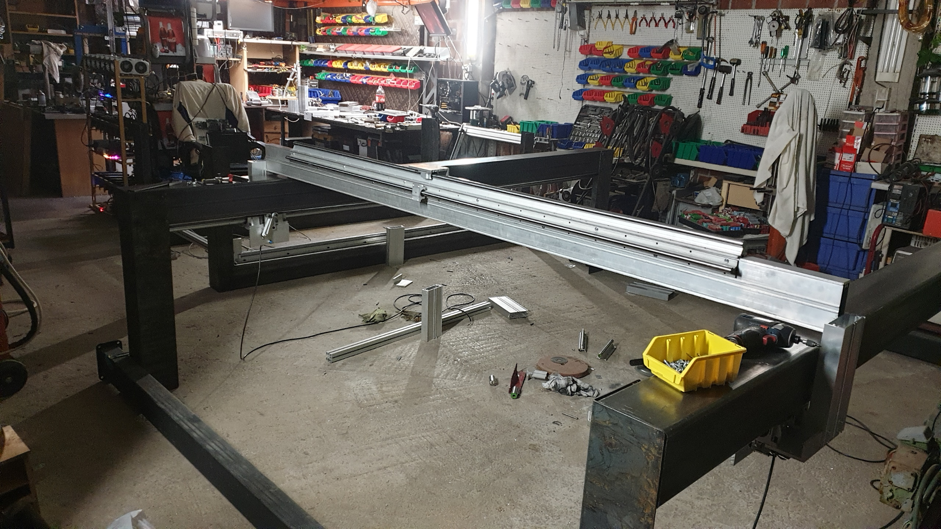

09 May 2020 21:38 #167179
Another quick update, the big one is nearing it's finish, needs back and side panels to be made and bolted then disassembled and sent to paint. Unfortunately no powder coating as the only colours i can choose from are black, white and some dark grey. I want none of that !
I also need to do something about the electronics enclosure, the only ones i can find here are the plain Gray ones for electrical installations at 105 Euro a piece, and i have one of those but it is a shame to put that on these machines.
Here is a quick video of it cutting air at 36m/m and rapids at 48m/m, although it can do 58 on Y axis and 66 on X axis without ever stalling. When i tighten everything up i might do another "casually hanging on the gantry" video, so stay tuned for more.
Here is the video, enjoy.
