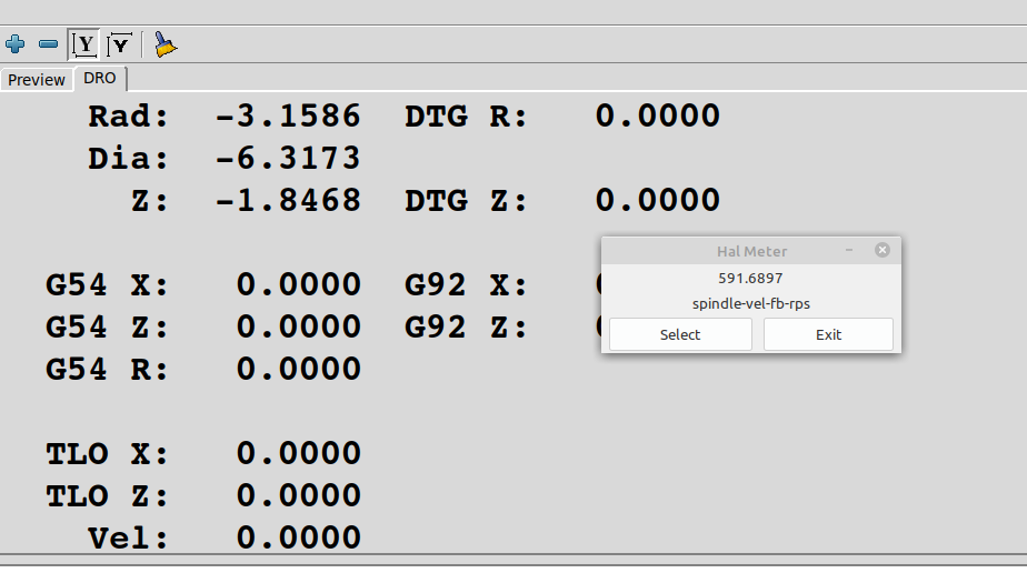

I think I am to a spot where I could use some help getting spindle speed working for threading operations.
Attached is my current hal and ini config files along with a screen shot of what I am seeing in the GUI.
I assume when things are right my GUI DRO Vel will show the actual spindle speed in (RPM?).
I bought a cheap tach to measure the actual spindle speed.
Setting the manual spindle speed control dial on the lathe speed control to ~30.0Hz, I am getting ~592 RPM at that setting.
I played around with the ENCODER_SCALE setting to get where I am at.
The screen shot of the hal meter shows the spindle-vet-fb-rps bouncing around 591.
A little math issue RPM to RPS but I am not sure why I am not seeing some value for spindle-vet-fb-rpm.
Any help is always appreciated.

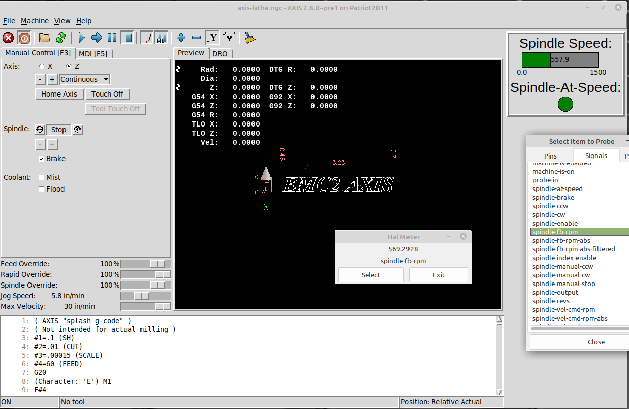

Got things a bit closer to the quest to do threading with the lathe.
Attached is the latest screen shot with RPMs showing.
Off to figure out how to get BobCad post processor to create gcode that linuxCNC appreciates using for thread operations.

Note that LinuxCNC does not use the spindle.0.speed-in pin for threading, it slaves the Z axis to spindle.0.revs
You will not be able to thread until you link the spindle.0.index-enable pin to the encoder index-enable.
Rather than persuade Bob CAD to thread for you, consider using G76 in the MDI window. It's a single line of G-code.
The only wrinkle is that you need to position the tool in the right place relative to the work first, as many of the parameters are relative to the starting position.

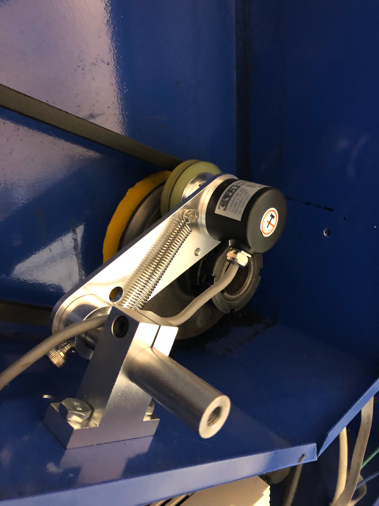

You might have been better off keeping the single pulse, LinuxCNC can work with that (about as well as Mach, ie not very)
Your current arrangement would probably work if you used an index pulse from the spindle rather than from the encoder.
But best would be to swap the friction-wheel for a toothed-belt.
(This might be a good application for a 3-d printed toothed belt)
Is there a spacer on the end of the spindle that could be replaced by a timing pulley?
Here is one I made earlier

Now using LinuxCNC with an encoder what kind of trouble have I created using an encoder that is spinning off the lathe shaft relying on no slipping and perfect timing.

I'd like to keep the back part of the lathe shaft open to turn long stock and not have to cut it all the time.
To do that I need to find a pulley for the shaft that is ~2.25" in diameter. Then I can cut it like you did there and sleeve the lock rings that are on the end of the shaft.
So far google is not digging up pulleys that large with something like an 8mm belt.
I'll keep looking around.
