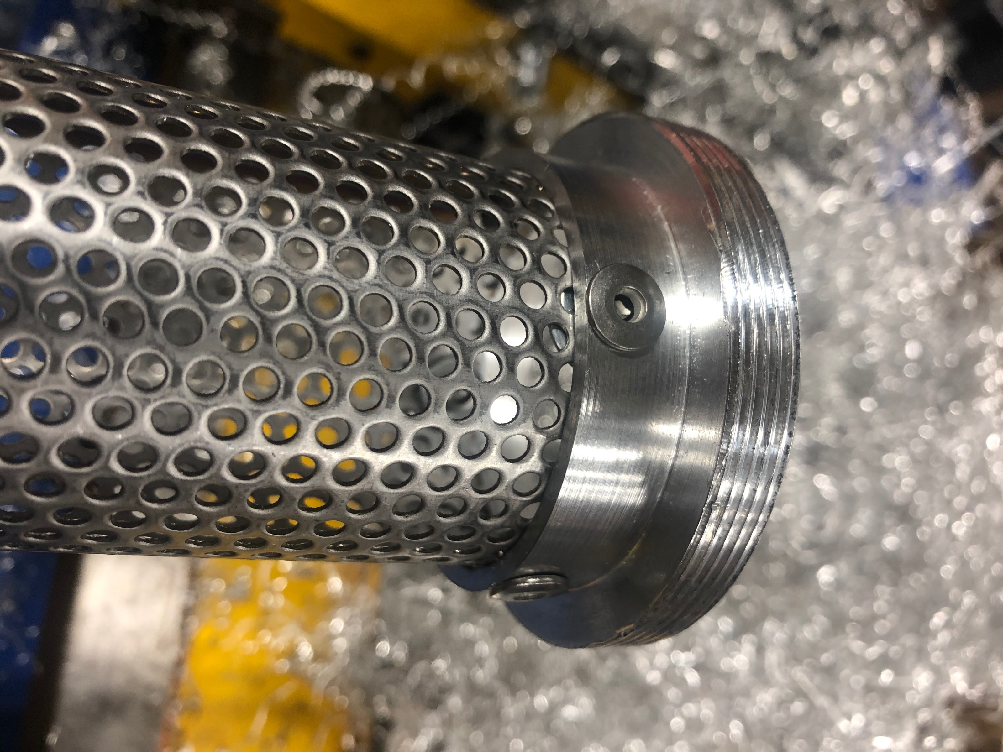

25 May 2021 00:04 #210153 by rdeeming
Replied by rdeeming on topic Mach3 -> Camtronics -> Parallel P Replacement
Got threading good enough to do what I need. Thank you everyone for the help getting here.
Thread Cut Video

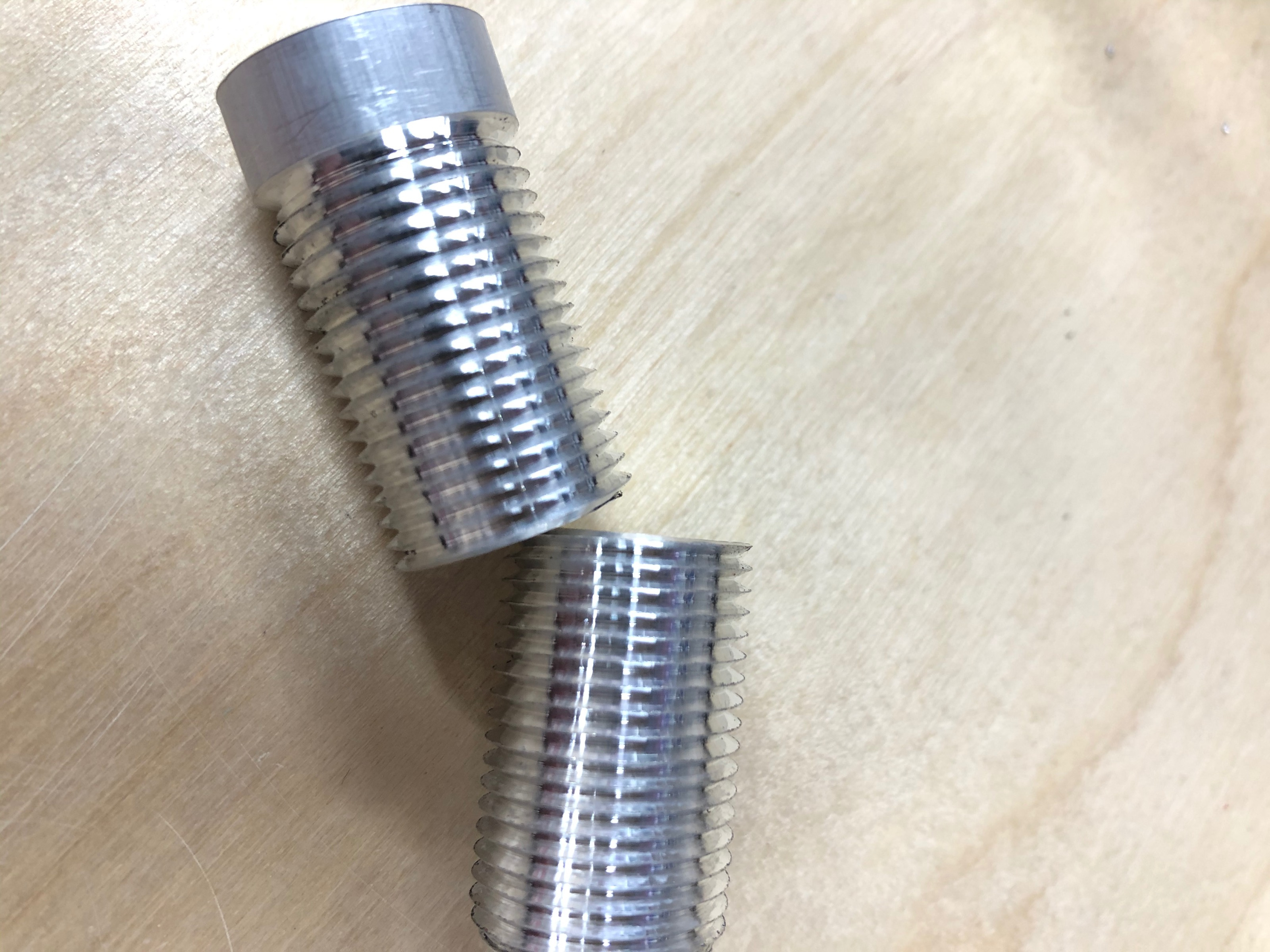

25 May 2021 00:35 #210164 by andypugh
Replied by andypugh on topic Mach3 -> Camtronics -> Parallel P Replacement
Changed to public
Nice.
Now is about the time you are likely to find that threads (to a standard) are harder than they appear. ISO metric and SAE threads have a significant flat on the threads, taking them p/6 smaller than nominal. Whitworth and ISO pipe threads have a rounding that does the same, but is harder to machine.
If you are trying to fit to an existing part, don't keep reducing the diameter of a pointed thread until it fits. If you do then the root and thread thickness will be under. Draw your thread and touch-off the tool to get the major and minor diameters right with the actual tool.
25 May 2021 00:47 #210170 by rdeeming
ok thank you for the heads up and info. so far I was cutting my mess to my own bad mess of threads and not matching other than initially using a die as a sanity/learning check to first fix my numbers and then figure out how much slop I needed to add to get the die to roll ok.
