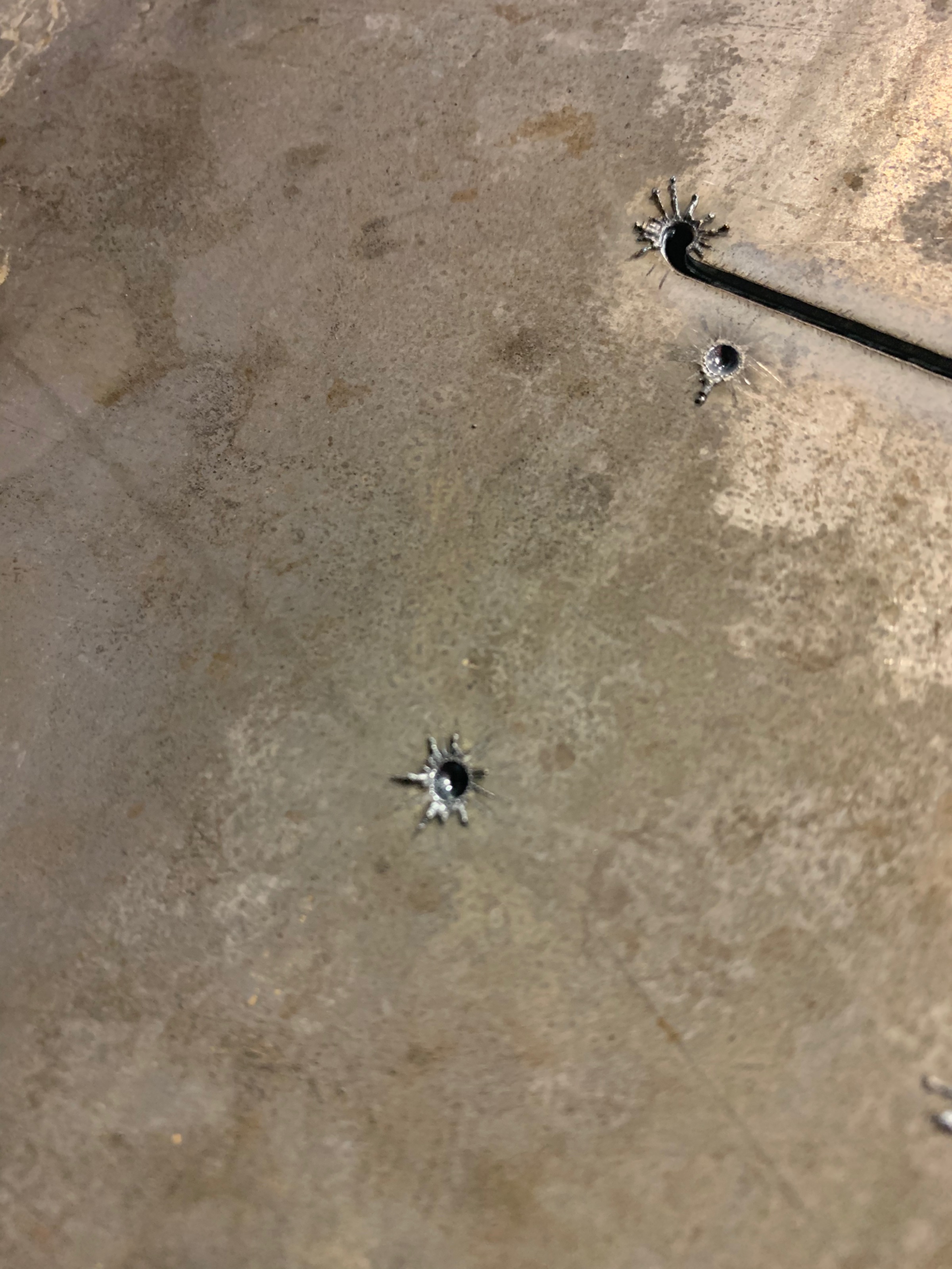

Did have some luck tonight getting spotting to work.
I followed some instructions from arclightdynamics on youtube, they did a clip called 'plasma center punch training video'. this made a little bit of sense to me for some reason, then coupled with your advice I'm getting somewhere now. Currently in the GUI I have 1V and 2ms. this is working and not punching through 1.2mm steel. I'll mess around with it some more tomorrow.

27 Dec 2021 07:00 #230065
by RNJFAB
Replied by RNJFAB on topic Homemade, cheap, plasma CNC
- Posts: 12176
- Thank you received: 4155
27 Dec 2021 11:58 #230070
Replied by rodw on topic Homemade, cheap, plasma CNC
Looks perfect! Time to move on to the next challenge!
Just watch that the torch voltage does not flicker over the 1 V threshold when its not cutting.

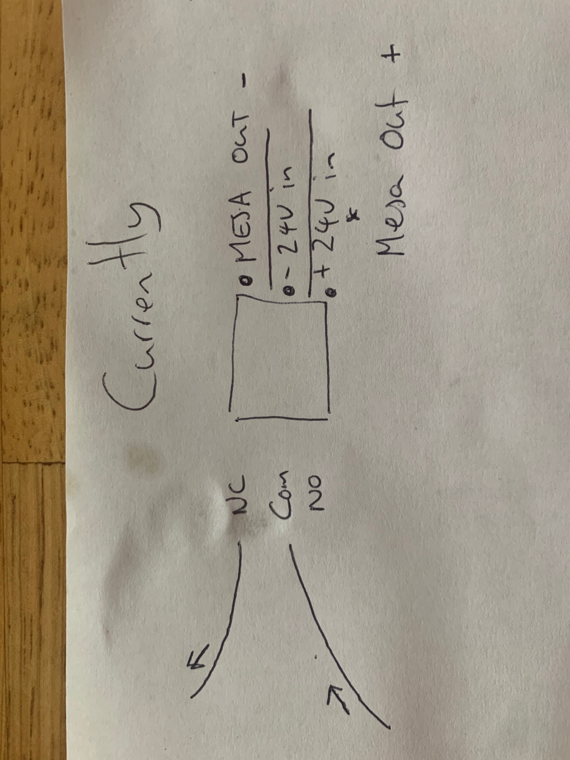

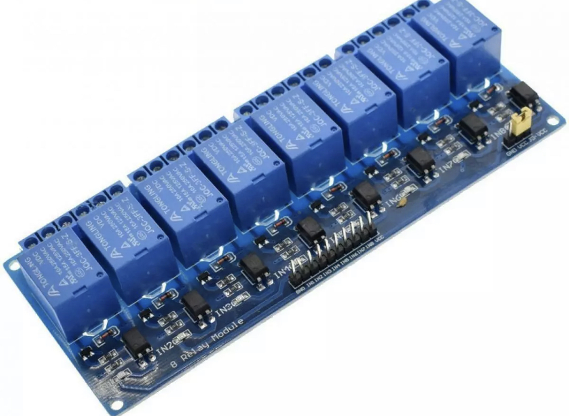

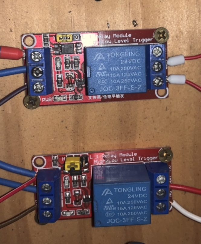

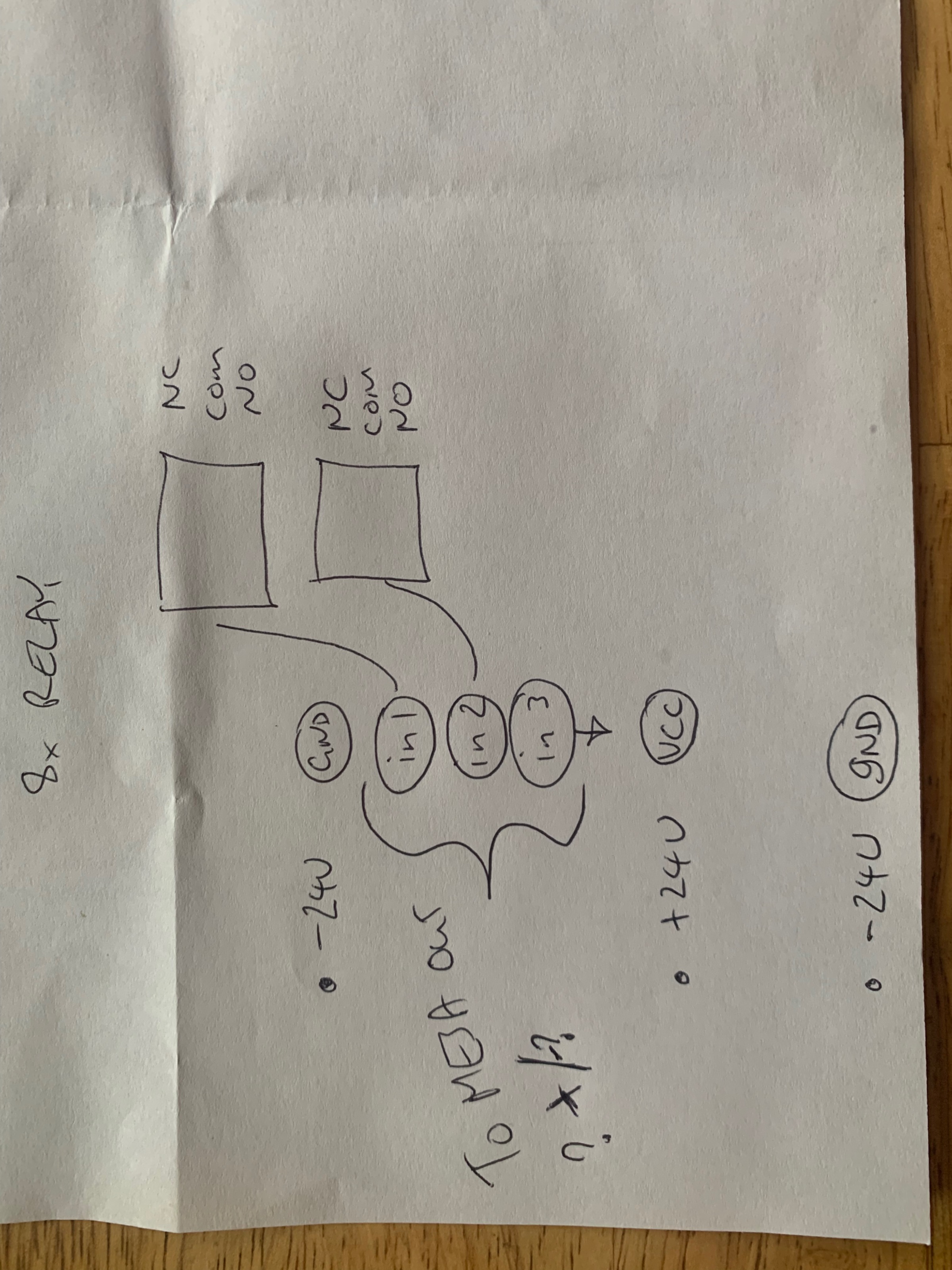

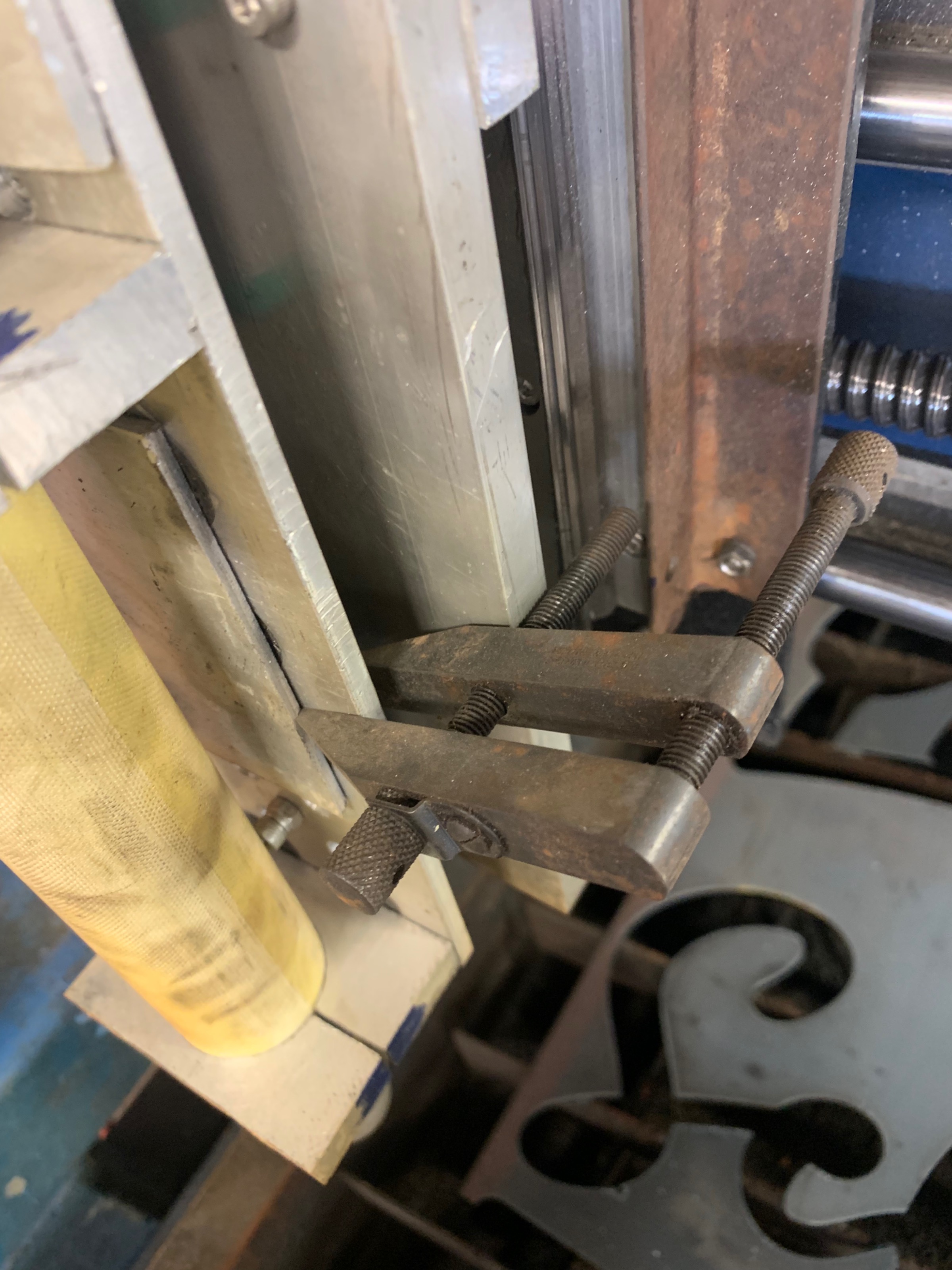

Next challenge is the torch mount properly, even with 10 'strong' magnets, it still breaks away too easily, and I don't have. micro switch on it yet to pause the machine when it does breakaway.
Also brains trust, I want to upgrade the 2 relay's I have to a set of 8. however I'm struggling to find a correct wiring diagram on getting it connected to the MESA board.
Pics to follow of current setup, new 8x relays, current wiring diagram. I need help on how to connect this all in properly, I'll also put up my attempt at connections.

31 Dec 2021 19:43 #230428
I found vicegrips solved this
Thanks Rod,

01 Jan 2022 00:16 - 01 Jan 2022 00:17 #230435
by RNJFAB
Last edit: 01 Jan 2022 00:17 by RNJFAB.
- Posts: 12176
01 Jan 2022 00:22 - 01 Jan 2022 00:23 #230436
So looks perfect to me!
Actually have found Linuxcnc so good, I don't even think a magnetic breakaway is required.
EDIT: Been thinking of drilling and tapping a hole to make it permanent!
Last edit: 01 Jan 2022 00:23 by rodw.
