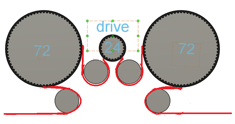

this is just a very crude picture of the belt route and gears for a linear reduction for open ended belts. the 72 tooth pulley's would just be a toothed idler pulley for the reduction and the idlers are for the omega configuration to route the belt out of the serpentine. the motor for the drive would just be mounted on the back side of a plate that holds everything in place.

Hmmmm something very wrong with that picture,
-if there is a single belt used and the red lines are also that belt, it will not reduce anything at all
-if there are more belts in use, again it just seems to much parts and effort for nothing
-if there is friction used somewhere (black belts only on pulleys???) again no use for two sets of everything

no the black is just a reference for the belt thickness i was not even going to try to draw teeth on everything. It was was just an idea and i will probably test it just because it gives me something to do
if nothing else you end up with a lot more surface contact engaged into the belt. Which i think is my man issue for a solution.
i look at things differently i had no idea how to model a arc tooth pulley before and now i do so i learned something
so if you learn something it's not a total loss.

The Bell-Everman drive is a nice system, but you need to put any reduction upstream/ahead of the pinion. As Tommy pointed out the 72T idlers won't reduce anything.
A low-backlash, helical gear reducer between the motor and the pinion is the way to go.
And if you've got the space for some extra carriage length, the 'Loop-track' system brom B-E is really nice.

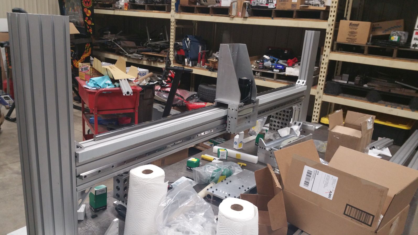

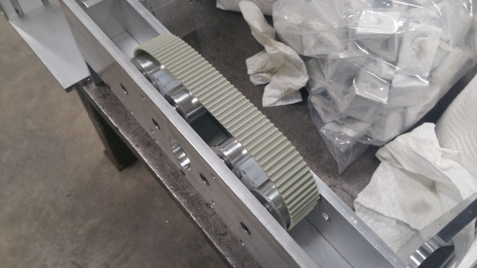

Like this one I built for a couple of plasma tables.
In these photos the motor is mocked up directly on the pinion, but we wound up using a 10:1 reducer between the motor and pinion.
Belt was T5, pinion was 15T (bought T5 15T bar stock). Mr. Everman pointed out on CNCZone years ago that only T-series belt teeth/valleys are symmetrical - HTD and GT2/GT3 have non-meshing teeth.
