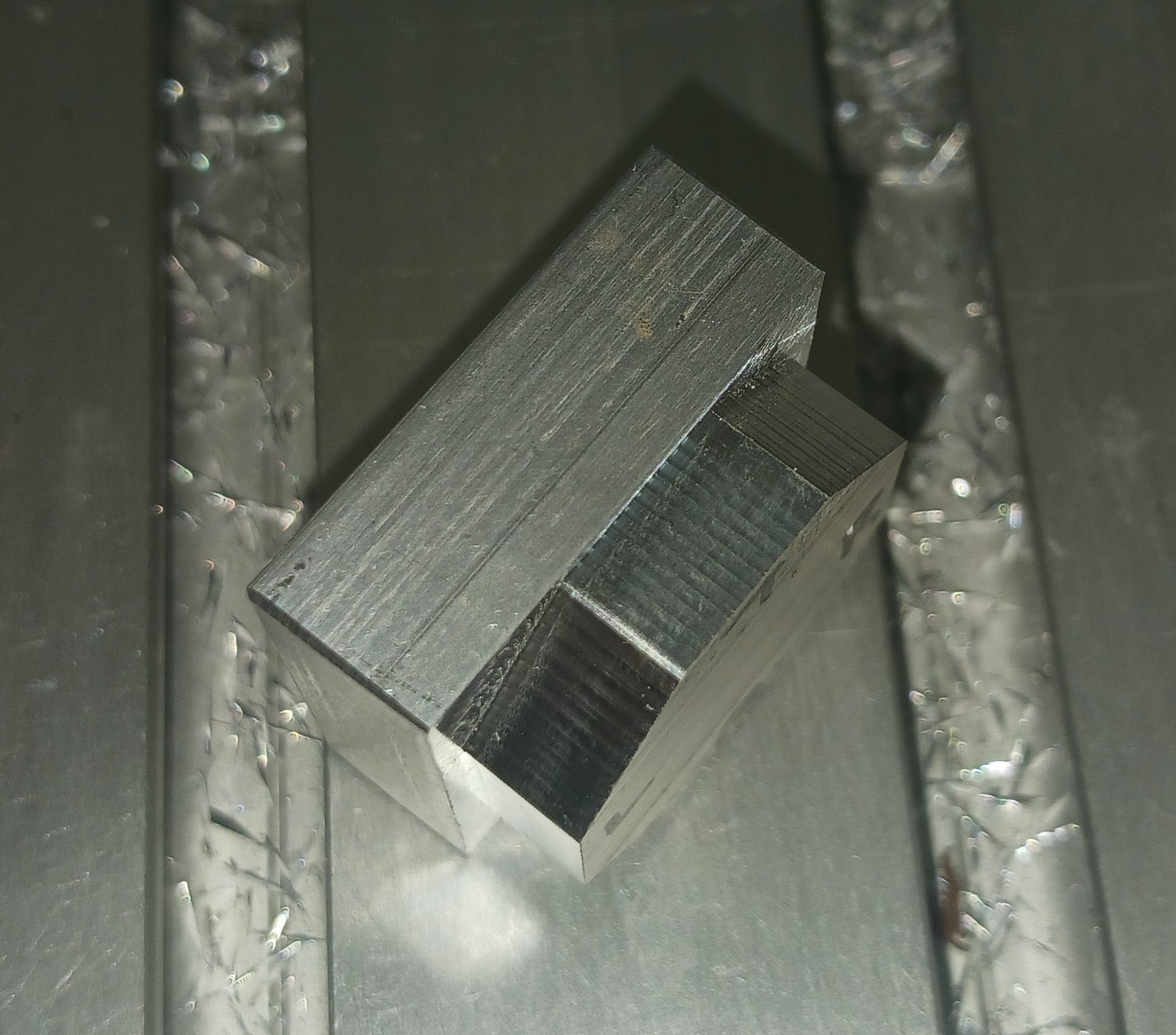

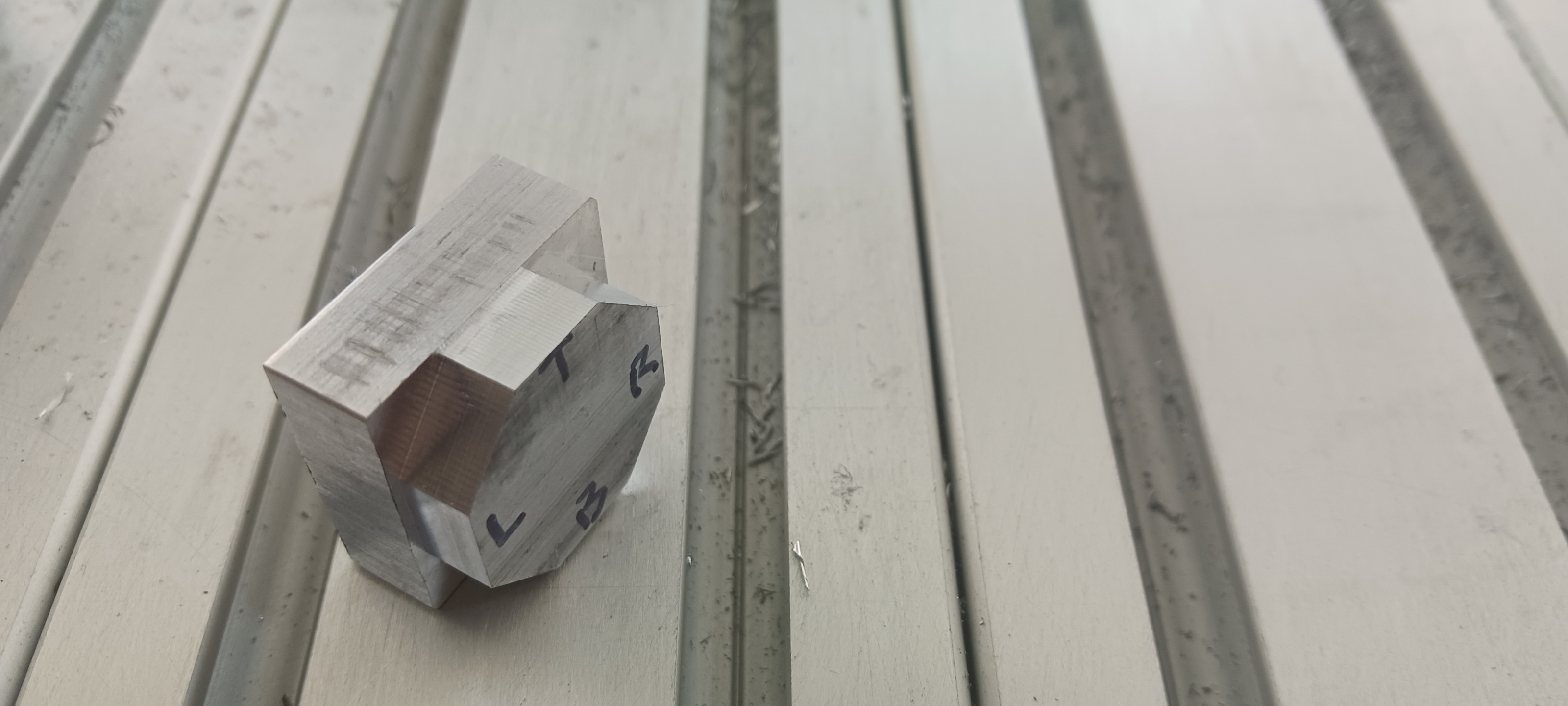

just a quick test. things look a lot more consistent. i just wanted something that would cut the same under different conditions. the cutting was 1/4 deep with a .020 step over at 50 IPM with the final pass @ 40 IPM the starting stock was 1 inch x 1 inch x 1/2 the hex is ,924 and took about a minute flat to cut. I'm' sure I can rough a little bit more aggressive and i light finish pass should help with a better finish.
a step in the right direction for sure, i would think a belt drive machine is going to hit the wall at some point on surface finish.

I think if you run the same toolpath at the same RPM but lower feedrate - i.e lower feed per tooth - you'll be able nail down whether the pattern is mechanical or motor/software.
If the pattern is the same - same 'pitch' - then it's probably the belt system that's causing it. Either from the belt pitch, and you've got mechanical 'noise' from the pulley teeth, or you're seeing peaks/valleys from belt resiliance as it stretches and snaps back in to the cut.
That, plus flexibility in other components, will result in chatter and surface finish issues.

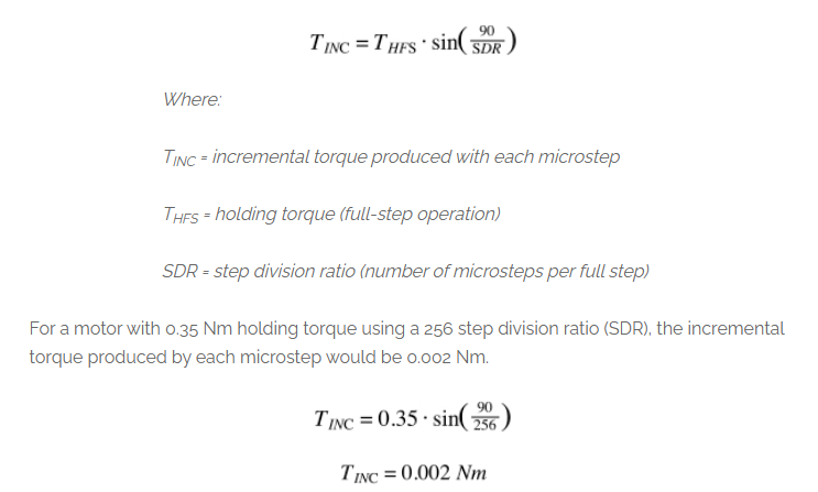

after testing one thing was clear the most improvement came from added torque. i found this formula for torque vs micro stepping. i started with 4,000 and went up to 12,800 to test for resolution problems and did not see any change between to two.
using this formula i would have 3.2 times more the torque running at the 4,000 micro steps setting compared to 12,800
i need to test more with this and see what i figure out.
