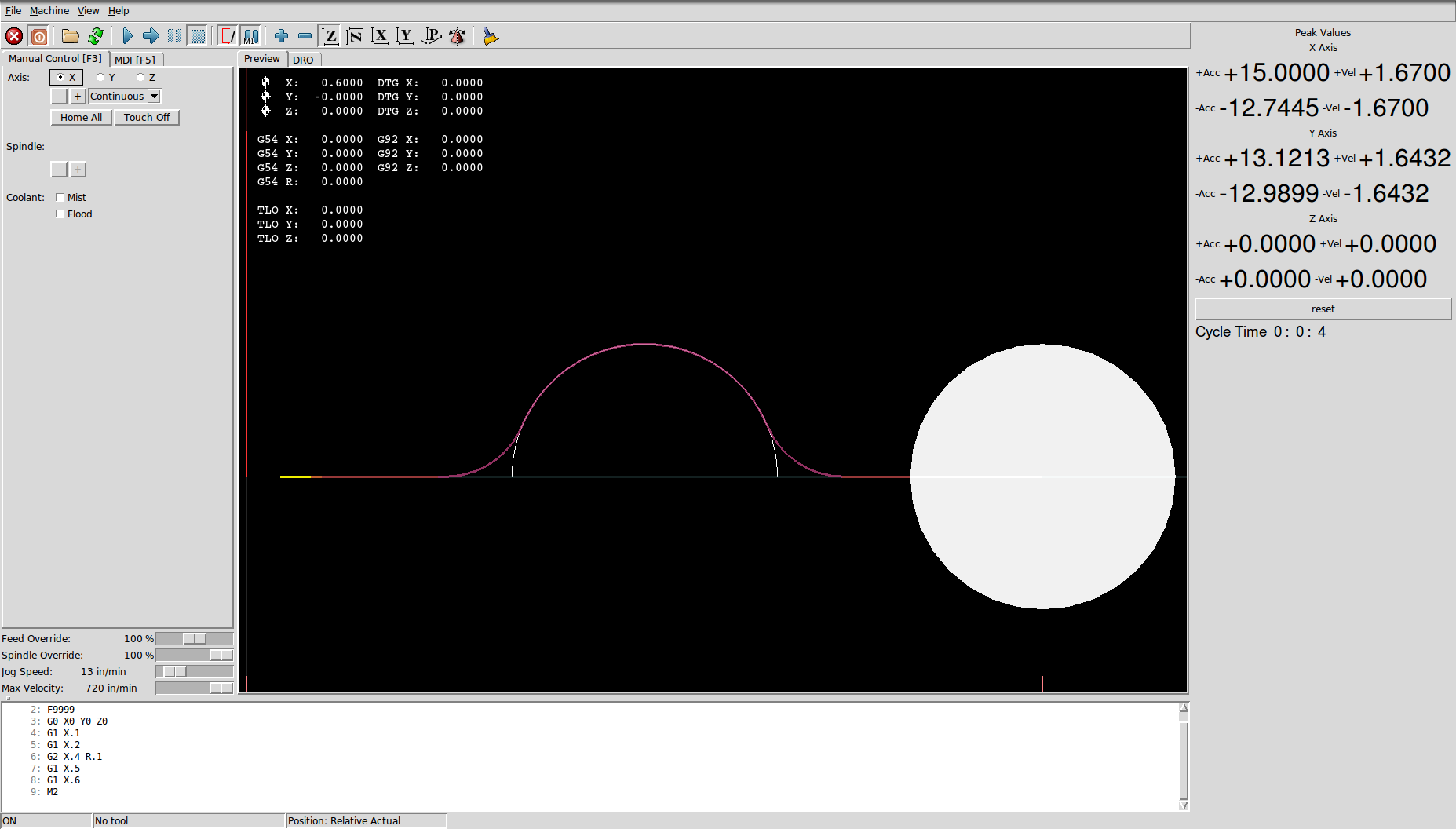

02 Feb 2014 18:27 - 02 Feb 2014 18:34 #43428 by Rick G
Here is what I am seeing on a sim with slow acceleration using G64 P.001 Q.001
There is a lead in move, a straight move, a circle made up of 4 arcs then a straight move and a lead out move.
It then repeats with a lead in move, a straight move, a complete circle, then a straight move and a lead out move.
The current TP runs the first portion slow as it is prepared to stop at each section of the arcs, then blends on to the straight exit section.
The second portion it runs the circle faster then blends on the exit.
The new TP runs the arcs and the circle at the same steady speed, so the first portion runs smoother and faster. This speed is somewhat slower than the current TP did the full circle.
Where the current TP blends on exiting the circle to the straight the new TP appears not to and prepares for a stop even thought there is a extra lead out move.
To recap - so far the readahead works with
line-line segments
tangent line-arc segmetns
tangent arc-arc segments
Which makes sense if tangent arc-line is not complete yet. But again the first section of line-arc and arc-arc is a great improvement on achieving a smooth cut.

03 Feb 2014 00:46 #43448 by rellenberg
Replied by rellenberg on topic New Trajectory Planner - Testers/programs wanted
I ran your test file, and I think slowdown you're seeing was fixed in the experimental branch. I'm working on an update to push out to the beta branch that will fix this and a few other minor issues.
I'm seeing this too, and I think it's because Naive CAM is turned on (Q0.001), which combines the lead-out move into a single segment. Since this new single segment is the last move in the program, there is still that pesky exact stop. I'm looking into ways to get around this limitation, but it's surprisingly tricky. There isn't currently a way for the motion module to know that a program is complete. Falling back to a parabolic blend on-the-fly is tricky because parabolic blends have a lower max acceleration. One thing that could work for this is reducing the acceleration that the optimizer sees for the last segment, so that we can safely fall back to parabolic blends on the fly. If that works, I should have a fix out today.
I am also looking into line-arc and arc-arc blends. The good news is, I've managed to get line-arc blends working in some circumstances (see attached). Unfortunately, I'm still working some bugs out, and the line-arc code is rather messier than line-line. The trade-off with circular arc blends is that line-line stuff is mathematically easy, but anything more complicated has to be handled case-by-case. Luckily, as you said, line-line intersections are the most common.
-Rob
