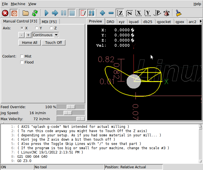

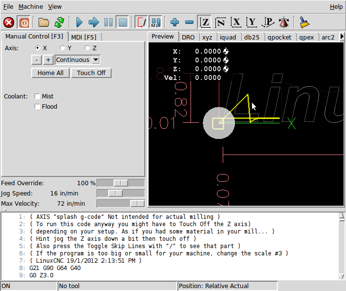

sim homing does some funky stuff to 'simulate' home switches..
git.linuxcnc.org/gitweb?p=linuxcnc.git;a...56092b130d32;hb=HEAD
Using comp and ors - I think it is right until someone says it is wrong
