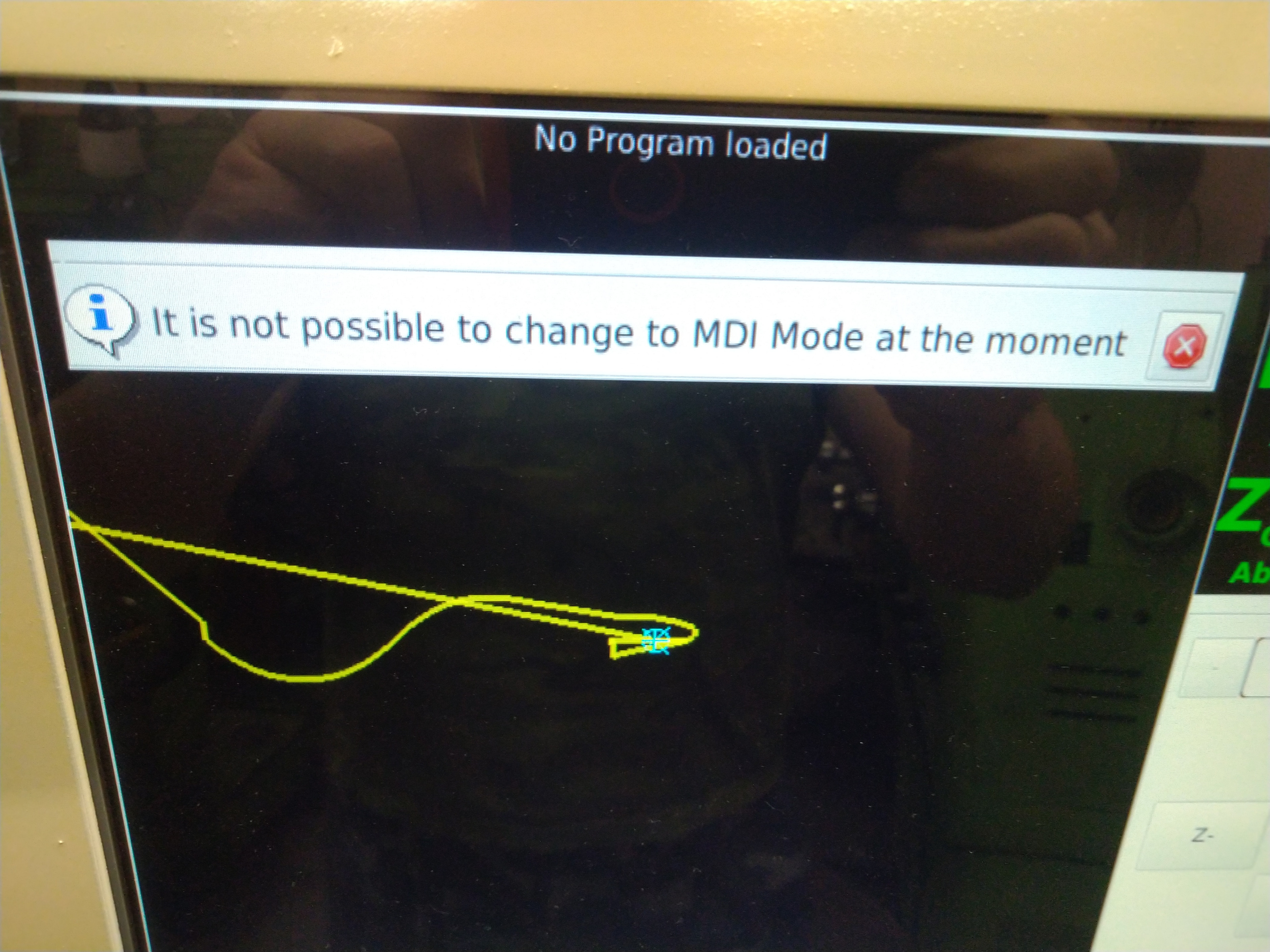

26 Nov 2020 23:30 #190382
by Serg452
Replied by Serg452 on topic Orient component revised
and message when searching (attachment)

27 Nov 2020 01:19 #190388
by alkabal
Replied by alkabal on topic Orient component revised
about forum.linuxcnc.org/media/kunena/attachme..._20201126_201742.jpg
I don't really know but the orient message use MDI so i suspect some of your button control change the program status and does not allow to use MDI command at this moment, i think nothing other from orient use MDI.
