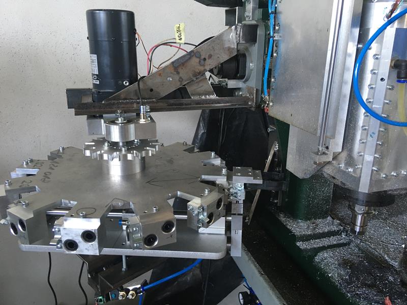

I start to add atc for my mill.Setup mesa 5i25 and 7i77 and linuxcnc 2.8.4For now I have two cuestions.1.First need spindle orient. Read some topic with orient i make my setup but when in mdi make M19 past some time and get error spindle dont turn.In halmeter I see orient start. My spindle need one Input for ON and Fwd/Rev and dont see in halmeter servo on signal when start orient.Encoder working and rigid tapping to.2. For M6 routine for yesterday try with only connected Arm out and without connected sensor for arm out The arm going to position and get error (not sensor conected) and abort. And cuestion is the output 5 in my config after abort is still up. Try to press Esc and nothing. Try to press F2 servos stop working but output is still up. The output5 only disconnect when I clouse linuxcnc. Is normall?

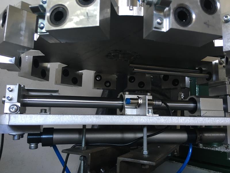

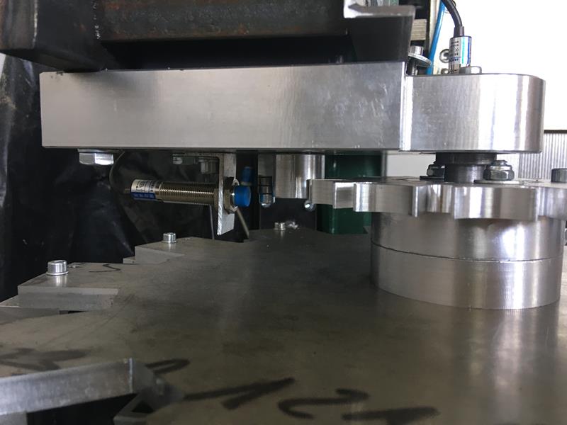

Today try to run orient with several or2 but not lucky...with spindle orient start must start to;
spindle-cw hm2_5i25.0.7i77.0.0.output-01
net spindle-enable <= spindle.0.on
For the tool change connected all today and when start M6 T5 for example;
Z axis go to Z-50
Arm go out
Relase tool
Z axis go to Z0
Arm go in
Carousel start turn going to Index and stop not going to T5 and not give any error
Spindle is 2,2kw ATC water cooled bt30/iso30 with encoder and spin from 100rpm to 12000rpm is capable to tapping M12 in steel with 100rpm Think to start produc this spindles in this year.

Carousel start working and make all sequence but.
If in tool.tbl tools start from T1 P1 get message on start "negative tool id used" but linuxcnc start
Other problem is with bad asignations of pockets
tool-tbl on start
T1 P1
T2 P2
T3 P3
After first change and no tool in spindle making "M6 T6" in tool-tbl apeard "T6 P0" and desapeard P6 from tool-tbl file...
Making second change "M6 T10" tool T6 back to P6 pocket and from pocket P10 T10 going to spindle in tool-tbl apeard "T10 P0" but in P10
apeard tool T6!!!
Making Third change "M6 T2" tool T10 back to P10 pocket and from pocket P2 T2 going to spindle in tool-tbl still is "T6 P10" and apeard "T10
P2" but P2 is empty!!!
And if want back tool from spindle back to pocket M6 T0 get error T0 not exist. After thre change still P6 is missing.
Try to start tool-tbl with T0 P0 and not message "negative tool id used" on start
After first change and no tool in spindle making "M6 T6" T6 go to spindle and in tool-tbl apeard "T6 P0" and "T0 P6" this is ok
Making second change "M6 T10" T6 back to P6 pocket and from pocket P10 T10 going to spindle in tool-tbl apeard "T10 P0" but in P10 apeard
tool T6 and In pocket P6 is still T0
And if want back tool from spindle back to pocket M6 T0 tool from the spindle go to last pocket is ok but after that start another exchange
and get error arm out.
