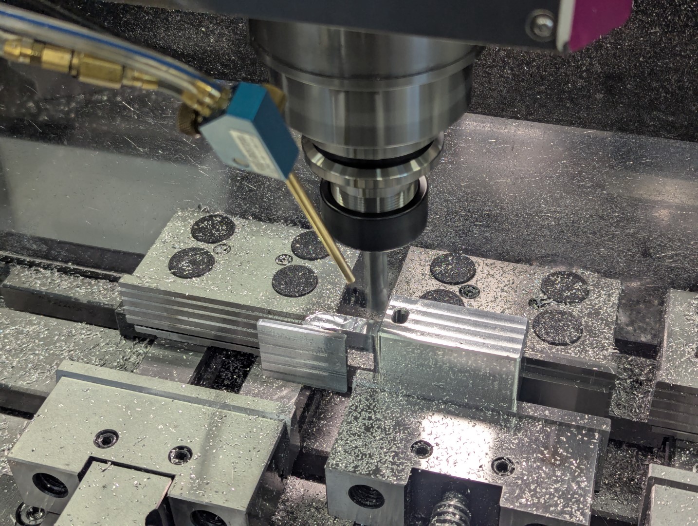

I've done some more parts on the mill and it's working great apart from the slow spindle speeds I have to run.

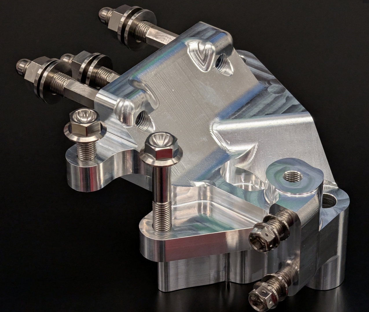

Here is a short video of two aluminum mounting brackets that I designed for the rear sway bar of my race car.
The mounting brackets came out really nice but I can't wait until I have a new spindle so that I can increase the speeds and feeds a bit.

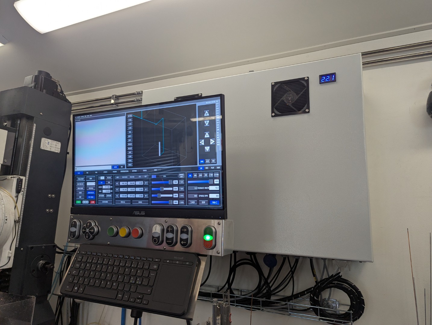

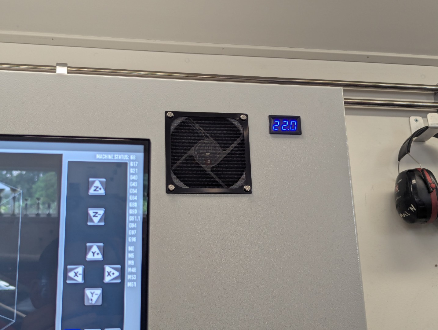

The milling machine has been working great so I haven't done any changes to it for several months. However one thing that has been on my mind for a while is that I have no idea how hot it gets inside of the control cabinet during long milling sessions.
A quick search for temperature display brought up this unit on AliExpress for a very low price:
www.aliexpress.com/item/1005005993184685.html
I bought one and it arrived a couple weeks later, here is how it looks installed in the cabinet.
It's gonna be interesting to see how hot it actually gets inside the cabinet.

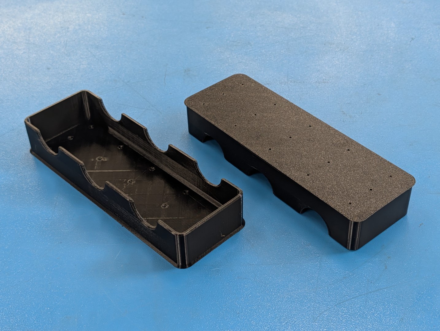

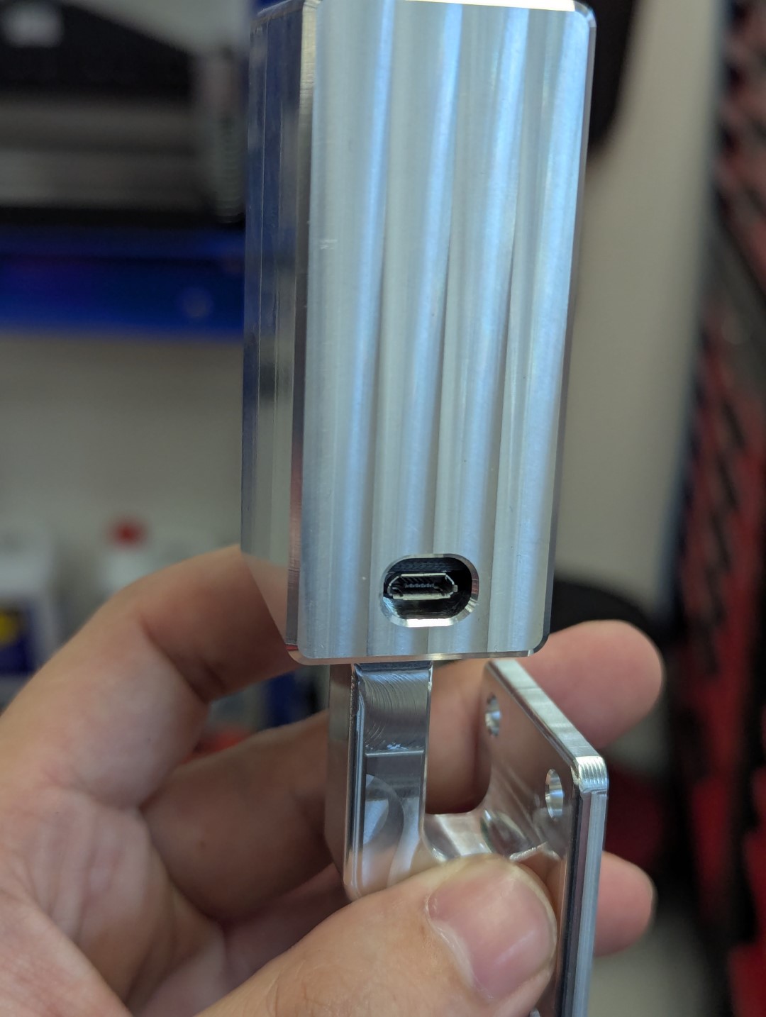

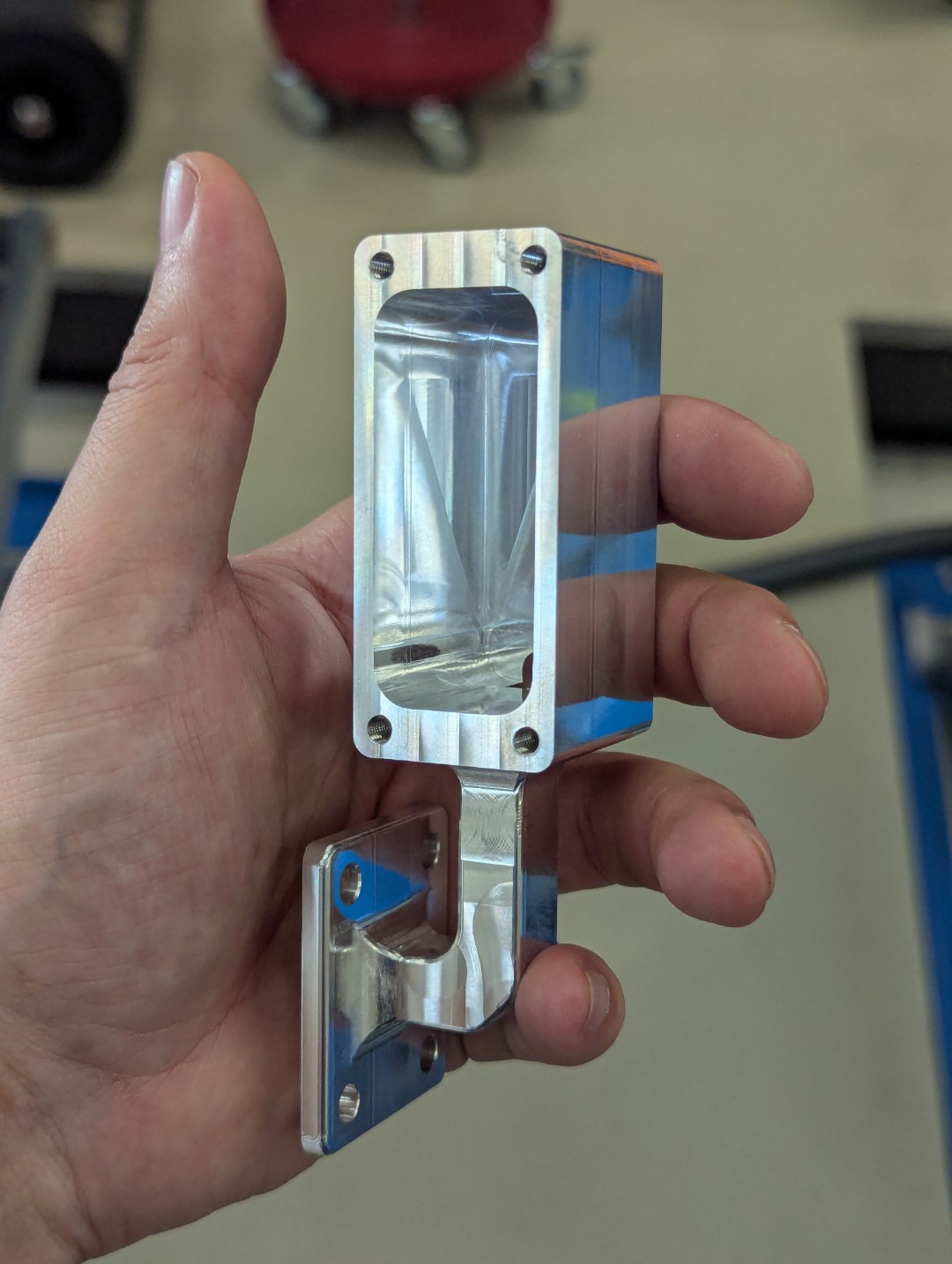

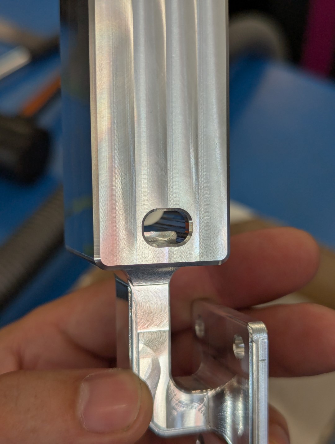

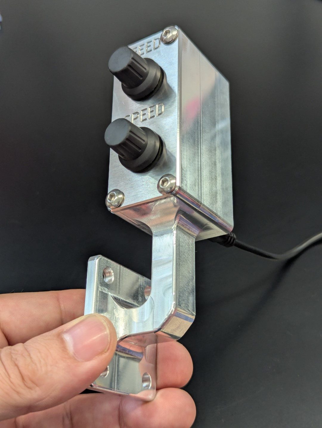

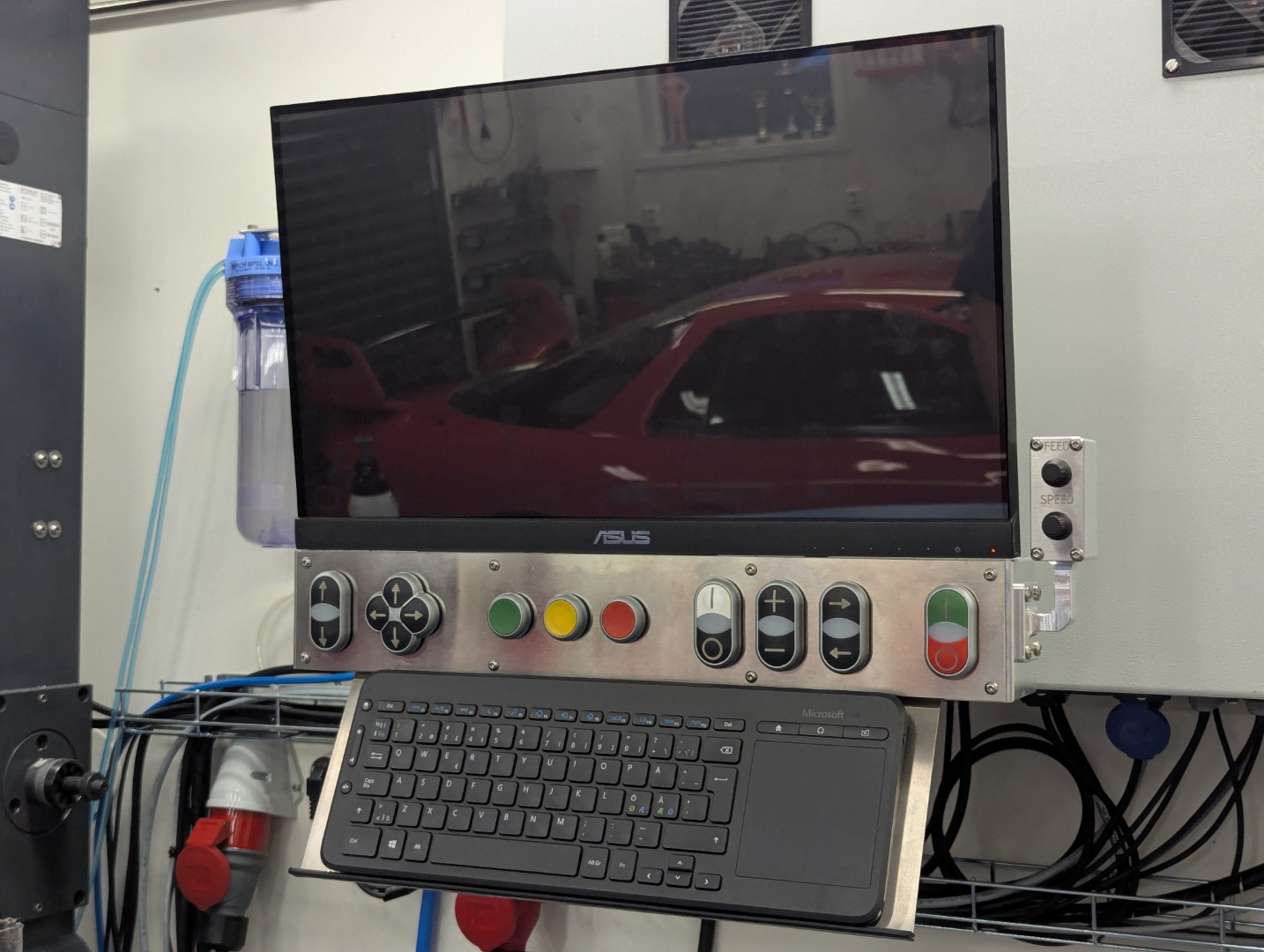

I spent the last week with a really bad cold and while being bored by the need to rest and stay calm I decided to design a small addon for the control panel on the mill.
When I first designed the control panel I had never touched a CNC mill so I had no real idea which physical buttons that I would need.
After using the machine for a while I have realized that having rotary encoders for controlling feed and speed override would be very useful as it would mean that they could be operated while wearing gloves which does not work very well with the touch screen.
As I had plenty of time to kill this addon might have gone a bit over the top but it's very sturdy and works really well.

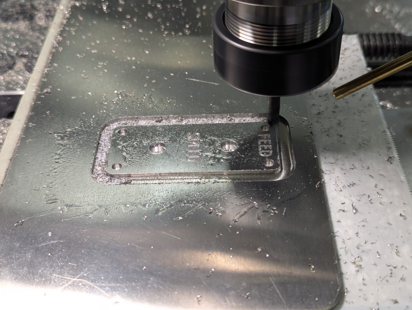

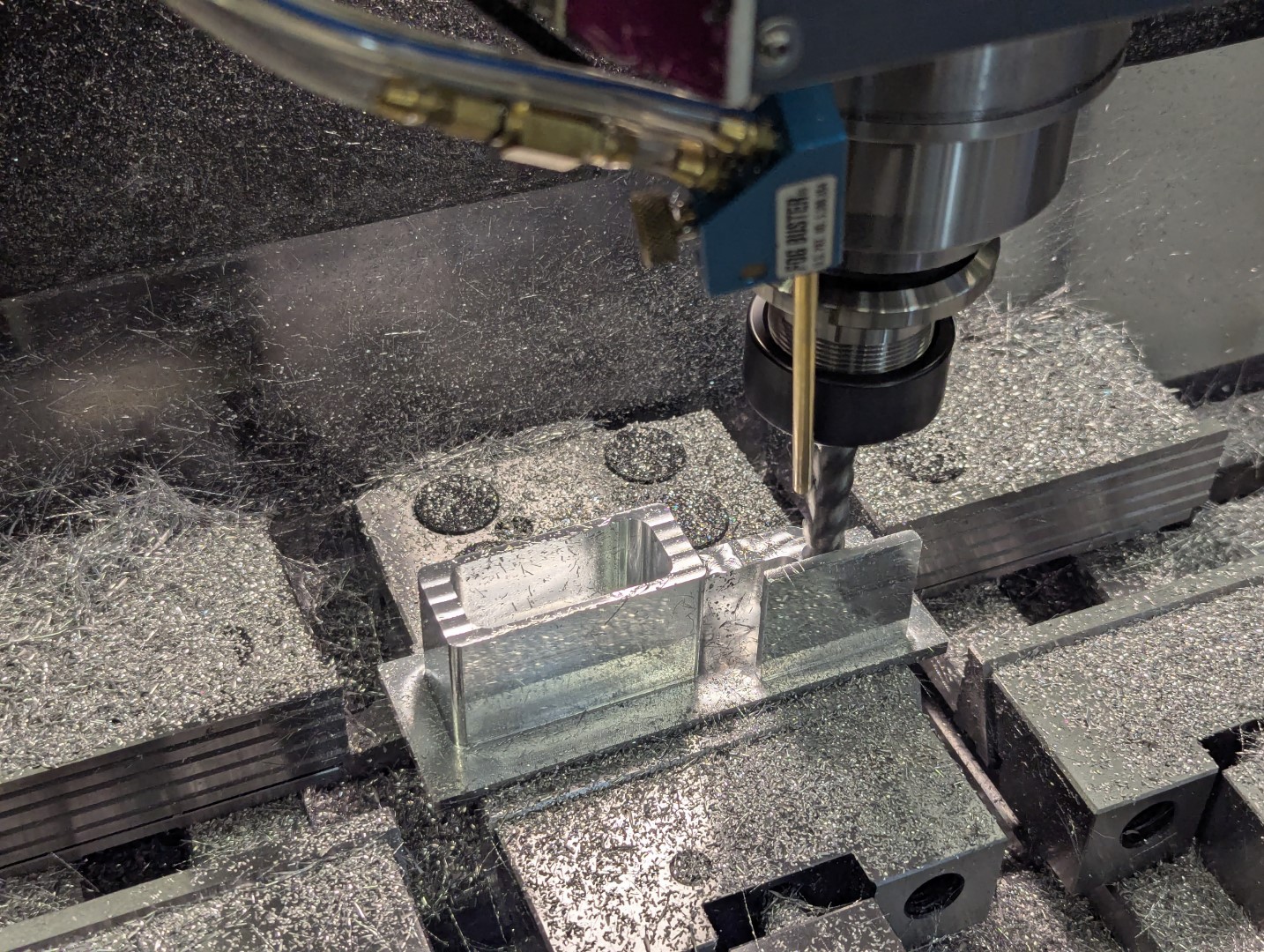

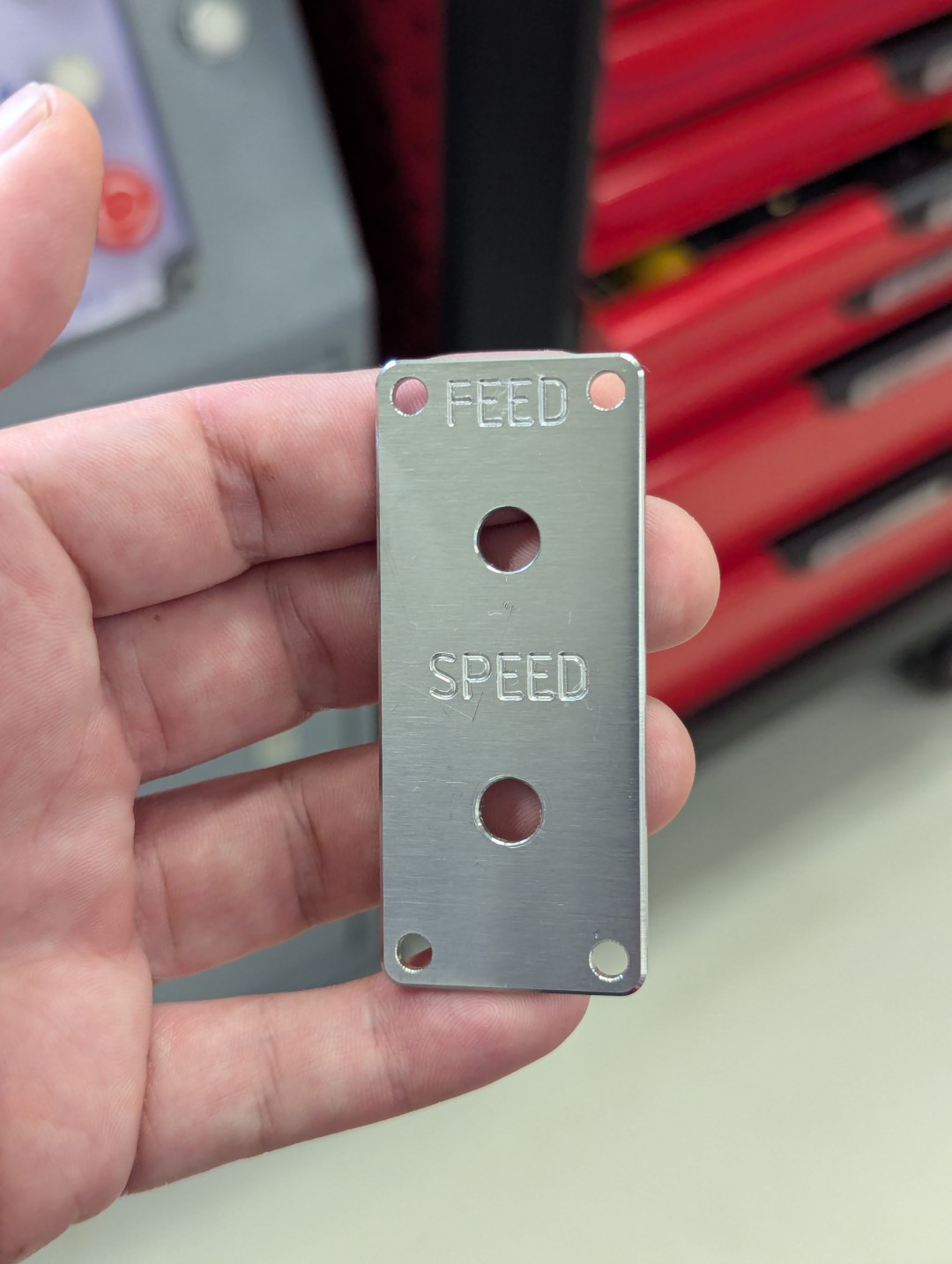

I started by milling the body out of some 6082 aluminum.

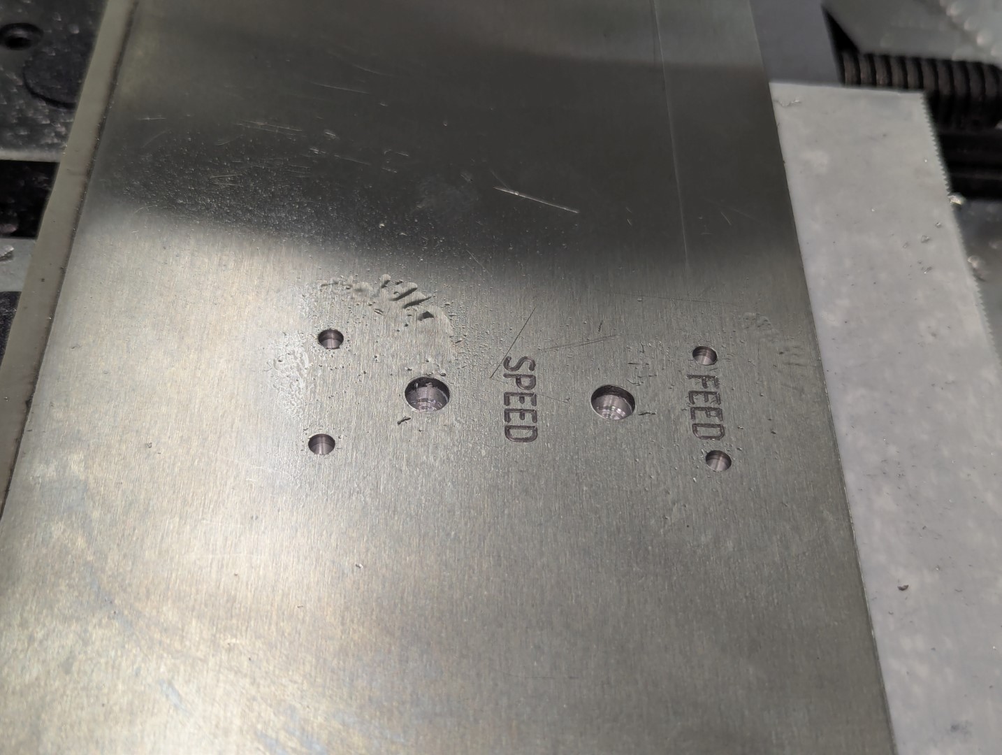

I then milled a face plate from a 2 mm thick scrap piece of stainless plate that I had laying around.

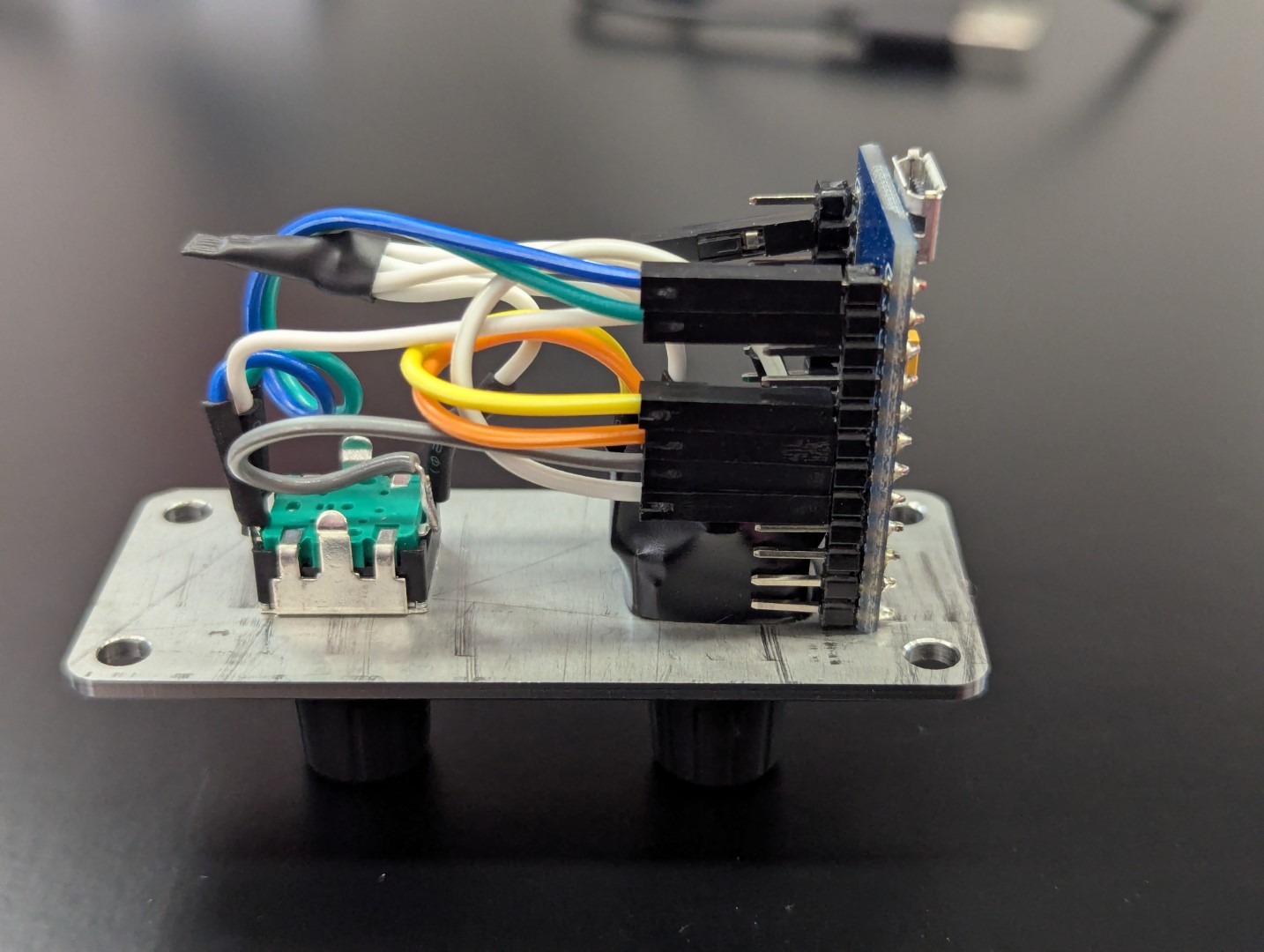

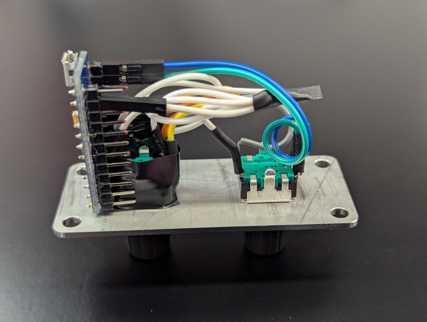

With all the milling down I turned my attention to the electronics, consisting of a small Arduino micro clone and two rotary encoders with built in push buttons.
Here is how the complete assembly looks.
Here it is installed on the side of the control panel.
And here is a short video showing how the two rotary encoders work in LinuxCNC with the Probe Basic user interface.
The LinuxCNC ArduinoConnector by Alexander Richter worked surprisingly smoothly. However I did find a bug in the Python code when it came to using the encoders in up/down mode instead of counter mode. I'm going to report that bug in the forum thread for the Arduino connector, however it was not a show stopper as I simply switched to counter mode instead.

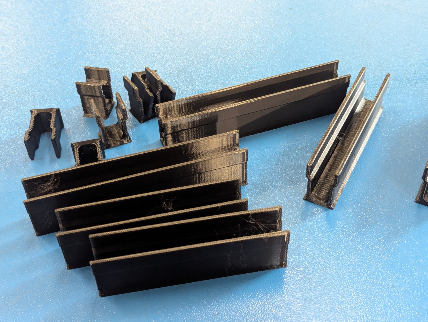

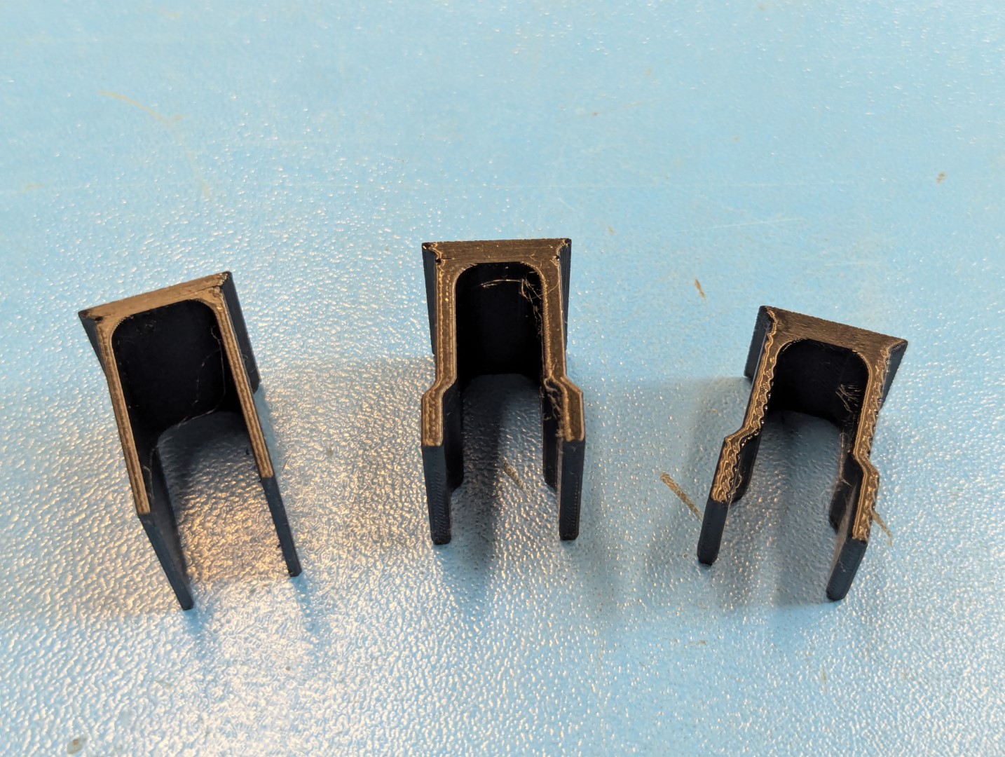

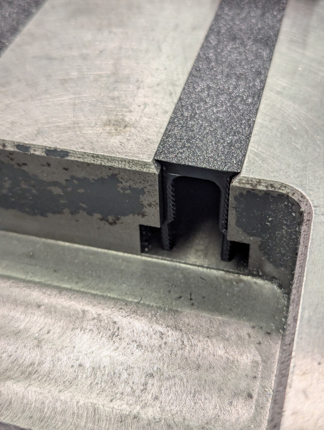

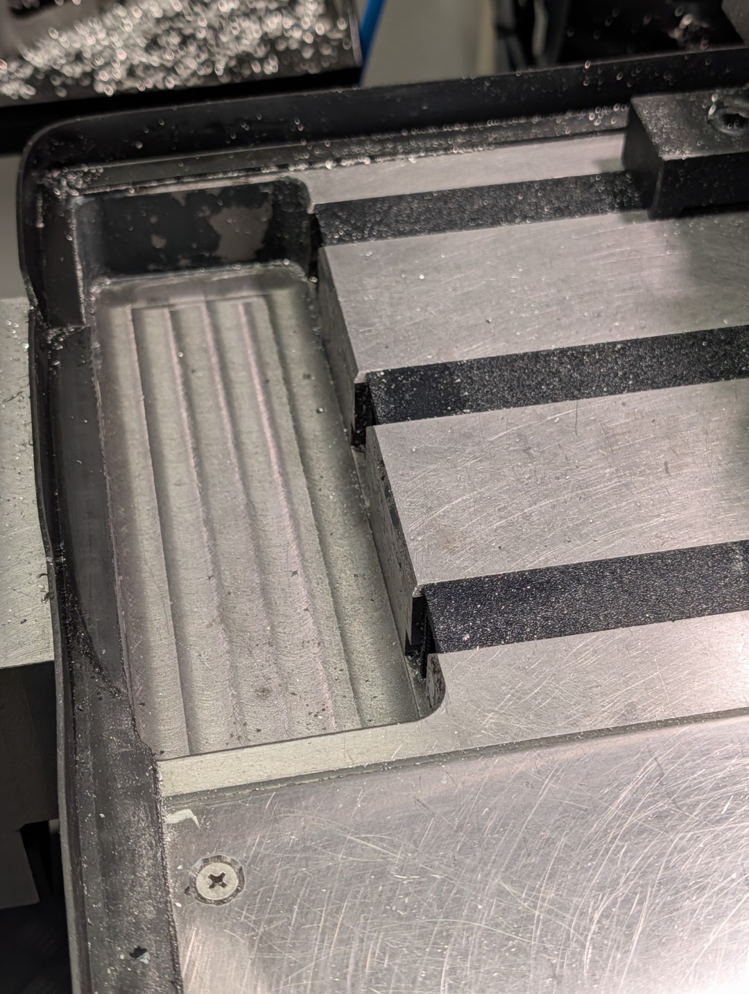

This is not really LinuxCNC related but something I should have done years ago, 3D-printed T-slot covers. It makes it much easier to vacuum up all the chips of the table.
It took three iterations to get the profile right, here are the test pieces I went through.
Here is the complete set that I installed.
They are printed out of flexible TPU filament and took about 4,5 hours to print on a Bambulab P1S printer.

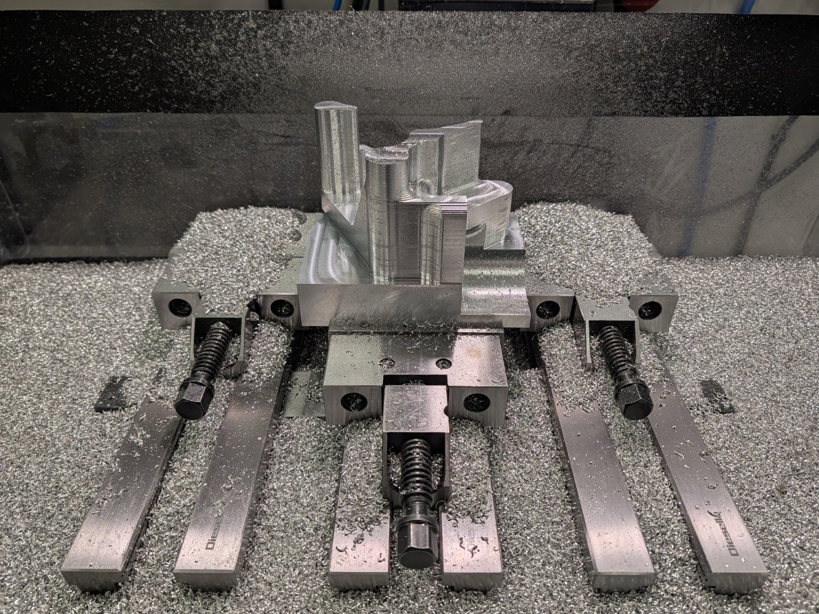

I'm still using the BT40 spindle that this machine came with. However getting the preload right for the spindle and getting the upper bearings for the quill drive to like high rpm milling for prolonged periods has been a challenge. I've been planning to replace the spindle for quite some time but not really taken leap yet.
However after fiddling with the spindle for sometime I've realized that I have to set the preload when the spindle is really warm in order to get a preload that works.
This in turn requires me to do few minutes of spindle warmup at lower rpm when the spindle is cold before I can crank up the rpm. Else I get a really nasty oscillating sound from one of the upper bearings.
Here is a video of the spindle at 3200 rpm roughing 6082 aluminum with a long 24 mm indexed end mill.
This has became a favorite tool for roughing aluminum as it has good reach, removes material at a decent rate and the 1003 inserts are cheap and readily available from many vendors.

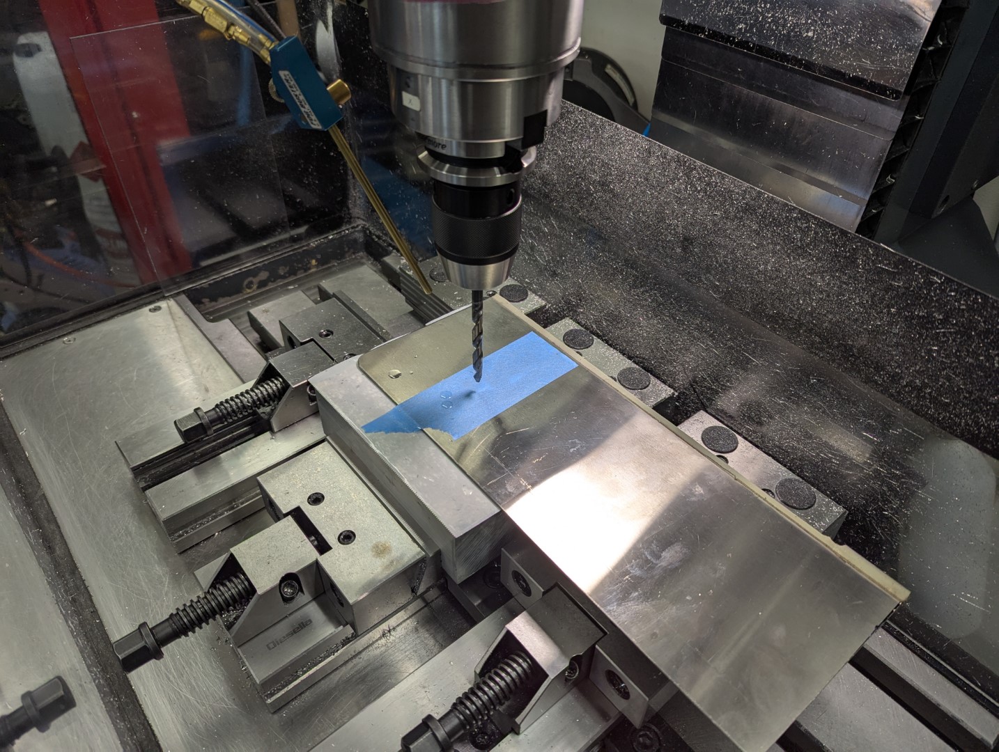

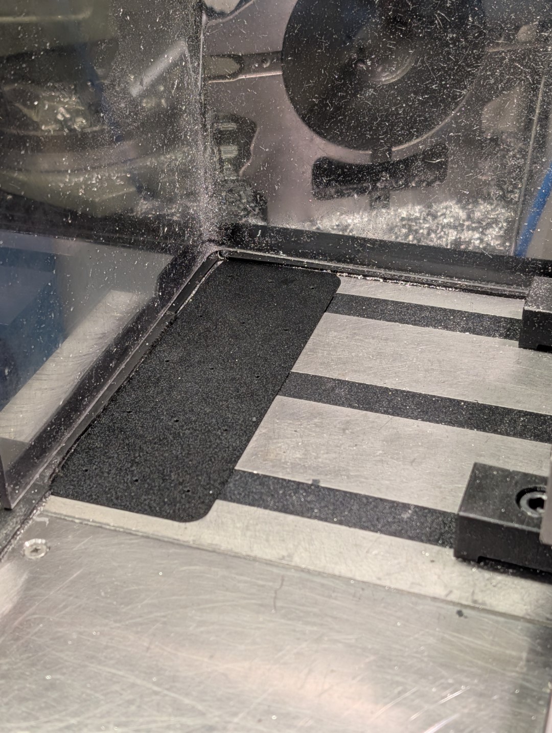

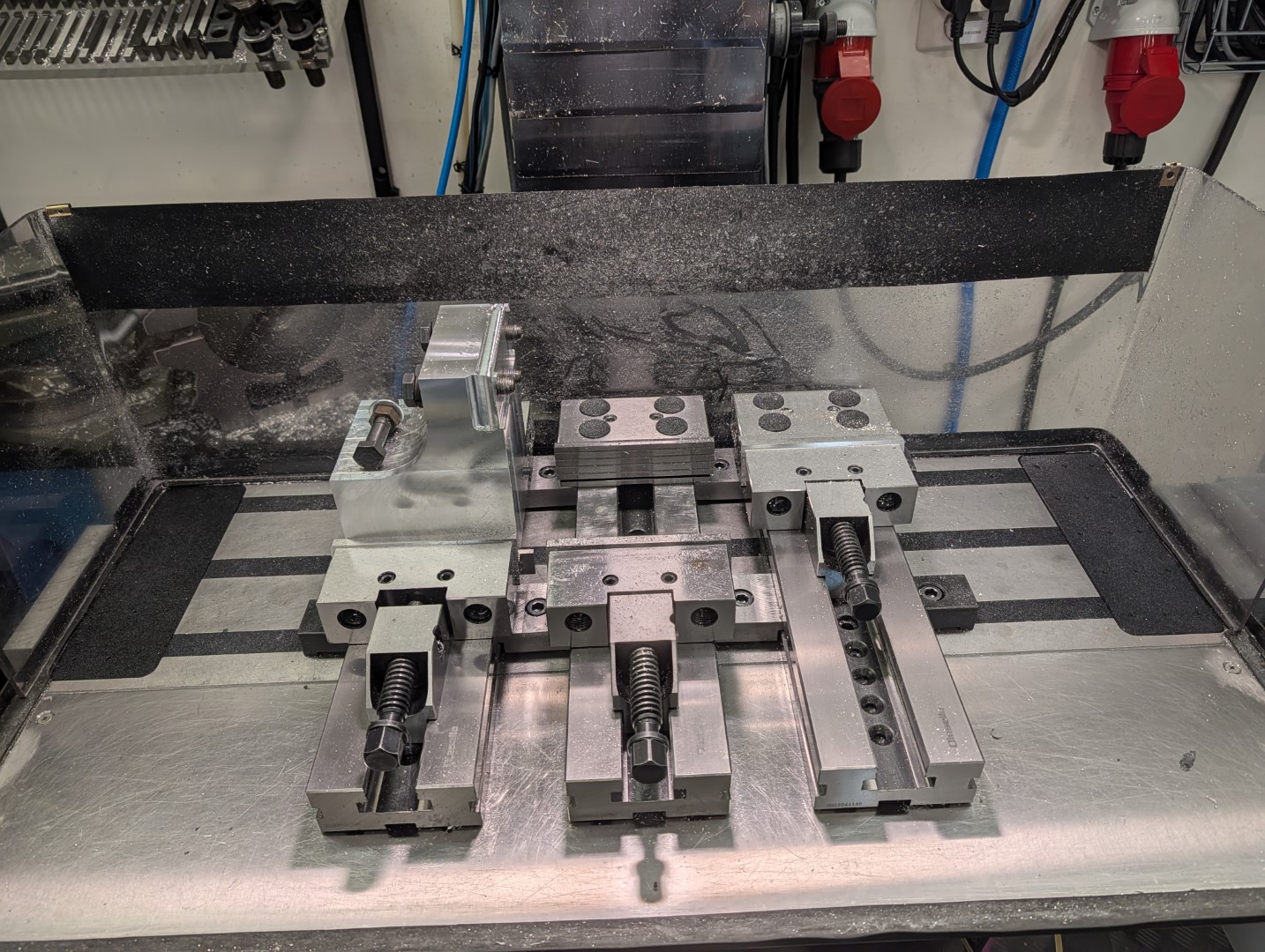

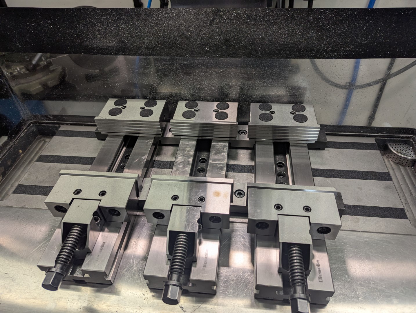

The way covers I made recently greatly simplified the removal of chips from the table. So inspired by that success I decided to make a set of covers for the pockets at the ends of the table too.
I won't use these together with flood coolant but to make sure that any moisture that gets trapped under them still has a chance to escape I added some 2 mm holes.

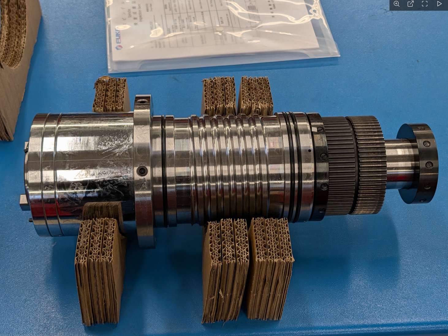

However it's finally timed for a much awaited spindle upgrade. I bought this 8000 rpm, liquid cooled BT40 spindle from FUKA/Swift. It seems like a very nice unit but it's gonna be a while before I can test it as I now need to design and manufacture a new head for the milling machine along with a much larger pneumatic tool release cylinder.

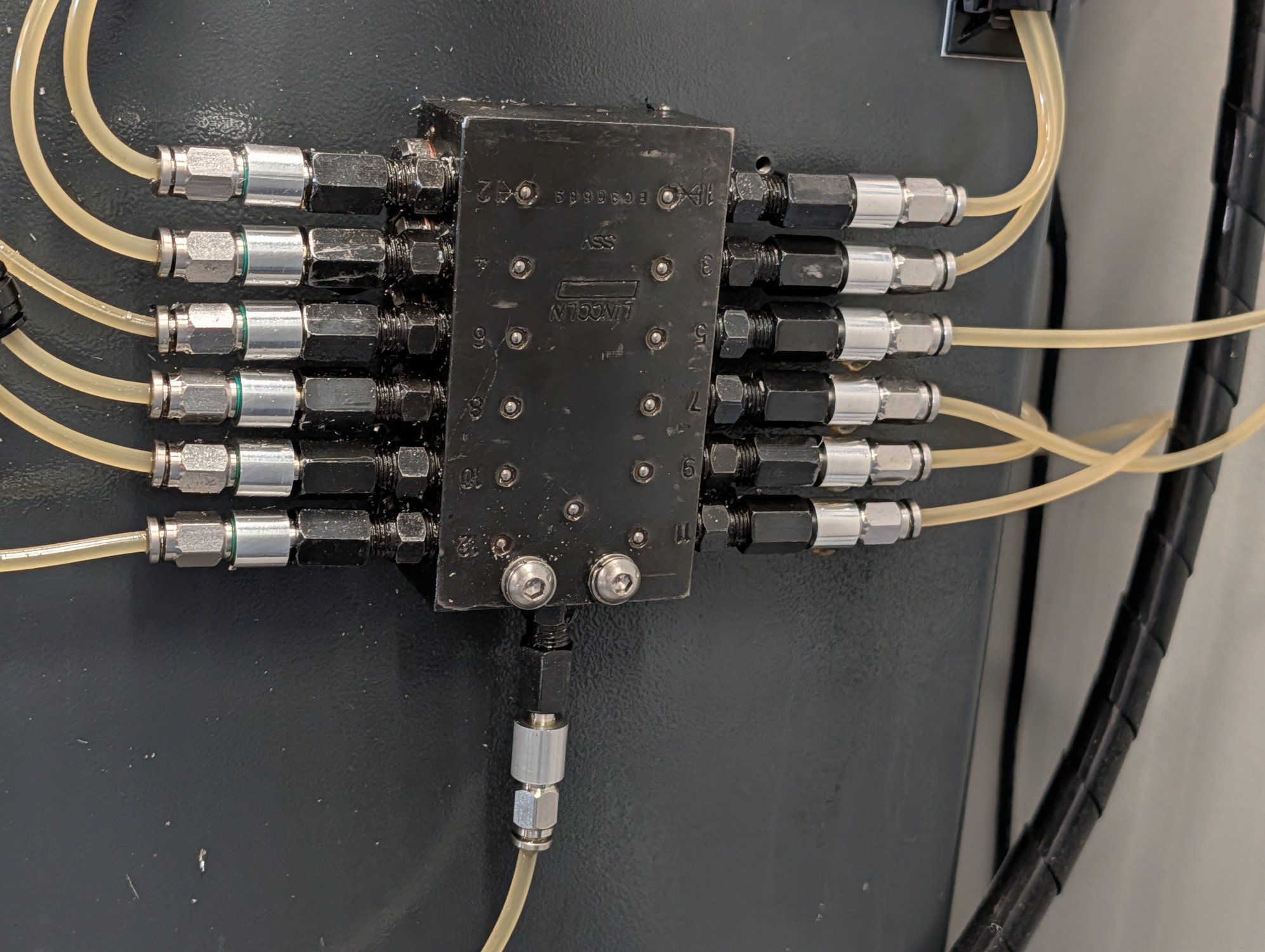

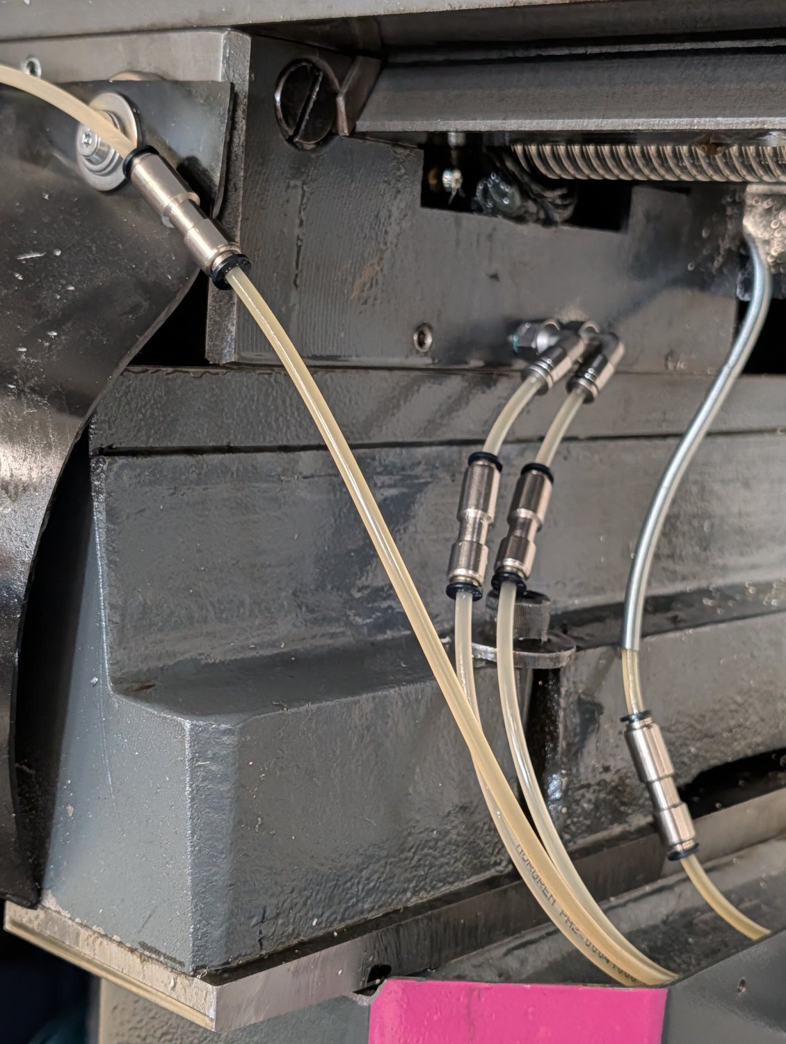

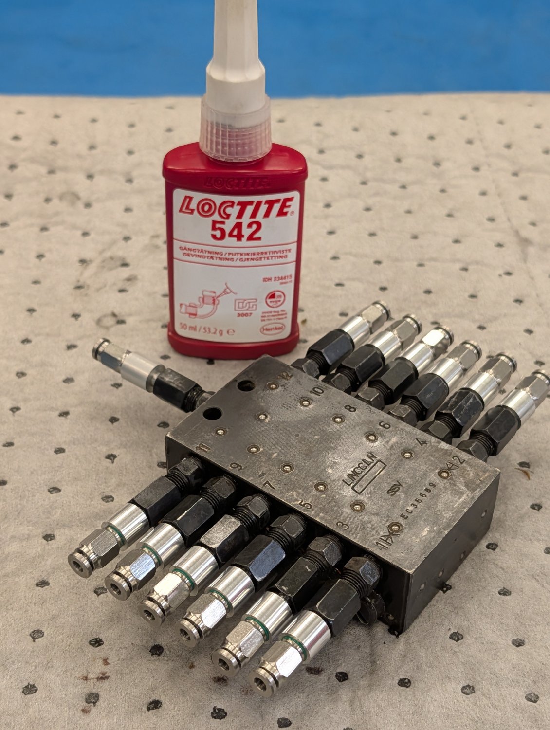

After a longer than usual summer vacation break I've started another round of upgrades on the milling machine.
The first thing I did was to try and fix the leaks from my "Lincoln" clone progressive oil distribution block.
The tapered threads for the connections are not of the best quality and the built in check valves leak quite a bit.
This resulted in air in the lines if I didn't run the pump for the central lubrication for every week or so when the machine wasn't being used. It also left a pool of oil on the floor below the oil distribution block.

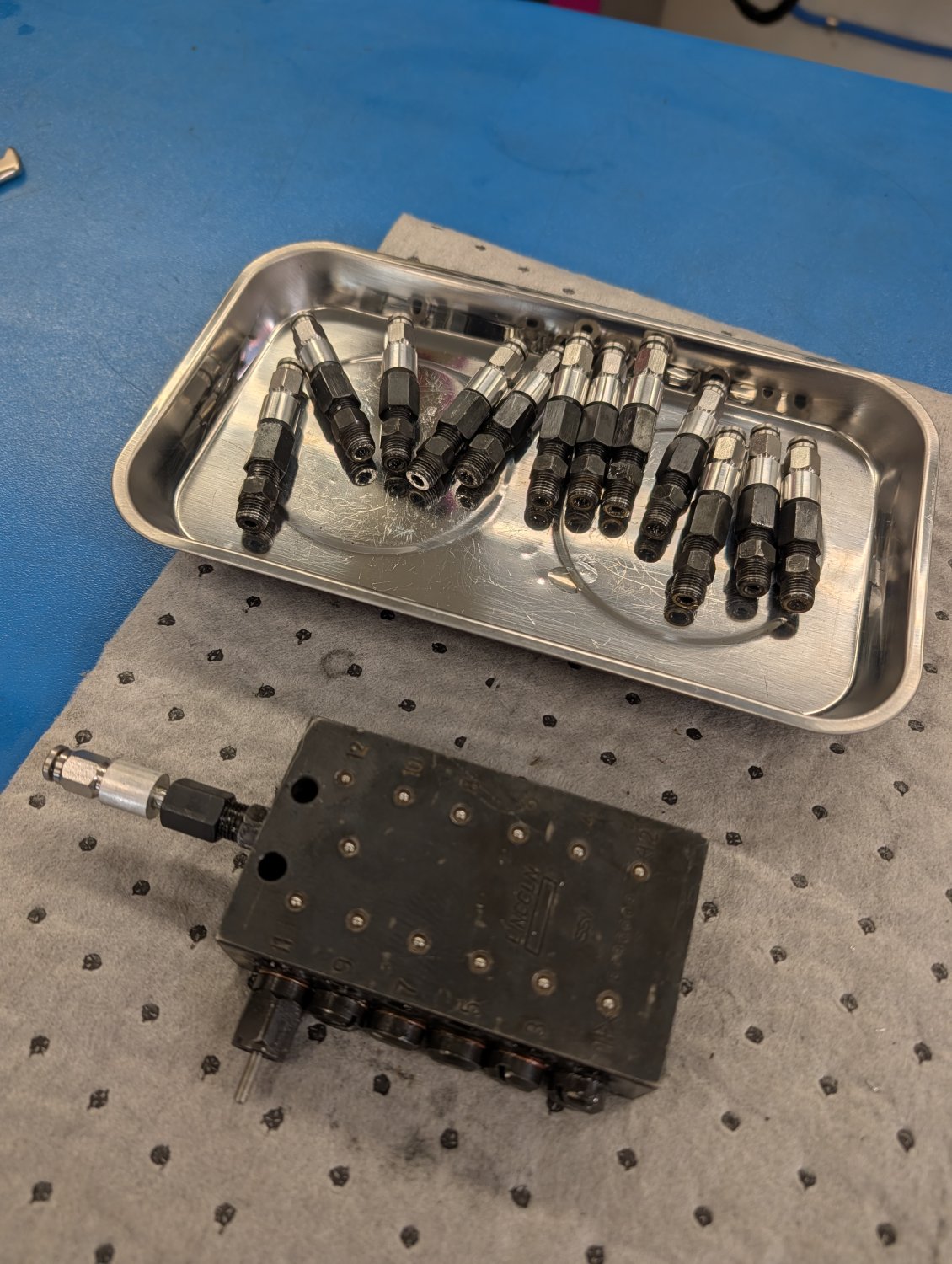

In order to try and fix this I removed all the connections from the block, cleaned the threads with brake cleaner and then reassembled it with Loctite thread sealant.

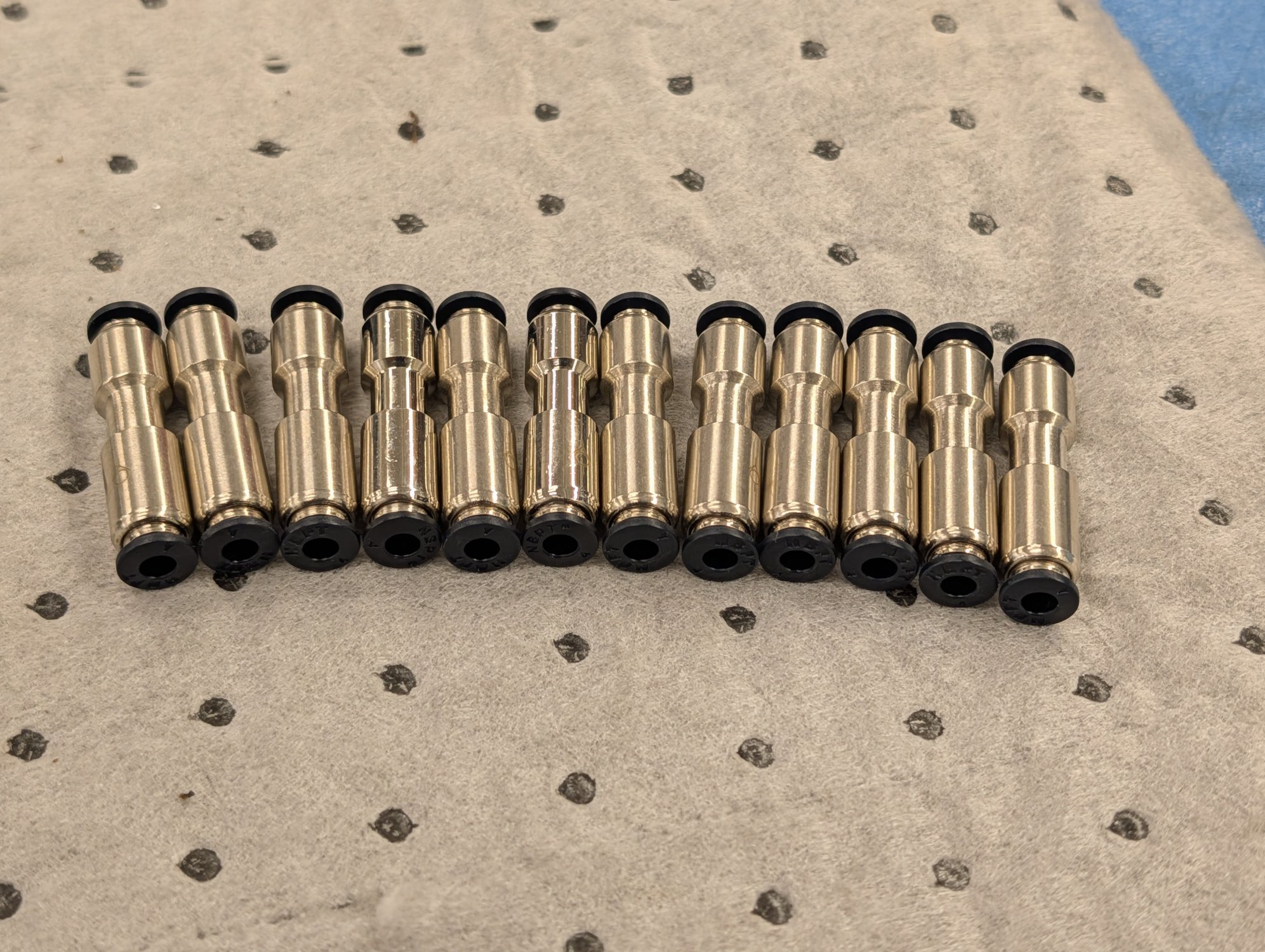

Then I added these small low pressure metal check valves I found on Aliexpress.
These changes seem to have significantly reduced the leakage from the oil distribution block and so far I have had no problems with air in the oil lines.
