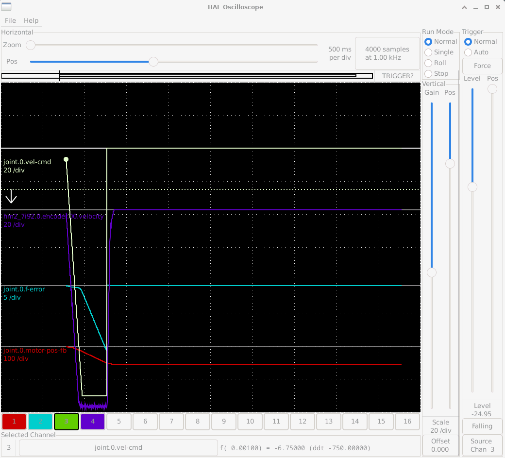

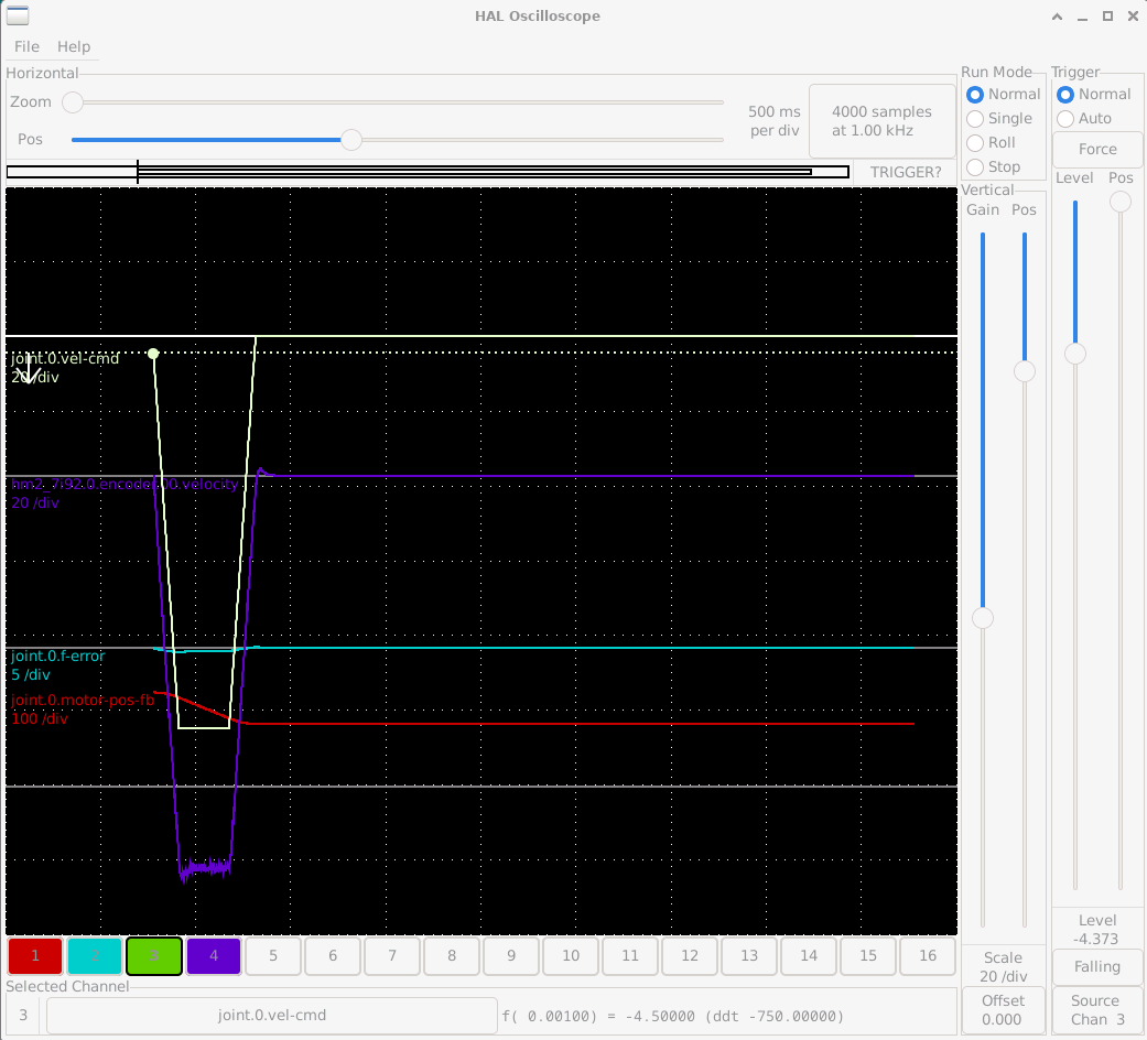

20 Feb 2025 16:31 - 20 Feb 2025 16:41 #322084
by NT4Boy
Replied by NT4Boy on topic HURCO KMB-1 Control Update
In fact there is nothing much wrong with the hal and ini entries,
HOME_OFFSET = 25.4
HOME = 0
I understand these better now, and to have the machine Home position at 0.0 25.4mm away from the limit switch after the encoder index has registered was my intention.
But even after I have tuned the axis I cannot get a successful home.
It has however stopped parking on the limit switch, but but can generate a big joint following error. The Rapid Halscope image, is at 6350mm/min and to me from what I've learned from the tutorial is pretty good.
I've set the HAlscope f-error at 5/DIV to match the tutorials, but wonder if that's correct for a metric setup
The Home image is the follower error up to the shutdown, which shows a massive figure that I cannot reproduced with the jog buttons even at max table speed.
Not quite making sense to me yet.
I'd appreciate some comments.
HOME_OFFSET = 25.4
HOME = 0
Last edit: 20 Feb 2025 16:41 by NT4Boy. Reason: Typo noticed

20 Feb 2025 16:46 #322086
Replied by PCW on topic HURCO KMB-1 Control Update
In the top plot, it looks to me like you have the maximum velocity faster the the drive can go
(so the following error rapidly increases when you reach the limit)
Normally you will need to set LinuxCNCs velocity limit to 80-90% of the machine velocity at 10V
The following user(s) said Thank You: NT4Boy
