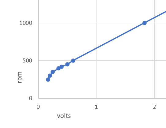

Sounds like the drive has a significant offset or there is some electrical issue
What RPM do you get from the drive at 0V?
I is not for tuning overshoot but to have a slow but unlimited feedback
You can try more I term ( until it oscillates then back off to say 25% ) but I think the
real problem is the offset.
(the P term by itself cannot bring the error to 0 because the P term needs
and error to have any effect)
All this to say, it sounds like there is an electrical issue or perhaps drive
parameter setup issue that needs to be addressed rather than patched
over in LinuxCNC.

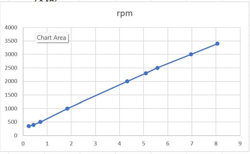

13 Jun 2025 05:54 #330247
by NT4Boy
Replied by NT4Boy on topic HURCO KMB-1 Control Update
Gates Belt Tension Calculator
Gates 'phone Frequency App
So from the type of belt, length, number of teeth on the pulley, motor speed and power etc, Gates recommend tensioning to a twang frequency between 39-41Hz.
At this tension, the thing sings pretty loud with the covers off, but is far less sensitive to oscillations. Have P of 0.45, and I increased to 0.015
With output scale at 4500.
Get
cmd actual
300 400
400 420
500 500
600 600
700 700
1000 1000
1500 1400
2000 1900
2500 2400
3000 2800
3500 3300
Have also now looked at the motor speed with zero volts to the VFD and its 250 (Hurco book says 150, but for now its in the ball park).
The rest of the low end volts looks like this.
