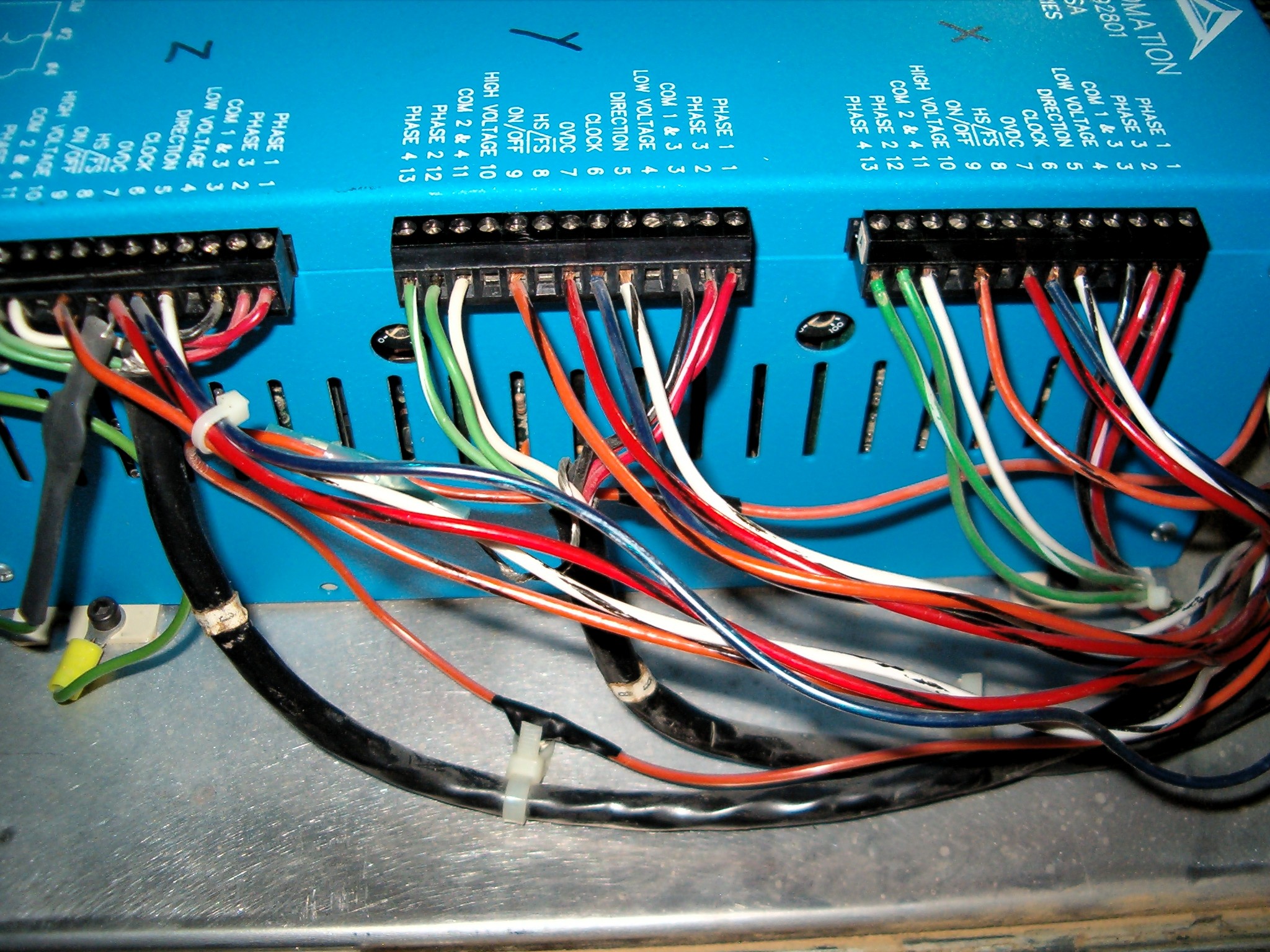

11 May 2013 09:36 #33914 by Todd Zuercher
Replied by Todd Zuercher on topic Please help, I need some addvise
1st thing to check unplug the connectors that plug into the drive (they are green Phoenix screw terminal plugs) If the plastic is brown or discolored (indicating arcing and a bad connection) replace them.
2nd thing to check, unscrew the cover on the drive and look inside. Inside there will be a duel output AC transformer with 4 wires to each driver board (2 for high voltage and 2 for low) These are connected to the driver boards with simple 1/4" push on spade connectors. If any of these are bad the insulation on them will be obviously charred. Often the connector will have gotten so hot as to melt all the solder off the boards connector.
3rd thing to check is the continuity of your motor cabling.

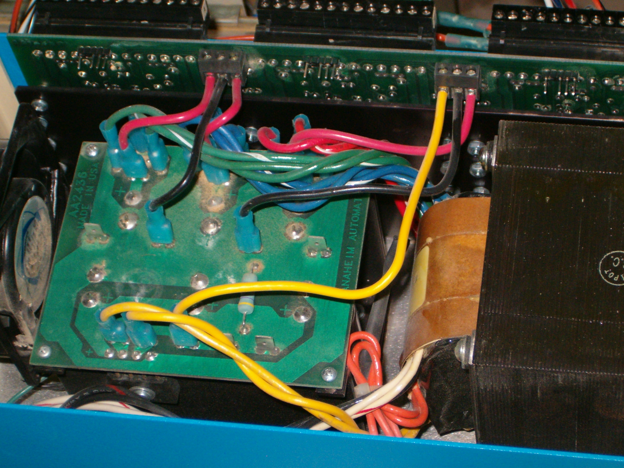

Todd, The contacts appear to be good as new, just for fun I included some photos of the drive while open, and a shot of the terminals on the side too.

Ref the photo of the circuit board.
I would remove each spade connector individually and clean the spade and the plug with a wire brush, they can corrode quite badly and you cannot see it unless you dismantle.
Also check all the solder joints, that the actual joint has not parted from the board. Sometimes you find the copper track has severed and there is the most marginal of edge connections and the actual
component pin will move complete with solder.
Be careful around the rectifier bridges though, there is a big capacitor somewhere near just waiting to zap you!
