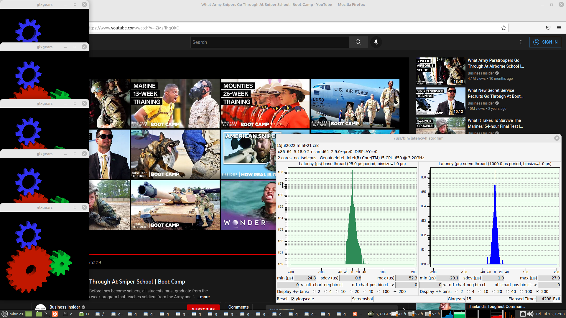

Oh i have that processor with an Asus P5B-Deluxe board, it would overclock to 2700-2800 and fail miserably above it, till i change a single setting in the BIOS that pushed it to 3.6GHz ... and it booted and worked perfectly, until the load would become high, i had only the smallest Intel cooler for it.Asus P5B-MX, Intel Core2 Quad Q6600, 4 GB RAM (2x2 GB in dual channel), some 128 GB SSD i had laying around. Everything not needed disabled in BIOS.
Module pcspkr is not loaded, the script encounters an error when trying to detect if it's loaded.
Slight overclock for the CPU, running 290 MHz * 9 (266*9 stock). RAM running at 667 MHz.
If you have a big cooler, give it a try.

Tommy
Thx, seems to me as it pretty much confirms my findings.

I might do some more tests with turbo and speed step disabled, might get even better.

Check the pictures of latency, mine are both i5.
