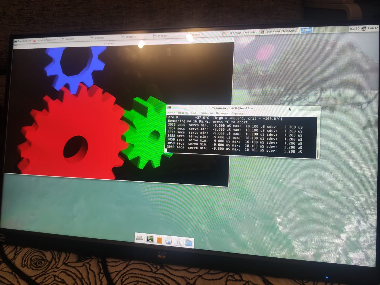

17 Oct 2020 18:39 #186419
by M1g13
Replied by M1g13 on topic Results of latency test, list of computers tested for use with LinuxCNC
LinuxCNC pc tests, version 20200930, started 18.10.2020 00:29:08
General info:
Gigabyte Technology Co., Ltd., B460MD3H
Bios version F2, dated 04/13/2020
Chipset: Harddisk is non-rotational, ie. SSD
The amount of swap currently used is 0
CPU related data:
model name : Intel(R) Pentium(R) Gold G6400 CPU @ 4.00GHz
cpu cores : 1
stepping : 3
cache size : 4096 KB
RAM related data:
Maximum Capacity: 64 GB
Maximum Voltage: 1.2 V
Maximum Voltage: Unknown
Non-Volatile Size: None
Volatile Size: 4 GB
Cache Size: None
Logical Size: None
Size: No Module Installed
Volatile Size: None
Cache Size: None
Logical Size: None
Volatile Size: 4 GB
Cache Size: None
Logical Size: None
Volatile Size: None
Cache Size: None
Logical Size: None
GPU related data:
product: Advanced Micro Devices, Inc. [AMD/ATI]
configuration: driver=amdgpu latency=0
Parallel port related data:
number of parallel ports is 0
Os and desktop related data:
PRETTY_NAME="Debian GNU/Linux 10 (buster)"
Should the info below not match with your machine,
kindly post the output of pstree here, including a brief
desciption of your desktop environment, window manager and
display manager. Tia
https://forum.linuxcnc.org/18-computer/39370-script-for-automated-testing-of-computer-latency
Desktop environment : xfce4
Windowmanager : Xfwm4
Displaymanager : lightdm
Kernel related data:
Kernel 4.19.0-11-rt-amd64
GRUB_CMDLINE_LINUX_DEFAULT="quiet"
Cpu idle driver: none
Kernel modules data:
Check if pcspkr is loaded: No, which is good!
Check if snd modules are loaded: Yes, may cause bigger latency.
can probably be disabled in bios, alternatively, you can run
"./block-snd-modules"
which has just now been created for your convenience.
Keyboard & Mouse related data:
Number of mice: 2
Mouse 0 : ELMCU iPazzPort Mouse
Mouse 1 : Weida Hi-Tech CoolTouchR System
Mice attached to USB:
Keyboards attached to USB:
LinuxCNC related data:
LinuxCNC version is: 2.8.0
Preparing for latency test:
Started glxgears No. 1, 2, 3, 4, 5
Started firefox with 'https://vimeo.com/150574260', WID 46137347
Command for latency test is:
su bub32 -c "latency-histogram --nobase --sbinsize 1000 --nox 2>&1 | tee -a 1602970139.lat &"
Latency testing loop started Вс окт 18 00:29:20 MSK 2020,
should end after Вс окт 18 02:29:20 MSK 2020
Swap useage: prerun: 0, running: 0
CPU core temperatures:
Core 0: Tmin: 35.0°C, Tmax: 40.0°C, (high = +80.0°C, crit = +100.0°C)
last latency data is as follows:.
7202 secs servo min: -10.600 uS max: 12.500 uS sdev: 1.300 uS

17 Oct 2020 19:04 #186427
Replied by tommylight on topic Results of latency test, list of computers tested for use with LinuxCNC
That is a very good result, even for software stepping.
- seuchato
- Posts: 381
- Thank you received: 126
17 Oct 2020 22:04 #186437
by seuchato
I second tommylight, very good results indeed. There is one thing that I saw lately: randomly, the browser stopped playing videos. Thus load on the pc was low. Thus: Was your browser constantly playing videos? If not sure, repeat the test and check from time to time.

18 Oct 2020 01:21 #186441
by BeagleBrainz
Replied by BeagleBrainz on topic Results of latency test, list of computers tested for use with LinuxCNC
Sounds like a good M\B CPU combo to recommend for a new system. Even for software stepping.

18 Oct 2020 05:39 #186448
by M1g13
The following user(s) said Thank You: seuchato
- Posts: 22036
- Thank you received: 7504
18 Oct 2020 05:54 #186449
It is a quite old single core Pentium processor.
- BeagleBrainz
- Visitor
18 Oct 2020 06:01 #186451
by BeagleBrainz
I thought it was this
ark.intel.com/content/www/us/en/ark/prod...-cache-4-00-ghz.html
M\B is a socket 1200
- M1g13
- Posts: 5
- Thank you received: 5
18 Oct 2020 06:13 #186454
by M1g13
the processor was released this year, it is dual-core (I disabled one)
this is it
this is it
The following user(s) said Thank You: seuchato, tommylight
- Posts: 22036
18 Oct 2020 06:15 #186455
Single core at 4 GHz should have raised an alarm, but i guess my alarms are off today !
