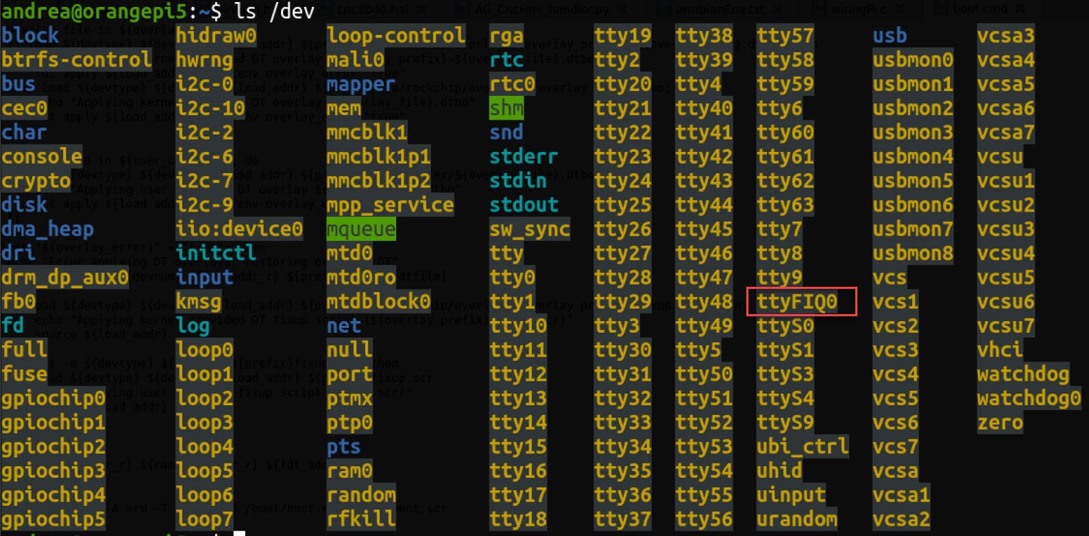

- Guglielmi
- Posts: 78
- Thank you received: 17
16 May 2023 22:13 #271475
by Guglielmi
Replied by Guglielmi on topic Can the OPI5 be Configured to Run LCNC?
No way..
it stop during boot after logo showing "(initramfs)".
Do you have "console=display" into ArmbianEnv.txt?
I tried with or without but nothing.
I replaced with your dtb but it has the same behavior.
I build the dts as other and placed in overlay folder.
Can you post your ArmbianEnv.txt please?
Then I give up.. I will use the uart0, pins should be enough.
Thanks a lot for your really precious support.

- Guglielmi
- Posts: 78
17 May 2023 18:11 #271556
by Guglielmi
I did several tests with different combinations also my side because in my case the OPI5 will be used exclusively for the CNC so I tried to give to LinuxCNC the max power I can. Adding the core 2 initially seemed better, the base-thread staid around 2,5-3us! and little bit worst the motion-thread, 1,6us instead with just 5,7 that I see 4-6us in base-thread and 1us in motion-thread.
I was looking for improving base-thread where steps are generated.
At the end performing more tests, I saw increasing up to 4-5us also with core 2.. so.. I planned to re-evaluate the core selection once the controller is driving the CNC checking for pulses with oscilloscope.
For the moment I leave also the core 2.
I know that OPI5 it has 8 cores, 4 A55 up to 1,8Ghz and 4 A76 up to 2.4GHz.. but which are the A76?? I think 4 to 8 because isolating first cores the latency is really worst but I'm not able to find this spec.
I also searched for overclocking it but I did not found any good info about.. Unfortunately OPI5 is not so popular yet..
About serial, no way also with your ArmbianEnv, really similar than mine at the end.
I found that an issue like which I'm facing could happen if I have configured some devices that use same hardware resources.
Could be the cause?
For curiosity, could me post the list of your dev folder? Then I promise, I give up, no problem.
Could be the cause?

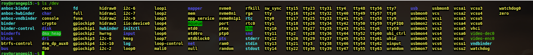

- royka
- Posts: 383
- Thank you received: 135
17 May 2023 22:08 #271572
by royka
Replied by royka on topic Can the OPI5 be Configured to Run LCNC?
Yes cpu 0-3 A55 and cpu 4-7 A76.
4x A55 and 2x2 A76
Not sure if core 5,7 are a pair or 6,7.
To "overclock" the A76 to 2.4ghz is just simply enabling the overlay. The original filename is "rockchip-rk3588-opp-oc-24ghz.dtbo".
If you tell me which devices you've configured that might use the same resources I could try that.
4x A55 and 2x2 A76
