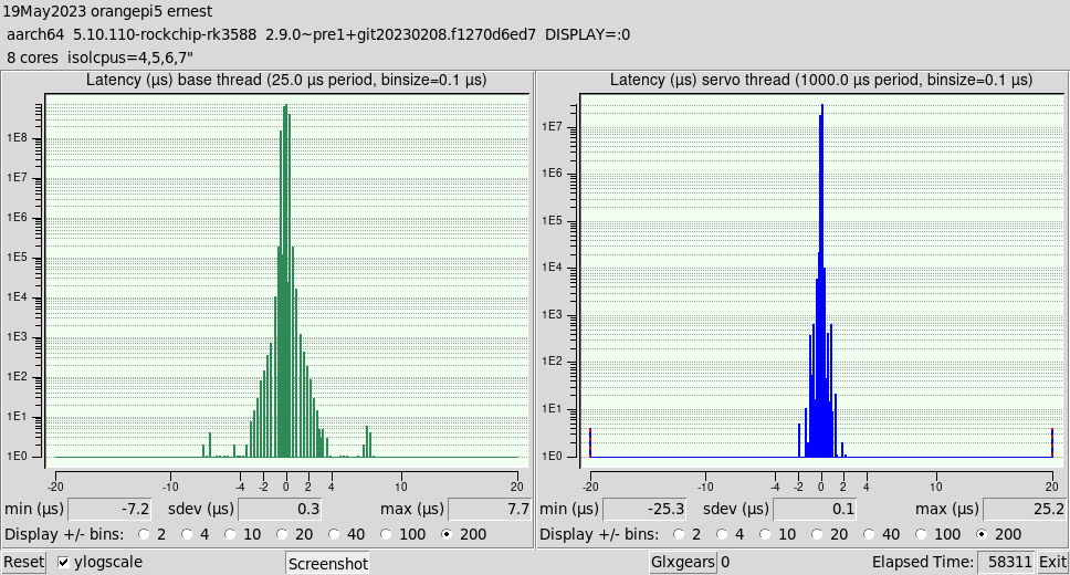

Since the switch is a no-go, I'm going to spend the extra $100 for the 7C81.
I ran the histogram overnight. Six glxgears, htop in a terminal, and youtube playing. For a while, I sat there opening and closing programs, and generally trying to create havoc. I like the result of Guglielmi's settings. isolcpus=4,5,6,7

That looks like a nice board for the OPI. Personally I wouldn't isolate all the big cores when you're going to use a hw step gen. isolcpus=5,7 is more than good enough and probably will give a better use experience.
I wonder where the spikes in your histogram are coming from. No (sufficient) cooling or did it run out of ram or something? Because you did see more latency while dragging windows, did you install the Mali Wayland driver and install a wayland desktop environment? (But don't install the Panfork driver, that one doesn't work with LinuxCNC).
You could see if it's throttling with "armbianmonitor -m" the C state.
You can post the interrupts after the spikes show up if you want "cat /proc/interrupts".
With a hw stepgen you don't need a base thread, you could run "latency-histogram --nobase", sometimes this makes a difference.

Very impressive numbers indeed Guglielmi with all the big cores isolated, this should give a very good performance with the software stepgen.

It most certainly could have been a cooling issue that caused the spikes. I left it, a bare board, running overnight, and they were there when I looked in the morning. I ordered heatsinks along with the m2 disk.
As for the user experience, even with the six glxgears and video running, it was still usable. Slow and jerky, yes. But, still usable.
I'll wait on the hardware before running more tests. For now, moving over to putting the electronics enclosure together.

That will most likely have been the case indeed, I did a test without any cores isolated for 2 hrs while running glxgears and running Firefox together with Chromium and still had a max latency of 30us, so that's probably how I'll run it.
I've tested 2 heat sinks, the black one covering the whole OPI and the so called Ice Tower.
The black one with 2 cores isolated and no fan it stayed cool enough with a room temp of 20 C. Without any cores isolated it'll throttle after a few minutes 100% cpu use. The cooling fan delivered with it didn't make a noticeable difference. A cooling fan in the electronics enclosure will probably be sufficient.
The RGB fan that comes with the Ice Tower I didn't test, but with a pwm fan configured to turn on at 60c, it barely turns on without any cores isolated and normal use.
Replied by royka on topic Can the OPI5 be Configured to Run LCNC?
