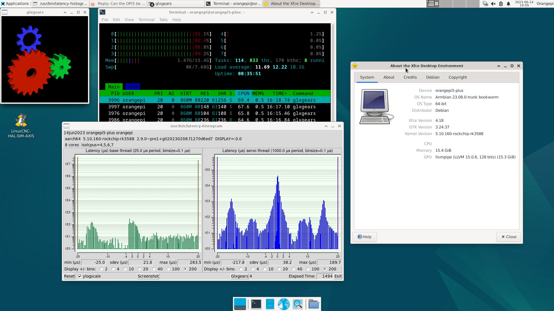

OPi5 Plus,
I built a bookwork server image, EDGE isn't an option only LEGACY. It booted up without and problems.
I then did this
upon reboot I xfce was working so I then did
added this line to isolate cpus
then installed linuxcnc with
but the jitter is horrible.
see attached screenshot
I then did this
sudo apt update && sudo apt upgradesudo apt install tasksel -ysudo tasksel install xfce-desktopsudo rebootupon reboot I xfce was working so I then did
sudo nano /boot/armbianEnv.txtadded this line to isolate cpus
extraargs=isolcpus=4,5,6,7then installed linuxcnc with
sudo apt-get install linuxcnc-uspace linuxcnc-uspace-dev mesaflashbut the jitter is horrible.
Last edit: 15 Jun 2023 02:19 by buzzFab.
- pippin88
- Posts: 263
- Thank you received: 51
15 Jun 2023 02:18 #273569
by pippin88
Replied by pippin88 on topic Can the OPI5 be Configured to Run LCNC?
Is it really Realtime kernel?
- Posts: 12158
- Thank you received: 4150
15 Jun 2023 02:26 #273570
Replied by rodw on topic Can the OPI5 be Configured to Run LCNC?
I don't think so. MAybe somebody with more armbian experience might know. sudo apt install linux-image-rt-arm64 (If I typed that right)
Installs the RT kernel but it does not boot into it. Perhpas there are some ARM specific steps to follow.
Otherwise when you build hte kernel you need to select preempt_rt and patch it
