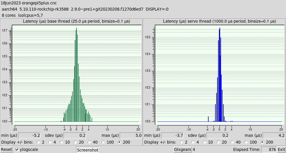

@buzzFab Here is a working image:
mega.nz/folder/78Z3UbRD#Pl8DdWmxLF3CDma21An8gQ
The only thing I noticed was that it gave an error about owner rights of the user folder, but this could've been due to that I pushed the reset button by accident after the first boot.
To fix this: sudo chown -R username:username /home/username
The latency was a bit higher as usual, about 12 uS, but probably because of no cooling, the same kernel on the opi5 performed good.
For this kernel I did a bit of a different approach, made a patch out of the difference of the rt53 branch and the normal branch till the same date and applied that patch to the kernel of xunlong.
Actually hoped that I could apply the patch to the more updated kernel of Armbian or Joshua Riek (5.10.160) but that didn't work. But this kernel is more up to date than the patched rt-kernel

18 Jun 2023 07:04 #273770
by royka
Replied by royka on topic Can the OPI5 be Configured to Run LCNC?
Here is the new config, this one could be used for the OPi5 and OPi5+
The kernel source has changed to:
github.com/orangepi-xunlong/linux-orange...range-pi-5.10-rk3588
The patch is a much cleaner single file, just the rt-patches. This patch should be the only file in the destination directory
The following user(s) said Thank You: buzzFab

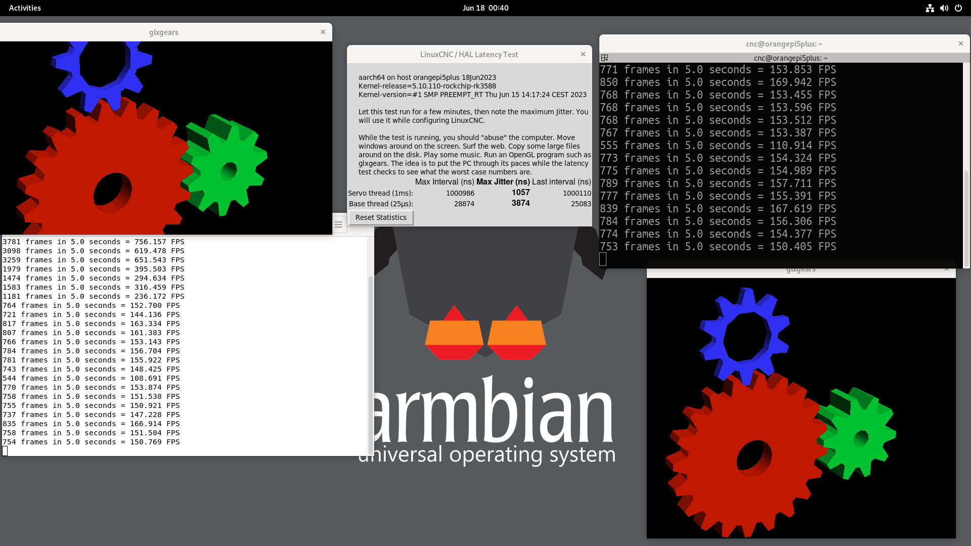

18 Jun 2023 07:35 - 18 Jun 2023 07:42 #273771
by buzzFab
Replied by buzzFab on topic Can the OPI5 be Configured to Run LCNC?
Last edit: 18 Jun 2023 07:42 by buzzFab. Reason: screenshot
The following user(s) said Thank You: royka
